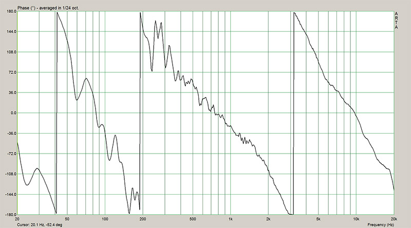

As I mentioned before, I have done some measurements in a reverberant environment to illustrate why imo group delay is not useful. First the phase plot:

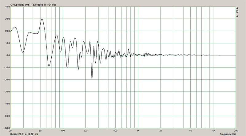

Which translates in the following plot for group delay
As you can see, it gets negative. It also clearly shows how the measurement gets distorted because 1 Hz is treated the same everywhere on the scale. Looking only at group delay, an 8th order filter at 1200 Hz would look better than a 2nd order filter at 80 Hz. This is clearly not in line with experimental results.
I find it a bit unfortunate that much of the research done by Blauert and others use group delay to determine audibility of what are essentially phase shifts. It makes their results so much more difficult to translate into what is relevant for engineering loudspeakers.

But the GD only turns negative because the phase shift turns back in some places. Isnt this just due to measurement or math ripple?

Correct Jan, it is the reverberant environment which causes these wriggles. I show it to illustrate that group delay is just a phony measure. Between 50 and 65 Hz, the group delay changes from +30 to -10 ms.
In the real world, there absolutely is no 40 ms difference in measurable delay between these two frequencies. If anybody can tell me what is indicated by these group delay milliseconds, I will eat my hat and be your BFF.

Actually, phase plot is first derived from impulse response. GD is then calculated on the basis of the phase plot. There is no information provided by GD which is not in the phase plot already.
But the presentation is worse, it is just as unwieldy as a phase plot on linear paper would be.
Yes, working with phase plot is more direct when aligning drivers. When window is chosen for analysis, looking at GD with negative values reveal that window is too long and includes reflections.

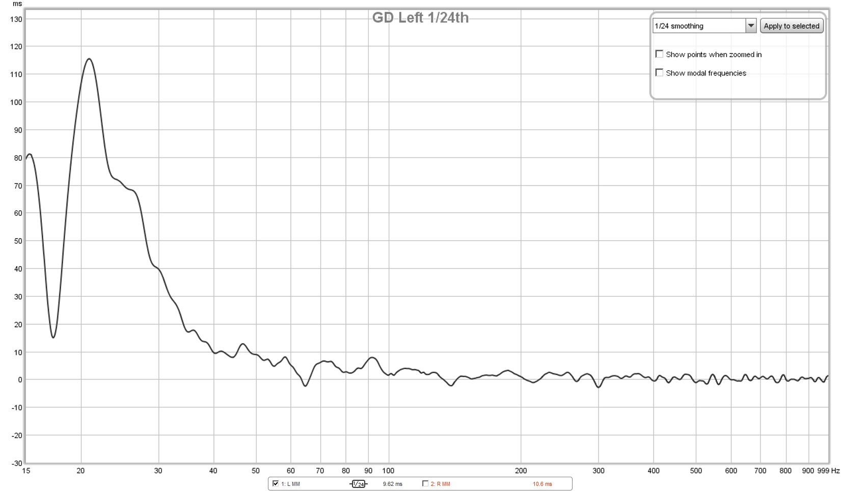

(Measured at the LP)
Here is my 1/24th GD. I dont have all those huge time wiggles like yours. It did take a lot of work with PEQ filters to get the wiggles out though.
Is it possible that your fluctuations are room reflections? Not a shortcoming of the GD measurement?
Exactly. PEQ filters matched to room modes for listening position mitigate GD observed at listening position for the corrected frequencies, but making direct sound of speakers far from flat.

You are correct, I used a bad measurement, but not an impossible one. In this case the cause was indeed room reflections, but you might also encounter loudspeakers something like this. I just used a bad measurement to make the following point: group delay says nothing about the arrival time of frequency components vis a vis each other. It can go from very large positive to pretty negative in a 15 Hz span. The milliseconds group delay is denoted in is not something that directly relates to reality, it is a mathematical construct, literally a derivative.
The only use for it is if you are interested in the rate of change of the phase at a certain frequency, but even there it is flawed for audio, because it uses a linear scale where a log scale would have been appropriate.
In short, what I am trying to communicate is that for designing speakers, the use of group delay as a concept can only lead to confusion and wrong conclusions. You can get more insight by looking at the impulse and phase plots.

You do realize that in my case, and the threads case, I am not measuring the loudspeaker per say, but at the LP.
