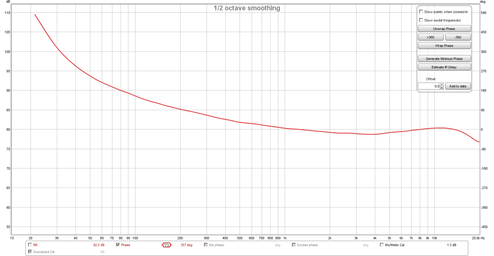

For understanding sake, what does it really mean to be +90 at 200hz, or +360 degrees at 32hz?
I guess no one bothered to answer this. You might have it figured out already.
If the phase is flat, at zero degrees it would mean all the frequencies arrive at the microphone without delay. So the phase rotation you are seeing, with a flat frequency response means 200 Hz arrives later than the frequencies before it.
It will even be later at 32 Hz due to more phase rotation measured.
Flat frequency plus flat phase could be considered time coherent. Look at my plot, gated 5 ms before first mayor reflections:
Measured at the listening spot, 3 meters away from the speaker.
I still need to work on the bottom end to get that into shape. That means fighting the room as well as the delays in the speaker itself.
You start with a speaker with crossovers that cause a certain amount of phase rotation. To get that phase plot flat would be do-able
by actively crossing the separate drivers with linear phase crossover filters. Each powered with their own amplifier. There are other ways
of coarse but it's never really simple without additional processing.
RePhase might get you there, mimicking the phase behavior of your crossovers and adjusting it to linear phase and that way giving you a flat phase response.
Your speakers behave excellent and so does your room. It might be worth a shot...

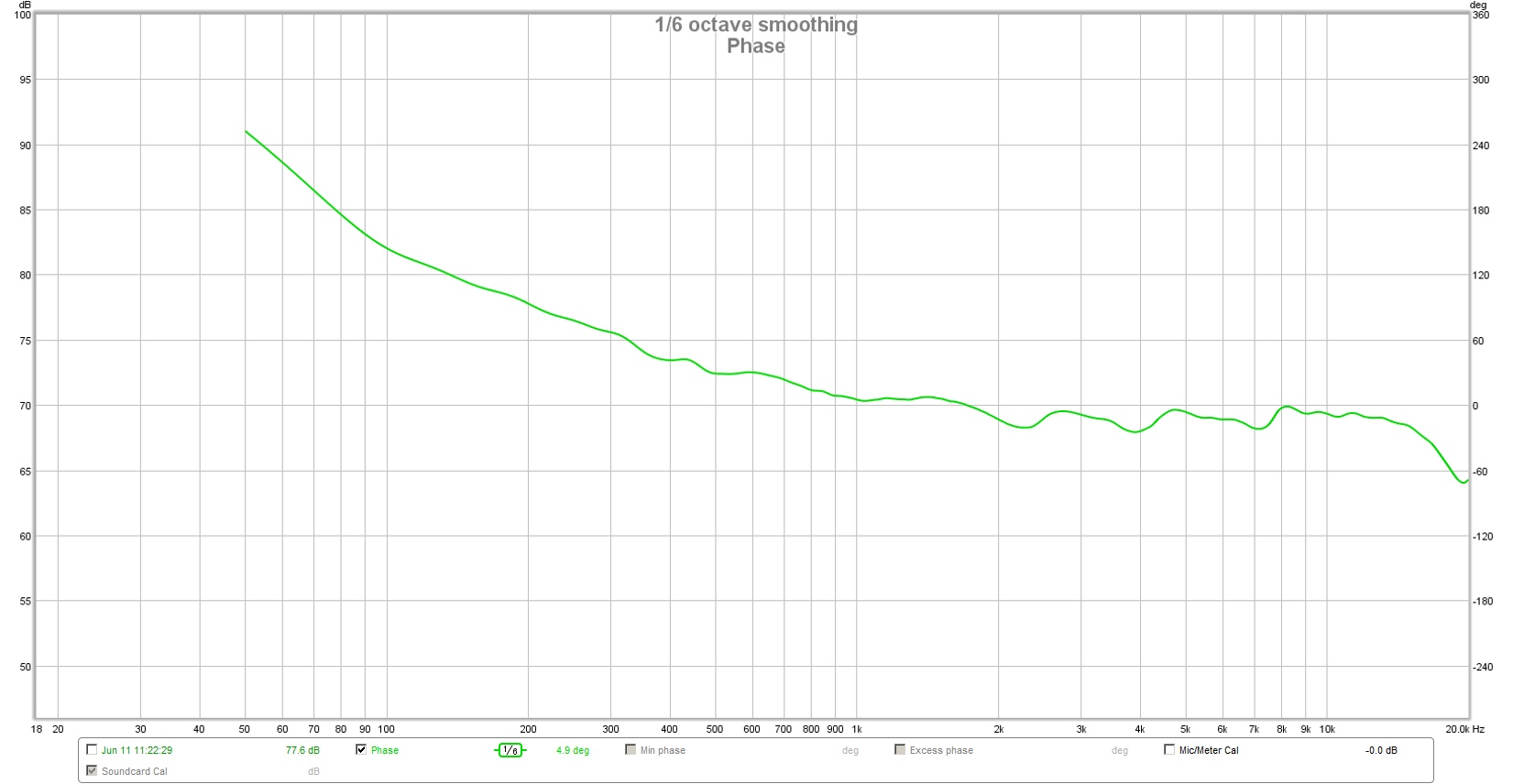

I understand phase relates to time. What I am trying to understand better is what the degree variation means in more absolute terms. In the graph shown are the phase plots of some different peoples mdat's that I have saved. Notice the scale (-2000 to +2000 degrees).
As you can see, most of these have more than a 4000 degree swing from top to bottom.
What I have noticed looking more closely at these different mdats is that all these except the green plot (mine) have significant mid and high frequency reflections. What seems to be happening is the phase plot averages in the reflection delays. So what your really seeing here is not the phase of the direct response of the speaker only, but rather some kind of hybrid phase response that includes the rooms delayed reflections.
So in order to have a flat phase as measured at the LP (ungated), one would have to remove all significant reflections?
I saw you that you gated your plot to 5ms to eliminate reflections. Thats kind of cheating isnt it?
That's not cheating for me... it is called dealing with the reality of a live living room 🙂.
You are absolutely correct in that observation, your plot of the left or right channel by itself shows phase wraps too if you don't gate before the kicker.
To get the phase of the speaker and nothing but the speaker would require access to an anechoic room. Your room comes close in the first few ms.
I want the early wave front to have good phase response. So looking at the gated response I can check it out. 5 ms is enough time to complete 50 cycles at 10 kHz but only 5 cycles at 1 kHz. So I adjust gating and browse trough the frequencies of interest.

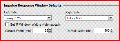

So, how do I need to set these windows to see it that way?
0=left 20=right ???
In your measurement in REW on the SPL and Phase tap, click on the IR windows button above it and adjust the "Right Window" length.
Left Window is what happens before the impulse, Right Window is what happens after the impulse.
If you want to see what the room is adding, well sort of... you could set Window Ref Time to 20 ms and Right Window to 500, Left Window to 0. That would kinda relate to the power response in your room (basically what happens after the first 20 ms).
It would still have the original bass though as the wave length there is more than 20 ms.
20 ms is about one cycle at 50 Hz.
I usually leave the left at 125, in my case with FIR filtering there is stuff happening there to influence the phase in total.
