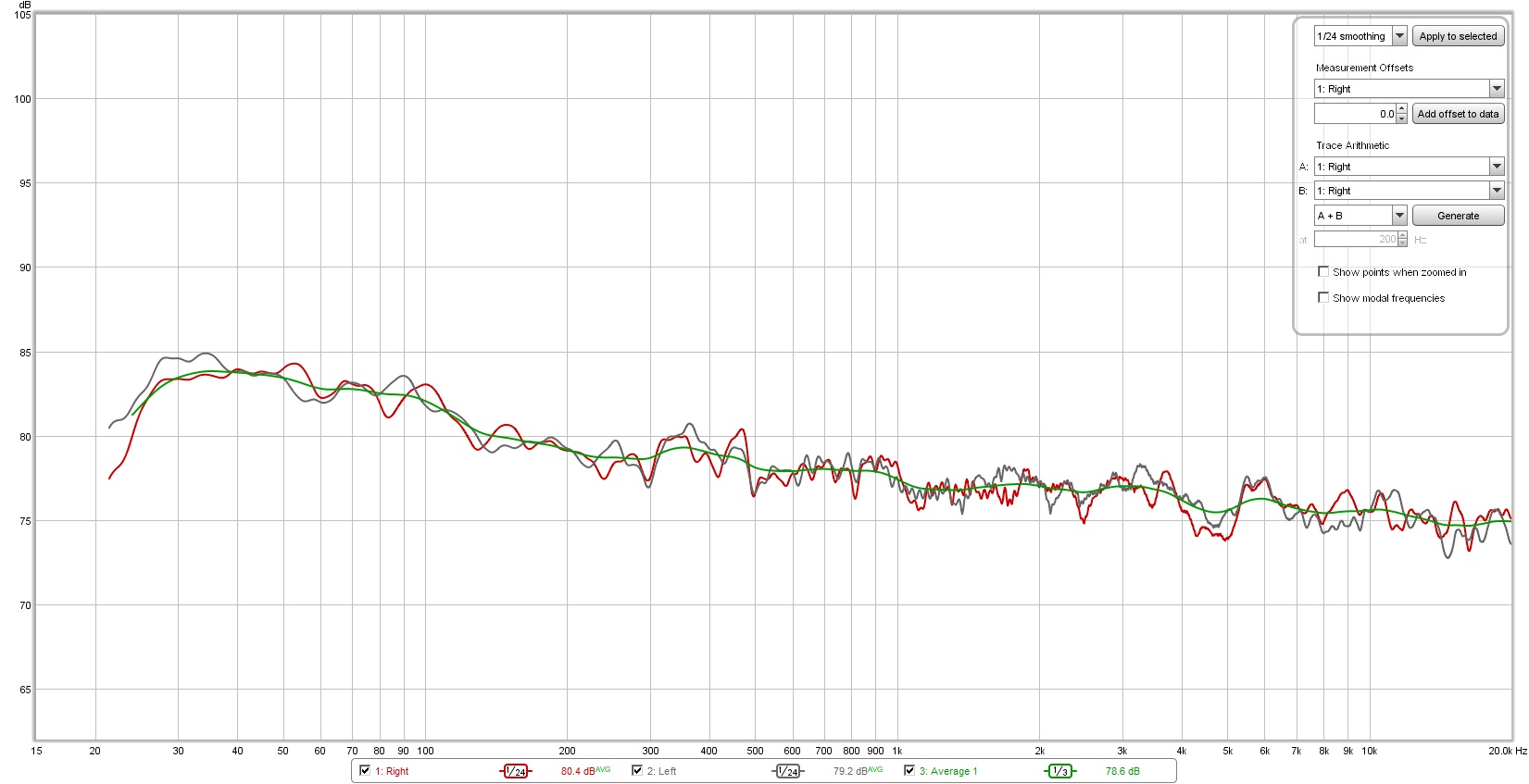

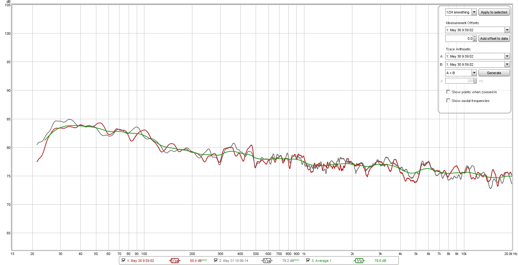

A bit off topic, but one of the things that DRC showed me was better image location clarity. It got me to thinking about what factors contribute most to great imaging in a fundamental way.
One of the things DRC did well was even the channel balance, and perhaps some of the phase miss matches.
Even timing and magnitude, one channel compared to the other, IMO, are two of the most important areas contributing to image clarity.
In looking at my previous phase and FR plots, I found some unevenness that I could fix acoustically, and with speaker XO tweeks.
Especially in the tweeter range, but some midrange as well, closer phase and magnitude responses did improve imaging audibly.
At 1/24th oct smoothing, most of my deviation is within 1db (250hz - 4K). A couple isolated areas up around 1.6db. The DRC 4 cycle version brings it all down to under 0.9db.
Channel Deviation (observed results)
--------------------- Average/Peak
DRC ------------------- 0.5/0.9db
Now (no DRC) --------- 1/1.6db
Before (no DRC) -------1.5/2.5db
