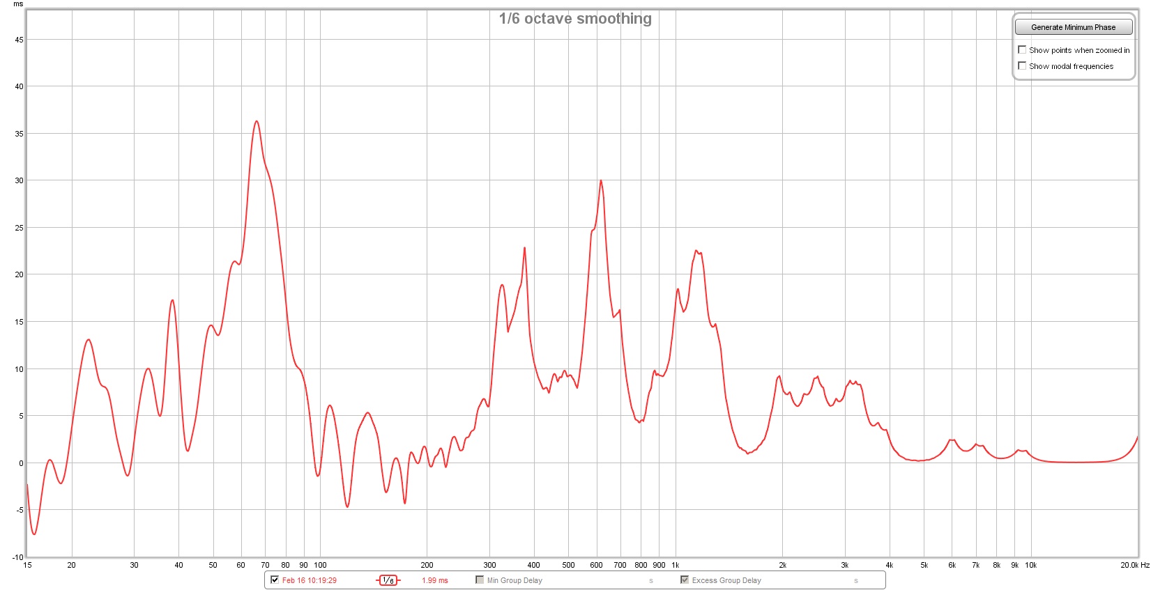

Case and point:
This is the GD of someone elses room. DRC could make a HUGE difference here.
Just an observation looking at the before and after graph. With DRC, the response is down 1 or 2 dB at 10 kHz which may be the cause of the decreased room ambience.
If you take a 2nd kick at it, my suggestion would be to tilt the target up by 1 dB at the high frequency end point so it gets closer to the 10 kHz you are listening to in the uncorrected response. Just saying based on experience, and of course there is no right or wrong 🙂

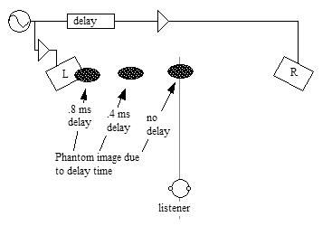

Along these lines, making sure the speakers energy arrives at the same time is equally important.
As can be seen here, even small (0.2ms) differences could shift things noticeably.
The window Greg uses on your REW measurement is a 4 cycle window. That's a very short window and at everything above say 1 KHz it would only correct the speaker, even in most rooms.
