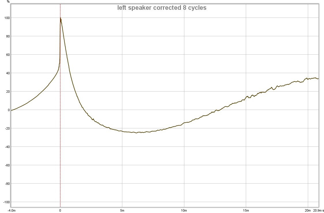

Could you show what an 8 cycle preset would to the STEP?
I see very positive things here, Jim does too. Just wondering what does what. We now have an almost anechoic room to play with, a luxury I don't have :D. just kidding on the anechoic part, Jim.
I guess the low freq pre-echo is starting to rear its head here. Maybe this is pushing things to far with the linear phase PL filter? Or maybe it won't be an issue?

I'd say this IS a problem. Still it doesn't look anything like the example shown in the documentation. I can't figure out why not...
It might be wise to back off the correction in the bass extension on this impulse from Jim. Maybe cut it off where it was in the original with 12 dB/oct below 28-30 Hz?
That might clear up what we saw down below in the waterfall. Most likely it wouldn't be exited in a convoluted song but still. It's a ported speaker you wouldn't want to boost there I think.

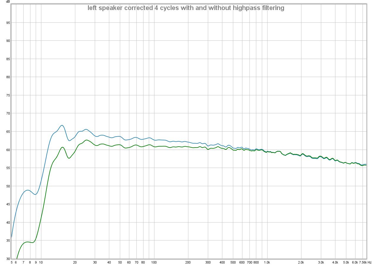

I think the 4 cycle window is enough at least to start with and perhaps enough altogether. Correct me if I'm mistaken, but it seems like GD will be 1/2 cycle or less down to at least 30hz or so.
Do you think the FR of the highpass filtered version in the attached graph will work for you? Would that be enough bass? I'm trying to avoid applying a steep filter to an already steep slope.

Go with the blue curve.
