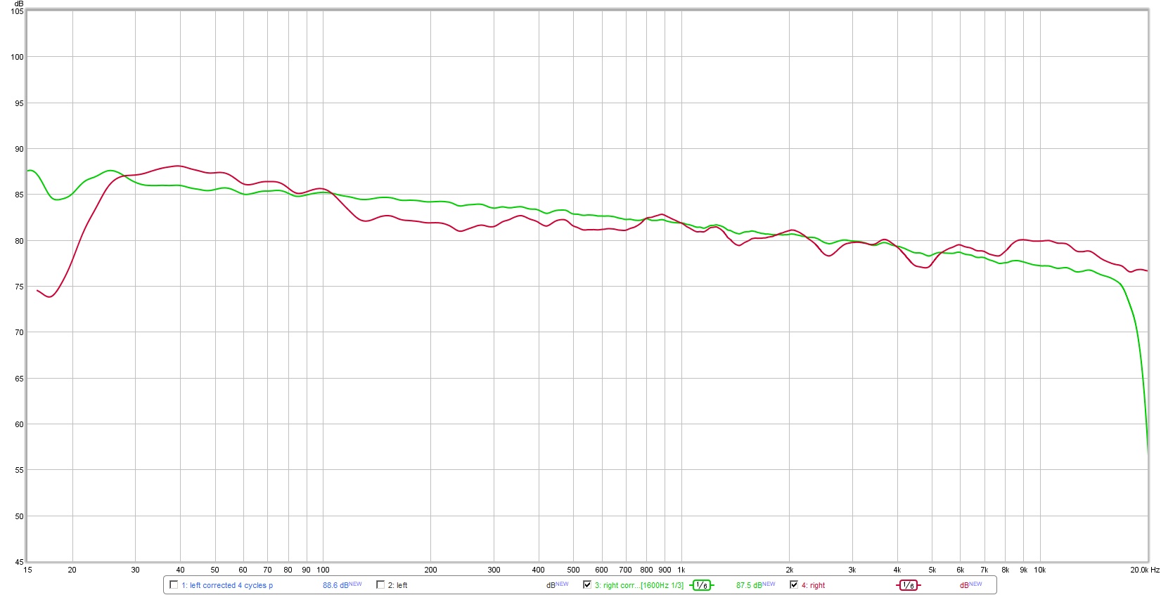

How do you get your SR to go flat to the right like its a DC servo? All SR's Inhave seen before start falling down in a triangular shape - even for reportedly excellent speakers.
By correcting the LF phase response. The speaker response doesn't go down to DC (speakers can't do that), but the energy that is there has had its phase equalized flat. Not "minimum phase" BTW, since the low end dropoff below 10Hz would normally cause a +phase response at LF in a min-phase system, but what is there is phase equalized as if gain were flat to DC. One of the things you can only really do with an FIR equalizer. The effect in the bass is to make it sound very unspeakerlike down low. Not louder or bassier, just not obviously from a speaker. (And don't forget that this response will be listener position dependent. A Double Bass Array might be able to get around that, too, but I don't have a room I can do that in...)
Hi X look the FR he is at 15Hz low extension closing in on being a DC source.
Yup. But if a strong 15Hz note were to come along, the output wouldn't be able to hold up since it's just a couple 12" sealed box woofers. Fortunately not many music signals actually do that.

I haven't listened yet, but have a question. How much latitude is there in selecting a FR curve? Can it deal with something thats not a strait line?
Complete control through DRC, or you could just apply a digital eq of your choice (outside of DRC) to a flat correction file.
edit: maybe you could do the initial listening through usb (in case there is something we could improve) before you start going through the hassle of burning cds...
Yes it can. You can shape it however you like with some work.
Do you have a target in mind? After trying different targets I ended up finding the straight line the most balanced in my room. With the ever so slight change around ~ 1500 Hz. Basically a gradual slope that's a bit above the straight line at 1500 Hz. About the same as a PEQ applied to a straight line with Frequency: 1500 Hz, gain 1.5 dB and q of 0.2. That tends to give a bit more depth to the stage.

1) I liked the EQ. This surprised me for I have grown accustomed to what it sounds like without the correction. I particularly liked what I heard below the vocal range. For illustration, the below graph represents the corrected (green) vs uncorrected (red) FR plotted together
The added warmth from 100hz -300hz or so was welcome. And by comparison, the uncorrected bottom (35-65hz or so) seemed a bit overly strong.

So all in all, not a bad first attempt! I'm glad to hear that. Some of the changes you heard might even be more correct than before, even if you did like the previous state of things.
A couple of thoughts on the depth issue. The FR has changed and that can change the perception of depth. See above where I said a gradual knee at ~1500 Hz can help with that.
Second: Greg did mention a change to the Haas Kicker. For making the correction it shouldn't be in the measured impulse. It will be there during playback again.
The ambience is a bummer though, you'd want to keep that. We'll have to find out why it was different.
