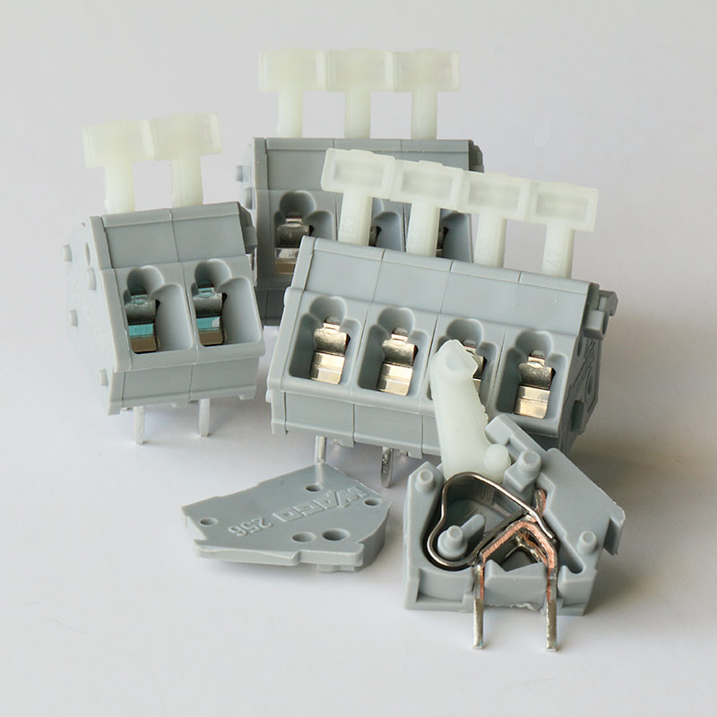

Hallo Per Anders
Just a hint regarding your SSR03 BOM.
Here in Germany it was very easy to get these WAGO modular PCB Terminal Block with pushbutton but nearly impossible to the 4 and 12 port versions. Perhaps you change the Block items to the modular ones?

You can built to any pole number. They are like LEGO.Hallo Per Anders

This is true. And they are easy to get.You can built to any pole number. They are like LEGO.
This is the reason why I mentioned to take these (0256-0401) into your BOM instead of the 0256-0405 and 0256-0405
