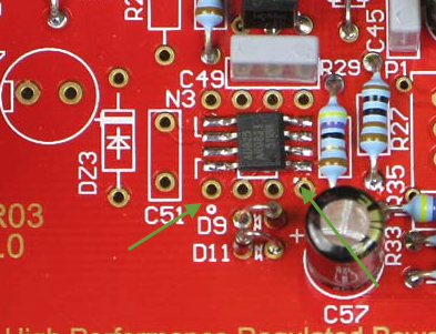

First thing I noticed the second LED lit also, but not that bright. sorry for that.
Second thing I noticed were two solder bridge. Maked within die picture. After removing these the second led was brighter. Is this possible?
I name the holes N1-1; N1-8 acording to the opamp leg near by.

For 15 volt you should only have one LED on each half. Do you really use the 15 V BOM?
Pin 7 is interesting (not pin 5). What is the voltage on this pin?
What is the voltage across the LM329?
Are both halves behaving the same?

If the voltage on pin 2 and 3 on the opamp is the same with a few millivolts, then the regulator works properly. A small remarks about your soldering joins, warm more and let the tin float through the hole. Right now it's too much tin and not heated up enough. Otherwise, good work. Don't forget to solder the heatsinks.
Pin 2+3 are the same
but they are different on the "+" and "-" side of the pcb
is this OK?
at the soldering joins I will work again.
at the end of the day it seams so that I managed to finish my first real DIY soldering ;-)
Thank your for your support and patient with me.
Please notice the pin 1 marks on the opamp. That is the important thing. Anyway, if you have a very stable output voltage when you load the outputs, then it works.
