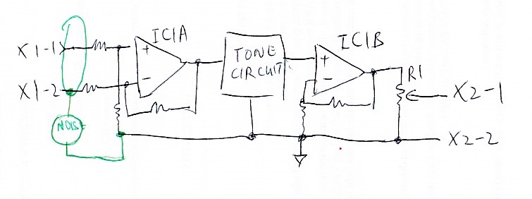

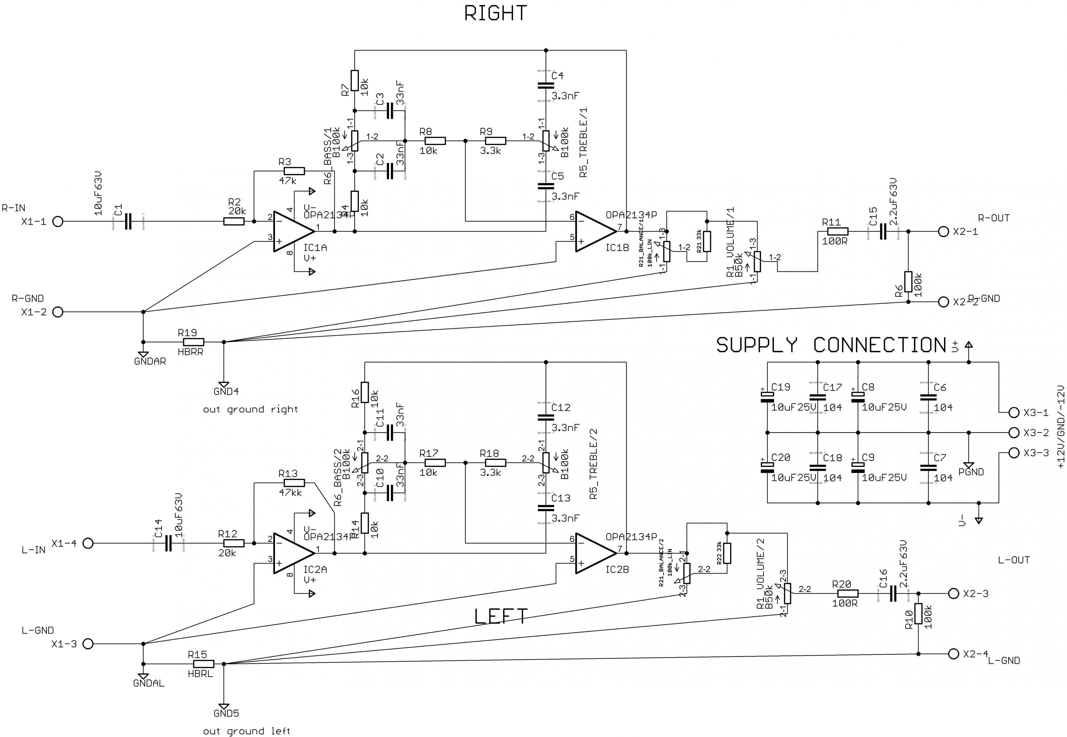

But look at post #82. I assume that is the preamp where R-GND at X1-2 is the source ground from the source. Let's look at what if you inject a 1.5V 60Hz noise source just like you injected into my design. This will be common mode that will be in R-IN at X1-1 because the signal from the source is REFERENCED to the source ground. So the 1.5V noise is on both X1-1 and X1-2. There is no other way around this. Now just look at what happens.
The +ve input of IC1A and IC1B are all referenced to the R-GND at X1-2 which is good. This is what I would do. The output of IC1B should have NO NOISE REFERENCED TO X1-2 R-GND. BUT the volume potentiometer R1 has the bottom tied to the PREAMP GND referenced to GND4 to X2-2. I assume this is the preamp ground. This is the ground that you put the noise source between X1-2 and X2-2.
This is where the problem starts. You have the output of the IC1B referenced to X1-2, but the volume pot ground is referenced to GND4. This will cause a 1.5V 60Hz noise at the output of IC1B referenced to the GND4 and X2-2 ground.
You see where the problem is, at least my design without even doing anything will attenuate 38dB to 17mV at the output of the speaker terminal. You have 1.5V noise input to the power amp and to be amplified by the power amp. I don't care what you do to the ground inside the amp, the preamp in post #82 is going to have a big problem with your generator injecting noise between X1-2 and X2-2.

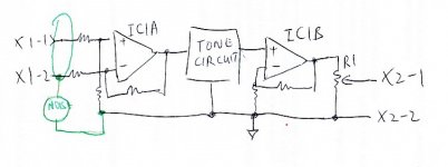

Noise is a system issue, not just grounding. The fact that you have separate modules in the system, you are going to have grounding problem, all the grounding in the world can only get down to a certain point. That's the reason people use DIFFERENTIAL transceivers for interfacing. What I am doing and what Cordell suggestion is only half way "pseudo differential" only. You want to nitpick to this point with a generator in between grounds, you need to go full differential receiver......which is absolutely possible. Just two more resistor.
The editing time has past, but this is what I would do if I have to deal with so much ground hum. See attached file. This is a simplified drawing of the preamp from post #82. I go full differential to get rid of the noise right at the input using full differential amp. The whole preamp pcb is going to be one ground only connected to X2-2. They use what I do on the interface between preamp and IPS/VAS. Keep it simple. The power rails for the preamp board are all referenced to X2-2, nothing to do with X1-2. The noise on X1-1 and X1-2 ENDED at the input of IC1A.
I include the noise generator like Mark suggested. But if you simulate, you have to induce the noise to X1-1 as this is from the source. Noise has to be common mode on both X1-1 and X1-2.
I would use a solid ground plane on this preamp board, forget all the star on the pcb, the more you mug around, the more trouble you have. Look at noise as a system issue, not just grounding.
