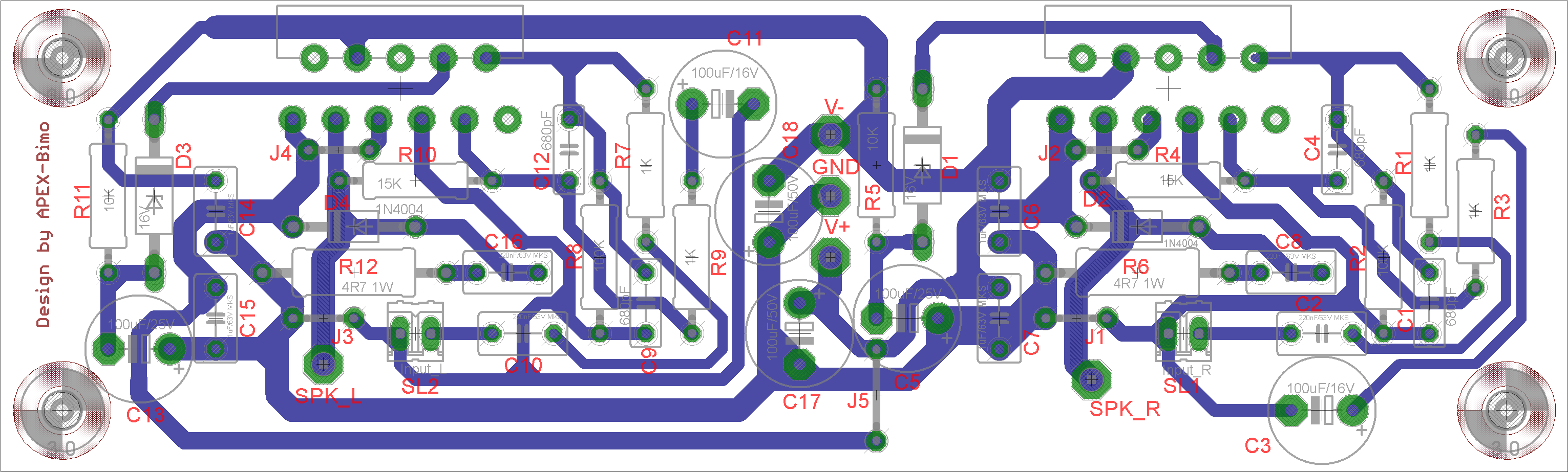

Hi Mark,
Here is the layout of example amplifier . It is designed by APEX and layout by Bimo. The resistors can be placed inplace of jumpers J3 and J1, which connect the signal ground to power ground. The example is just to understand the concept (the "D. Joffe" concept of HBRL and HBRR as given by Andrew) and can be applied to any circuit.
regards
Prasi
Replacing J1 and J3 with 1 Ohm resistors should work. You will have placed resistors between the three ground connections of the board.

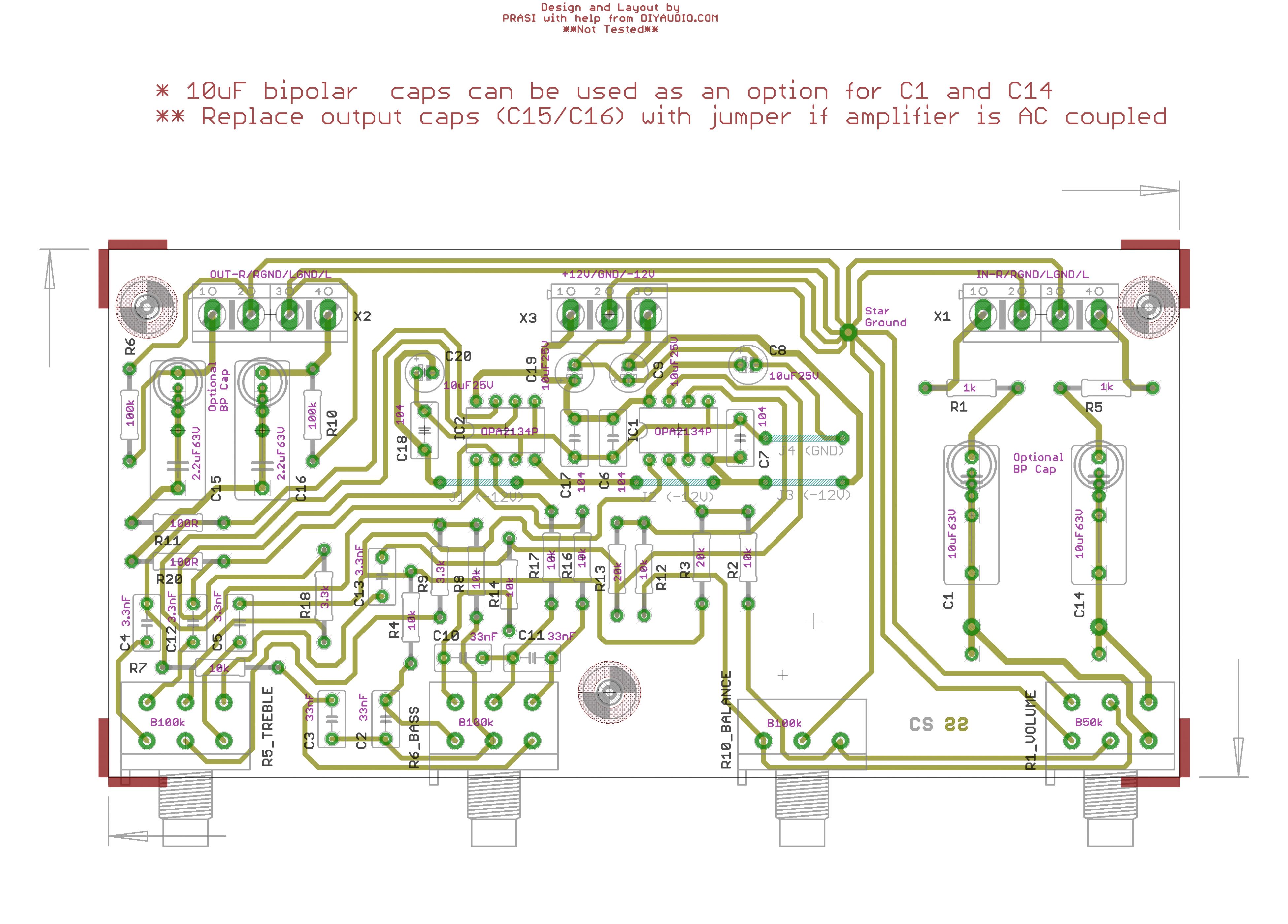

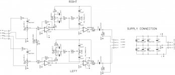

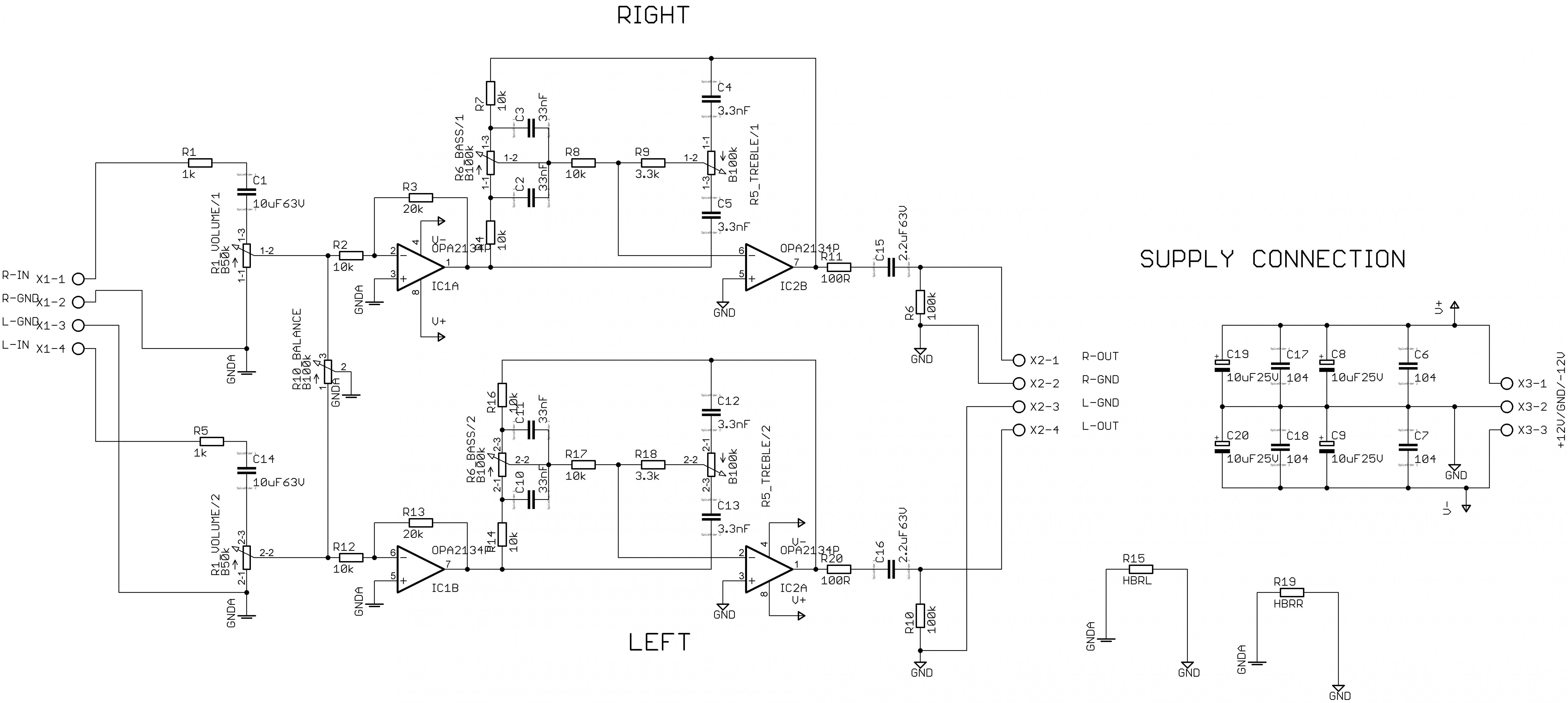

Thanks for the suggestion. Here is a version of pre-amp PCB along with schematic that I have made for a pre-amp tone control. I am not able to decide on exactly where to place the resistors. can you guide? The PCB is already made and thats when I started getting the hum...
Referring to the schematic , should HBR be placed between the grounds of audio schematic on left and supply schematic on the right?

Because your sch is using the general Gnd symbol it is difficult to identify the actual INPUT circuit and the actual POWER circuit.
Draw those two circuits on your PCB layout.
Check that the TWO circuits do not SHARE a common trace.
Then compare to your sch and find which trace links the Input Circuit to the Power Circuit and to the Output/Speaker Circuit.
It is this linking trace that creates the loop and needs the added resistor.
referring to the schematic, If I understand correctly, every ground on the right of IC1A and IC1B can be considered as speaker circuit and power circuit (as per Joffe terminology). Am I right in my interpretation?

I think you have that right.
Now draw out the circuits and see if they share any traces.
Then put in the in to out link/reference.

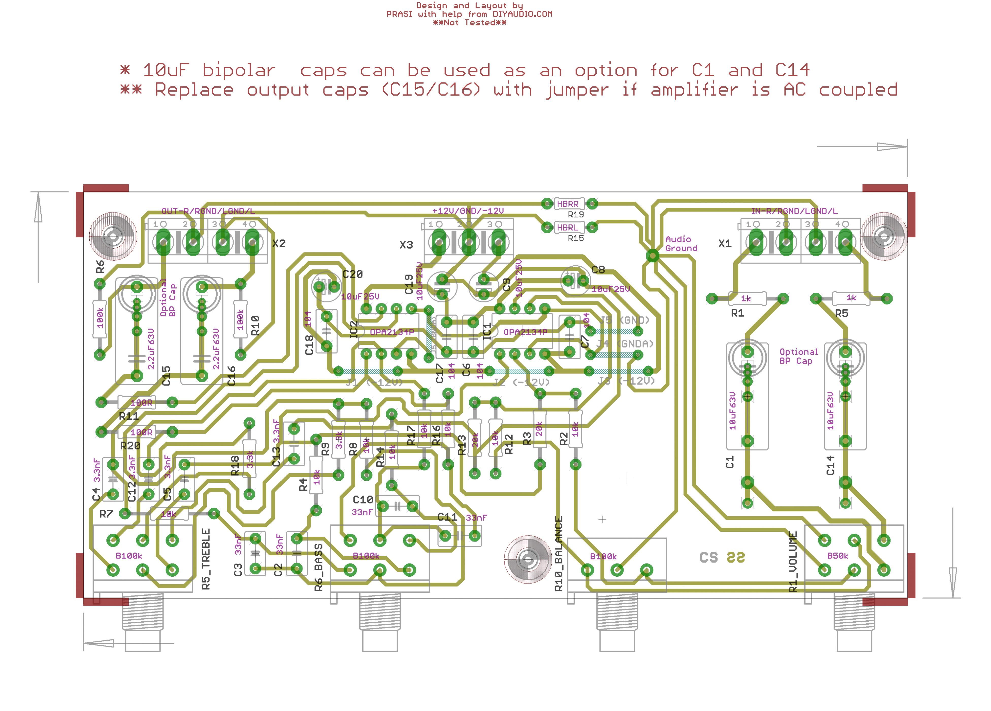

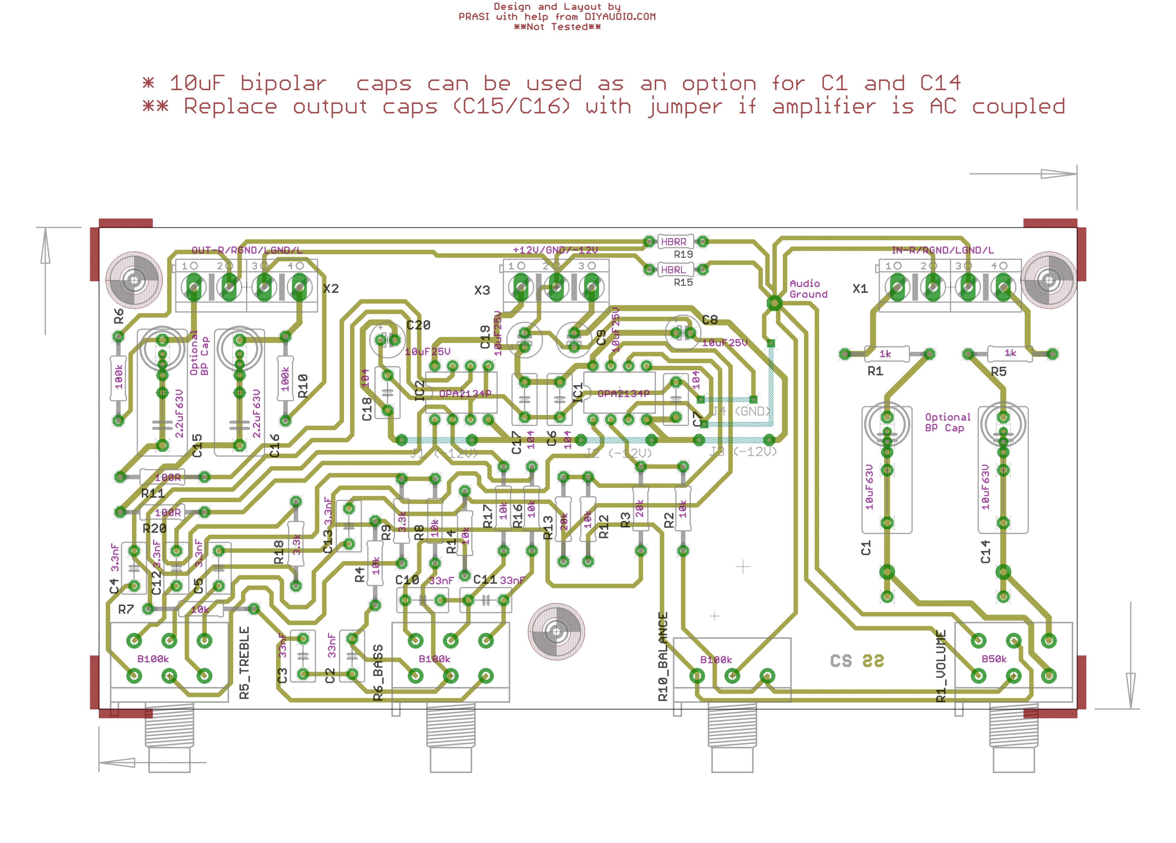

Ok here it goes. the schematic- GNDA is the audio return reference and GND is the speaker and power return reference. the board is also modified to to include the HBRL and HBRR in the trace between GNDA and GND.
One doubt, is it correct to join the traces for the output reference and the power reference at the power terminal (sort of output star ground)?

pins 3&5 of IC1 are connected to GNDA
pins 3&5 of IC2 are connected to GND.
That does not seem right to me.
I have never tried to build a tone control.
ok. Now pin 3 and 5 of both IC's connected to GNDA. How does an op-amp take reference for supply voltage? is it from pin 3 and 5? that's the big question. What about reference for audio if that's the case?😕😕😕

An opamp does not know (much) about ground. It simply tries to keep the + and - inputs at the same voltage.
Ok I did place HBRR and HBRL on amp alone and tested with sub x-over pre-amplifier that I have. Now there is no high frequency noise on speaker (which was present even when volume is muted). However when I increase the volume there is that AC hum which is volume dependent. Guess I will have to place a Ground loop breaker as Mark suggested.
