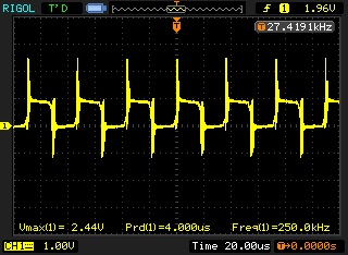

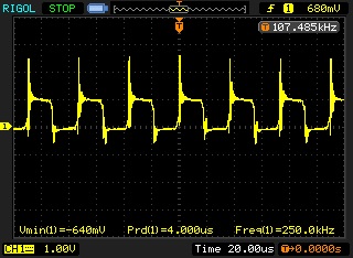

So i scoped it again.

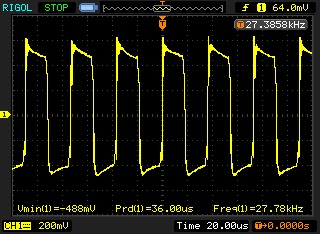

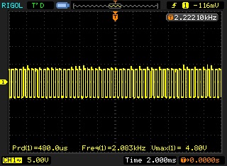

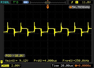

Scope settings: ground from the amplifier GND terminal, probe 1X
Gate measurements.
First picture from the banks which is closer to rectifiers, should be high side,
the second one is from the low-side.
Third picture is also low side, BUT vertical position of the scope is -10.0V

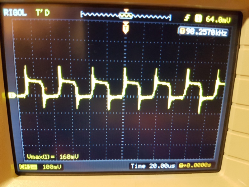

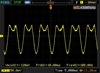

Here is what i have on driverboard input, its not cliped, because its driven to hard, its just whats comes in on board. From rca its clean signal.
Another thing. If i ground scope probe on secondary ground (speaker output minus terminal), i dont see any oscillation signal on gates from output transistors.

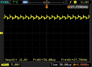

Second picture. About grounding source leg, transistors are not grounded yet, here is signal on all output transistors source legs (amplifier main ground terminal as reference)
Sorry that again i didnt mention grounding.
Picture before was grounded on secondary ground.
Here is the picture when probe is on amplifier main ground (the same input pin on drivercard). If i drive sinus signal in amp, i see that signal is oscillating in driven frequency.

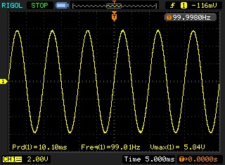

I started to rembember that before i removed rectifiers I tested and had good sine wave from pre-amp board.
Here what i have done:
Removed all output transistors. Reinstalled rectifiers.
And this is the input at driverboard (drivercard is removed), clean sinewave signal. I just removed outputs and reinstalled rectifiers.

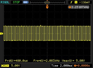

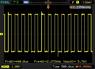

Edit. While outputs are out of board, i now tested the drive signal, low-side gate drive is the same as before, high side i didnt check, because i did not install the 9v battery for 21844.

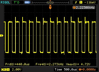

AC coupled. Scope ground on negative speaker terminal. high side with 9v battery.
First two pictures with 5V and 2ms settings, and last two with 2V and 500us.
1th and 3th is high side.
2th and 4th is low side.
