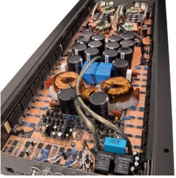

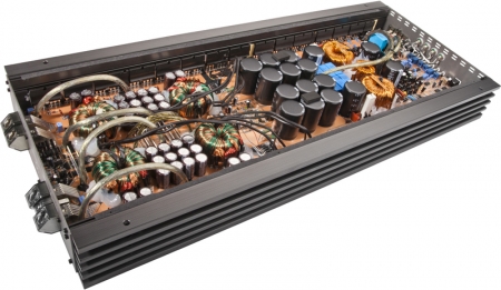

I have this amplifier and I am a bit lost.
It came in with blown outputs, their drivers. Outputs was IRFP460LC, their drivers was KTA1715 and KTC2814.
There was capacitor 1.2uf 250vac with broken, burned leads, replaced with 1.2uf 400Vdc. One lead of the output choke leads was desoldered from the main board, i think it cracked from vibrations and came off.

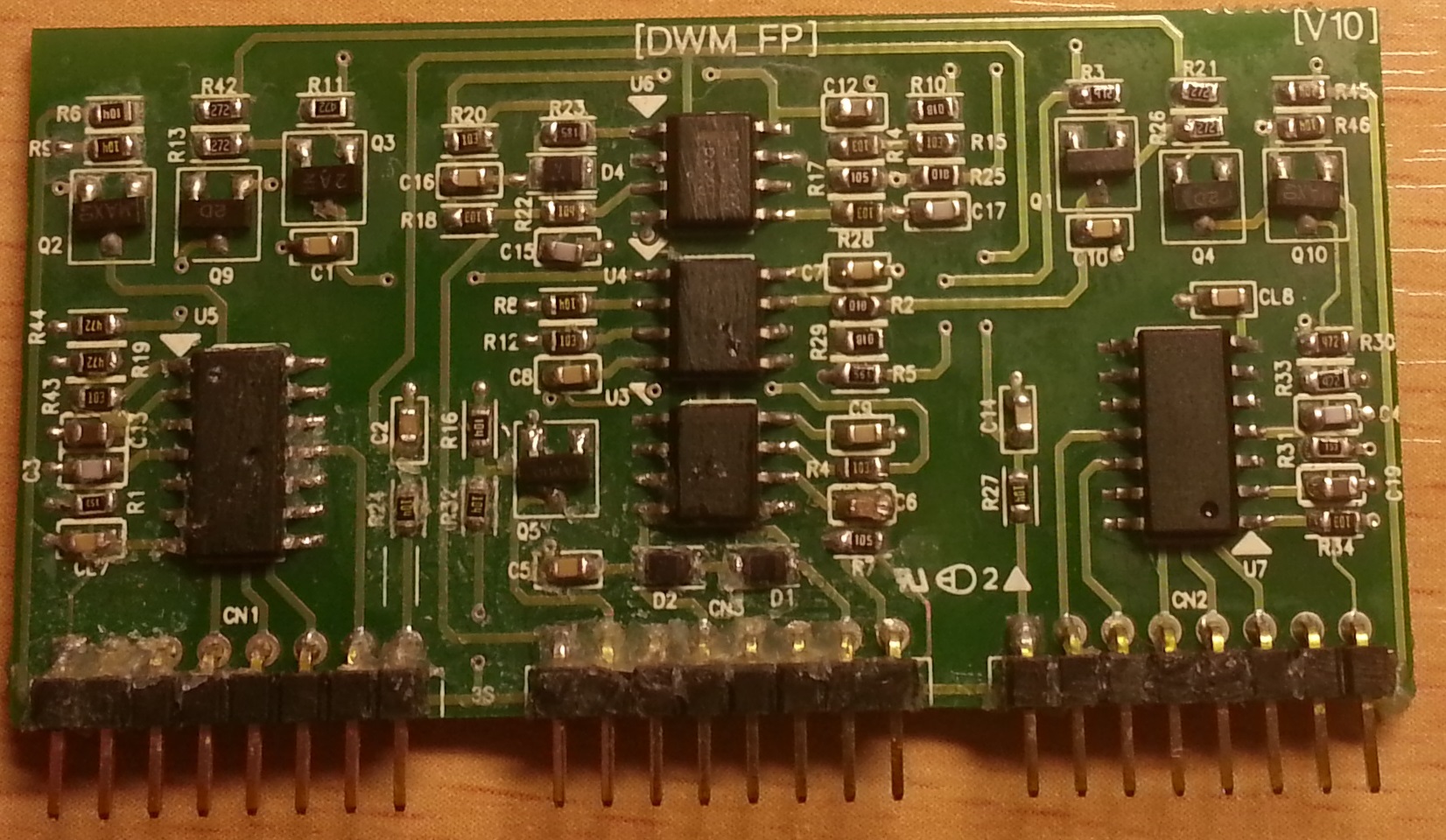

I had a great deal some time ago and I replaced outputs with IRFP360LC, gate resistors i left the same, drivers I replaced with BD140, BD139.
I replaced all IC's of the output driver board. All sot23 transistors on driver board tests fine.
The problem is that, when amp is powering up, relay turns on and off - goes in protection. I can confirm that, before protection there are DC on the output terminals.
When output driver board is pulled off, amplifiers powers on:
The power supply is working and I do get +/- rail voltages, I confirmed, that 5V,12V and 15V regulators are working. There are no DC voltage from preamp board.
Could be there still a problem in driver card or should i orderd original driver/outputs?
Sorry, i dont have right now photos with main board, i can photo it in monday.

It should be safe to short pin 2 to pin 5 to keep the driver off but let me try it on a smaller amp I have here before you try it.
That and adding a local feedback resistor to the TL072 should allow you to check everything up to the driver IC input. It will be a couple of hours before I get back to the shop to try it.

On a much smaller amp, I shorted pin 2 of the 21844 to the negative rail (pin 5). This was done by shorting across the small SMD capacitor that was in front of pin 2.
This completely shut the amp down. There was no DC on the output and the relay engaged.
The amp was driven with an 80hz signal. The output of the TL072 was distorted but good enough to drive the LM211. The output of the LM211 had a square wave that swung ±5v from ground. The signal appeared at the input of the 21844 as an 80hz square wave that swung from the negative rail to 12v above the negative rail. That confirmed that everything up to the IC was OK.
This should be usable on your amp as well but be aware that I've never tried this on any other amp.
Amp powered up with no DC on the outputs!
There is drive signal for the output fets but its noisy. Drove 100Hz signal, but one the input of the 21844 (pin1) was only negative voltage (didnt check exactly how much with scope).
Edit: i scoped the driver card and saw ~100hz square wave on the Q3 base.
I don't know what Q3 does on this board. On other boards, the output of the LM211 drives an emitter follower pair. From there the signal goes through a resistor to the emitter of transistors marked 2D. The collector drives the IC. The base is grounded.
If signal is OK on one IC, the emitter follower pair is likely OK and the problem is between the pair and the input of the IC.

I didnt have time, but I managed to do:
I rebuilded the output driver card, replaced all ICs, some of the transistors also.
Replaced output transistors and their drivers (bd139, bd140). Gate resistors all are within tolerance.
The situation is the same as before, there is DC on the output (i measured before relay) and it goes immediately in protect right after (!) relay engages. When measuring, the DC voltage, its falling to 0, but its not able to reach 0 before relay engages.
I disabled 21844 by bridging 2 and 5 pin. Checked all drive signals from tl072=>0211=>21844 and they are like Mr. Perry mentioned - so far so good.
But the problem still exist.
The original output drivers was KTA1715 and KTC2814, I replaced with BD140, BD139.
As Perry mentioned many times before, that BD140, BD139 may not work in output section for class D. Could it be, that the problem is drivers?
I dont know, that else can lead to DC spike which falls. I did check all components on output driver card and don't think that i miss some bad one.
I don't think the BD drivers were a problem in this amp. The originals were rated for less voltage and voltage is generally what causes drivers like the BD139/140 to fail in the output stage.
When you hear a click in an inductor or transistor, it's sometimes due to a spike in current flow through it.
Enable one driver IC at a time (having only one enabled at any time). Does the problem seem to be associated with one IC/drive circuit?
