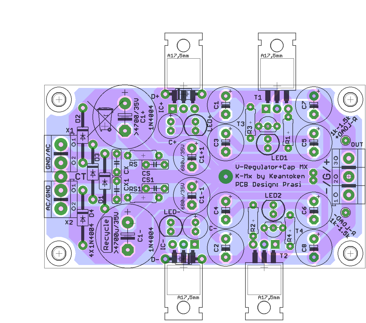

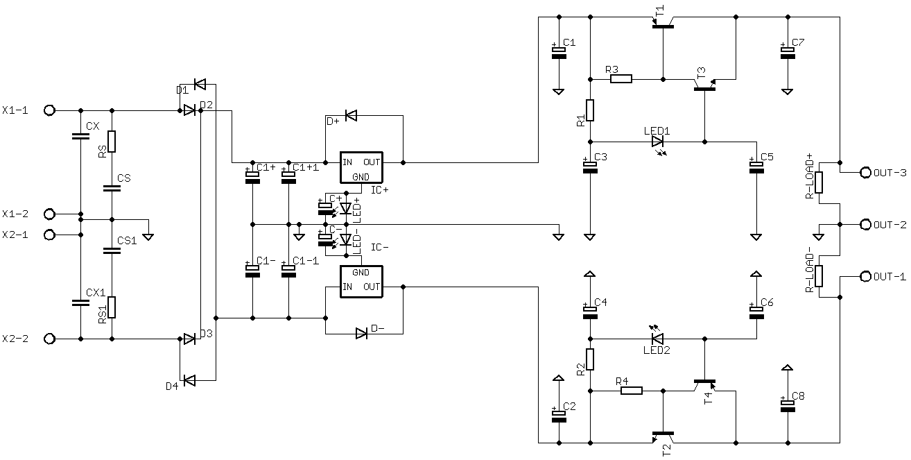

so how about this one? for a candidate?
Cap Mx by keantoken... The upstream regulator by someone else... wonder if its interesting enough..

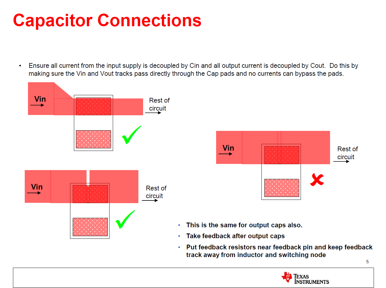

I think we have already touched upon the most basic and simple use of a ground plane (or perhaps shield would be more accurate).
This distills down to:
1: Good grounding and routing on upper layers. You are using a layout that is ALREADY good.
2: Ground plane at bottom layer, connected to the circuit at a single point (star ground usually) and nowhere else. Bottom layer so that component pins don't create vertical loops through the ground plane.
This is a good entry point because as far as I can tell, there is nothing to lose by this approach for most audio circuitry - the ground plane only carries self-induction currents and so cannot retransmit to another area of the board. Exceptions would include places where the ground plane creates too much stray capacitance to a node, but that is unlikely.
I can think of some additional things that might be an improvement. For instance, decoupling of board input grounds to the ground plane through a capacitor. In theory this allows EHF signals to skin across the ground plane and not get demodulated in the circuit. For this reason I have actually considered connecting the ground plane at signal input shield instead of star ground, to maximize EHF skinning.

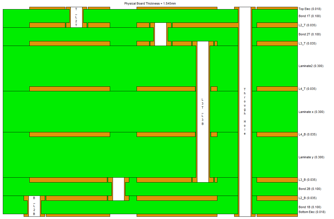

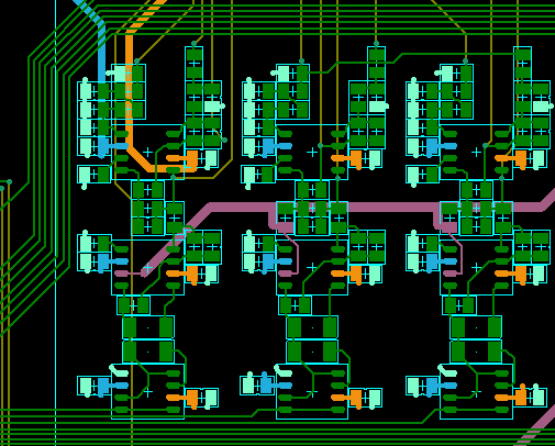

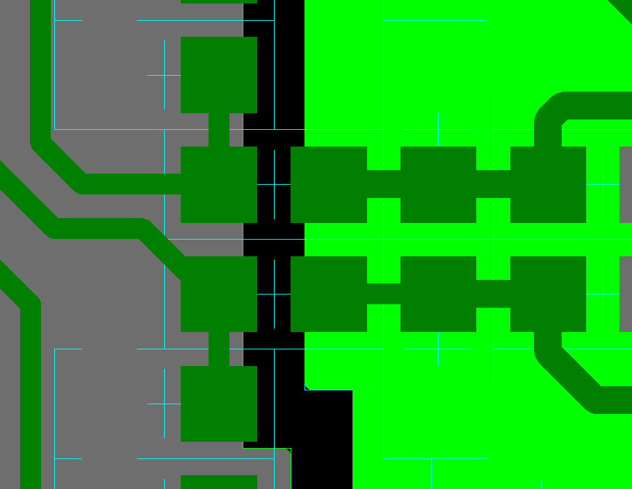

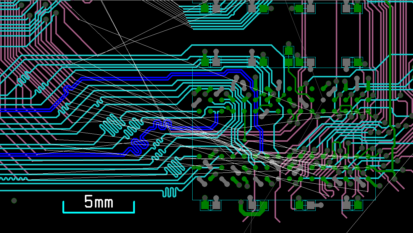

The first problem is what do you want a design off?
Here is a snap shot of a bit of analogue, a noise barrier, HF, and a snap shot through a layer stack for a HDI design so all the signal integrity stuff can be calculated.
Every design is different every design has solutions.
