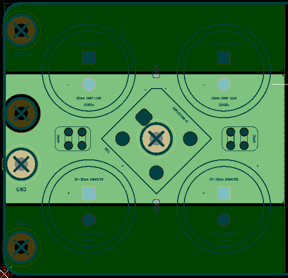

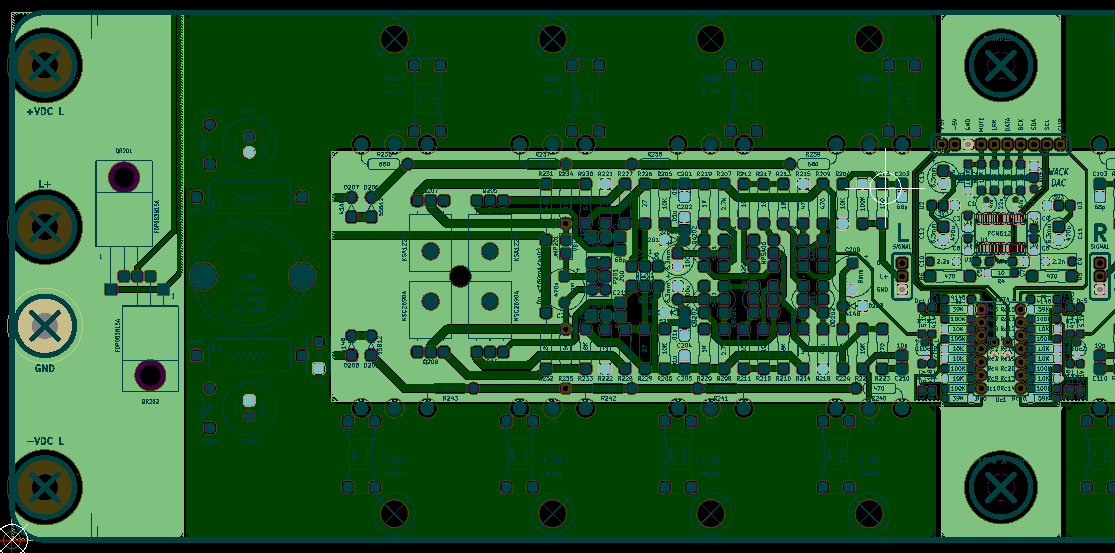

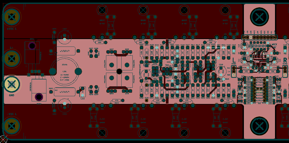

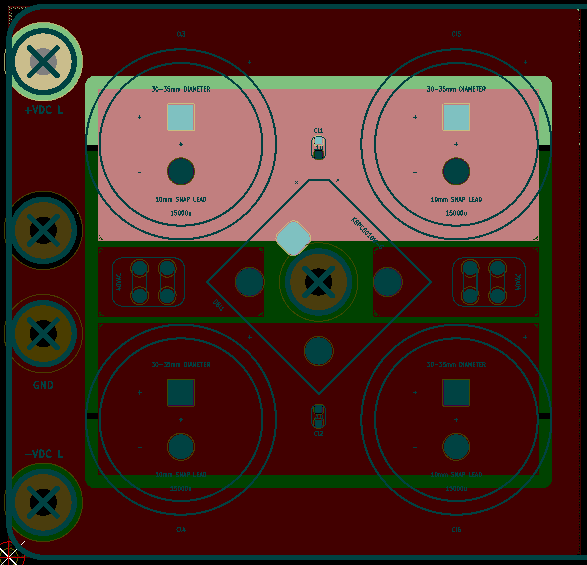

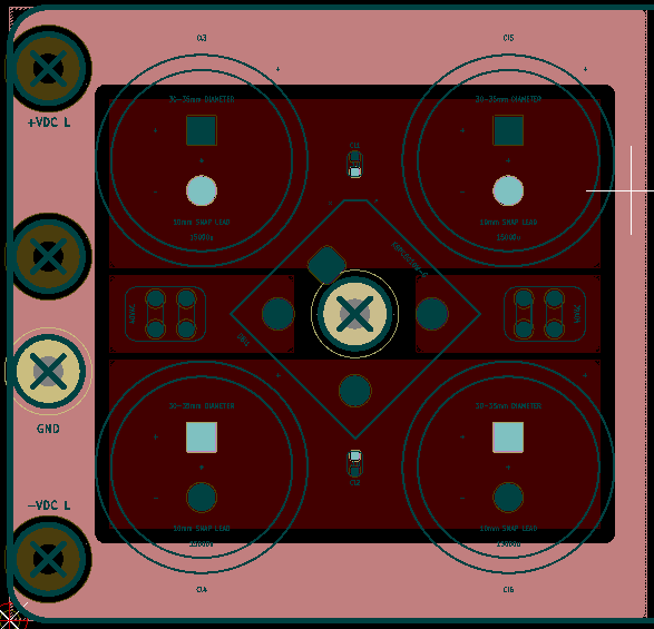

I use planes everywhere I can..
If I get pedantic, I create ground planes on both sides of a 2 sided and connect them with a fake part, or jumper, so that on the side with the greatest free space (usually the top since I try to run all traces on the bottom), I run my real ground plane on the top connected to the main ground net, then I create a second fake ground for the bottom, (since the traces break it up) and use a jumper to connect them near the main lug, or I disable the debugging right before I make the gerbers and violate the net rule by running a trace from that second fake ground to the main lug (star). This way, the plane on the bottom connects to no pins except the jumper, or star point.
In the attached images, on the amp, you can see that I use planes for power rails, ground and pre-zobel etc.. The star
The power supply stacks and matches the connections. I try to run the power planes from one side through the filter capacitor pins to the other side, using the top for the dirty, and the bottom for the clean (filtered). Originally I tried to use the lug at the bridge rectifier as the star point, however, physically in this particular design it most likely wont be possible. So the lug to the speaker is my star point.
One of the best aspects of planes, or pours, is that if you design them well, you can simply drop parts into them and have nearly nothing to route.
