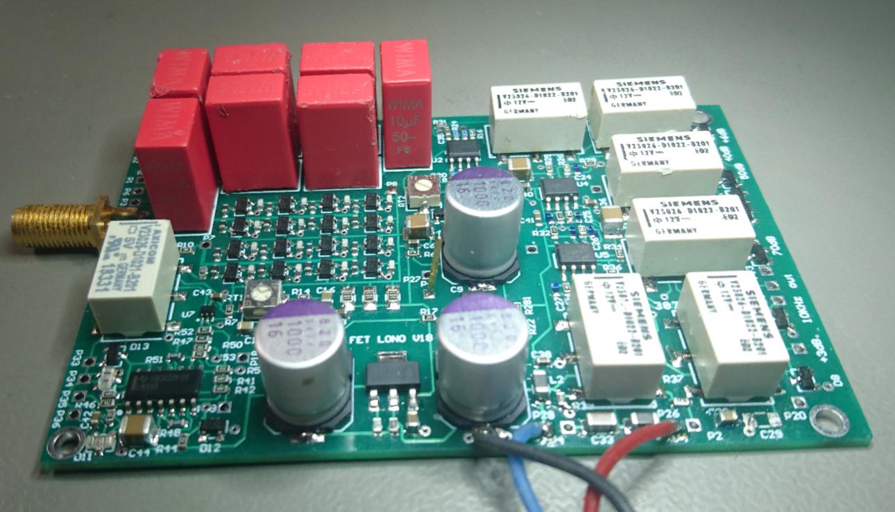

Before retirement, I had the BF862 designed into a transimpedance amp when the part was obsoleted. I eventually replaced it with Onsemi CPH3910. This was a DC to 25MHz application rather than audio, but noise performance was comparable to the BF862.

For JLBPCB it may actually be cheaper to share the design in their system and us order boards directly since their shipping and PCB prices are so low. Sending PCB's from EU to USA is more expensive than it should be. I just ordered 10 boards from JLBPCB that came to $25 delivered.
Very true. I added 5 pcs of a small 40x40mm PCB to my JLCPCB order of 5 larger PCBs - at additional cost of 1.6EUR.
Even cheaper to Europe. I got these just before XMAS. 10 pcs. for €14.20 all included.
There was also a UHF amplifier on that design and some test structures that I cut off
with the circular saw. ( Guess what it is 🙂 16*CPH3910, gain & BW switched cold with
relays. )
They send the production of a day for Europe to an agent of theirs who is in Germany.
He does all the customs and he forwards the small packages from the big box by inland mail.
Cheers, Gerhard

Yes. I did commercial GHz stuff over the summer, but during the xmas shutdown there was more time available than planned. There were only minor changes. Probably the last
iteration.
I'm also building a 432 MHz rig for EME. That's what the other half of the board was for.
We measured a noise factor of 0.3 dB for the SKY 67150 evaluation board on 432.
I only get 0.6 dB no matter what I do. I even swapped components with the eval board.
Mine is FR4, the eval is Rogers 4350. The only difference that stays. Can't believe
that it is that. Between the SMA and the FET gate is just 2*0603, 20 pF and 22 nH.
No resonance, nothing.
Cheers, Gerhard
