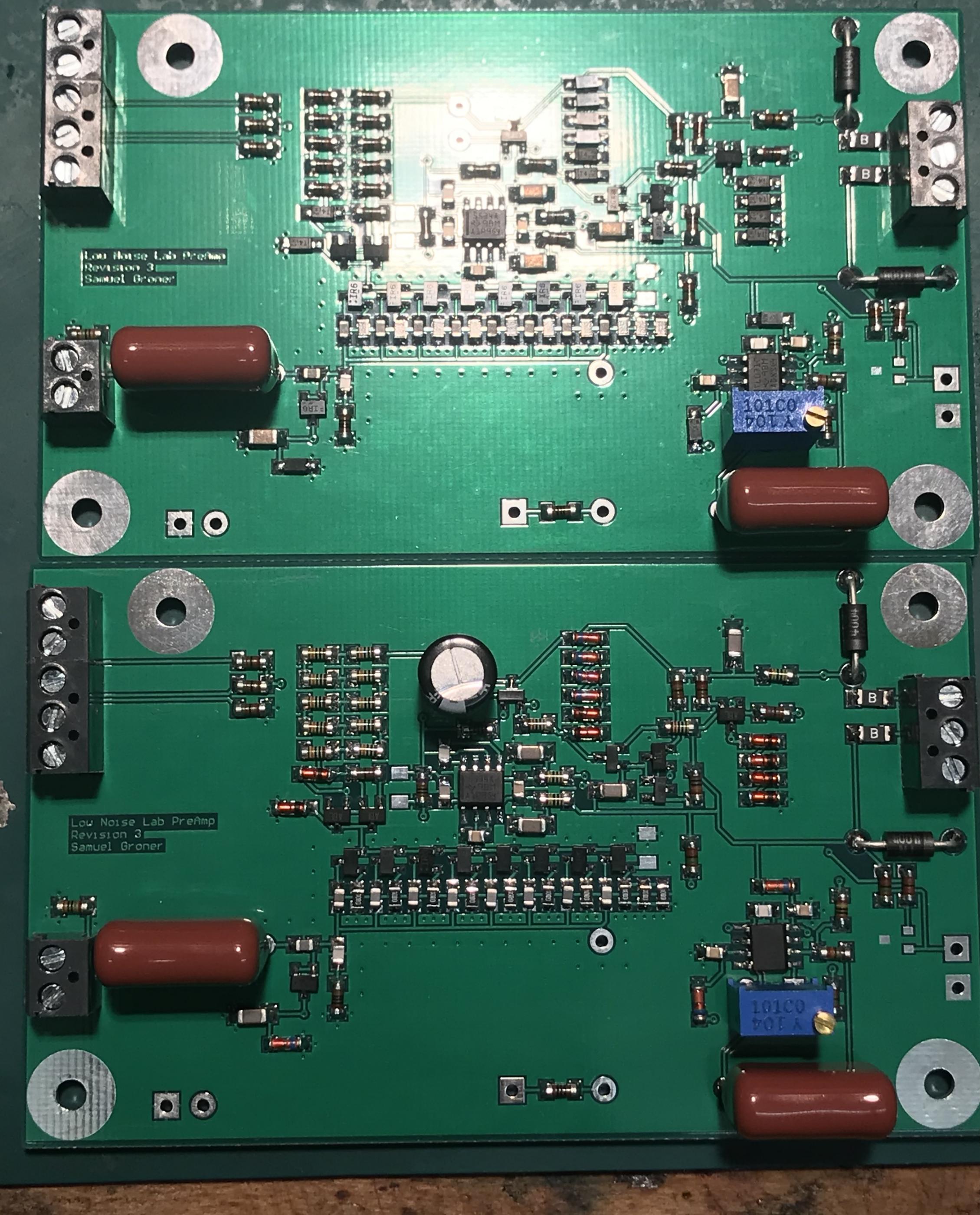

I finally got around to populating some PCBs that have been lying around here for a while. I have two more PCBs that have pretty much all the SMDs apart of the JFETs mounted already. So far I used 2SK3557-6, but if anyone feels like selling some of their BF862s, please let me know 😉

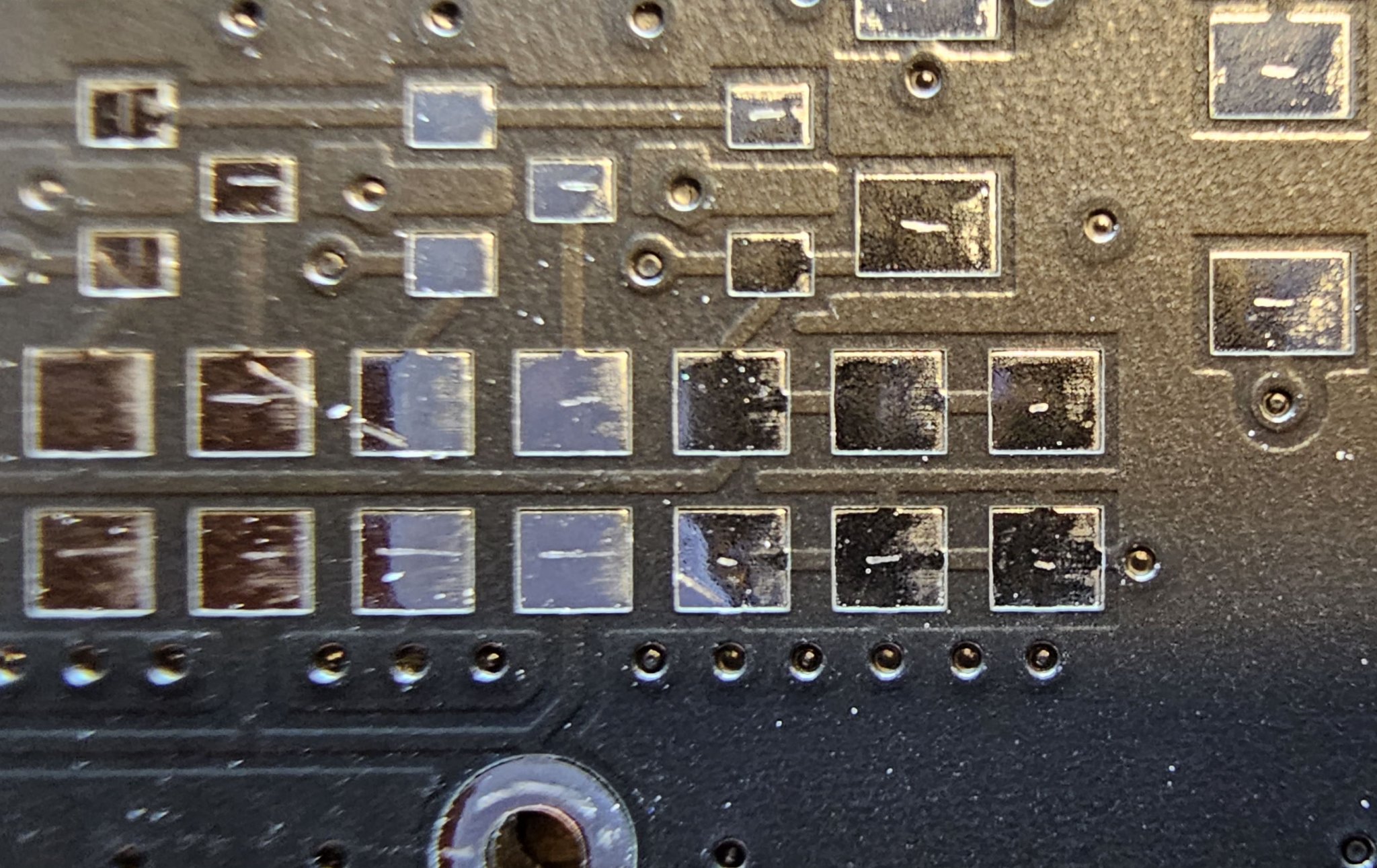

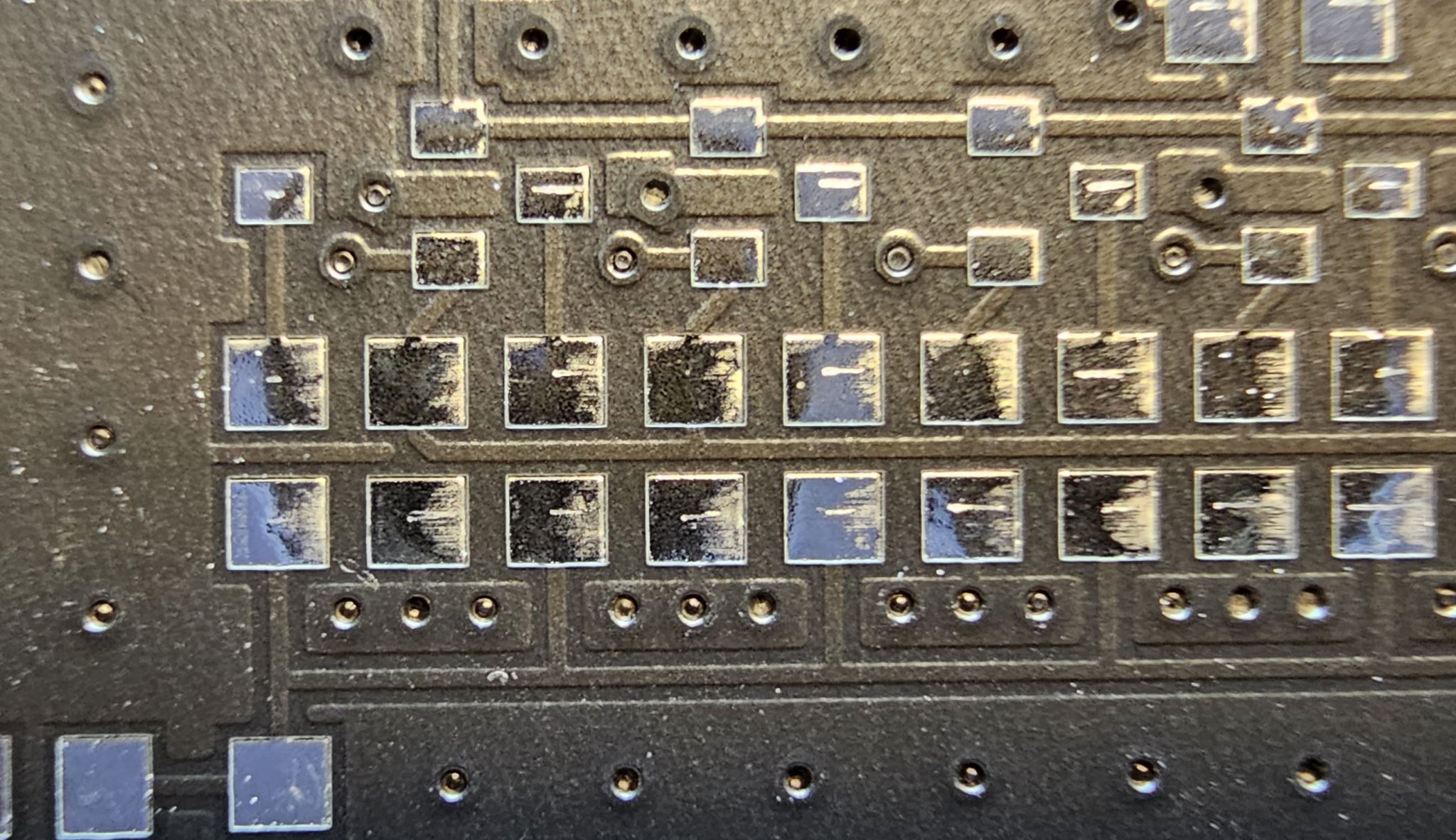

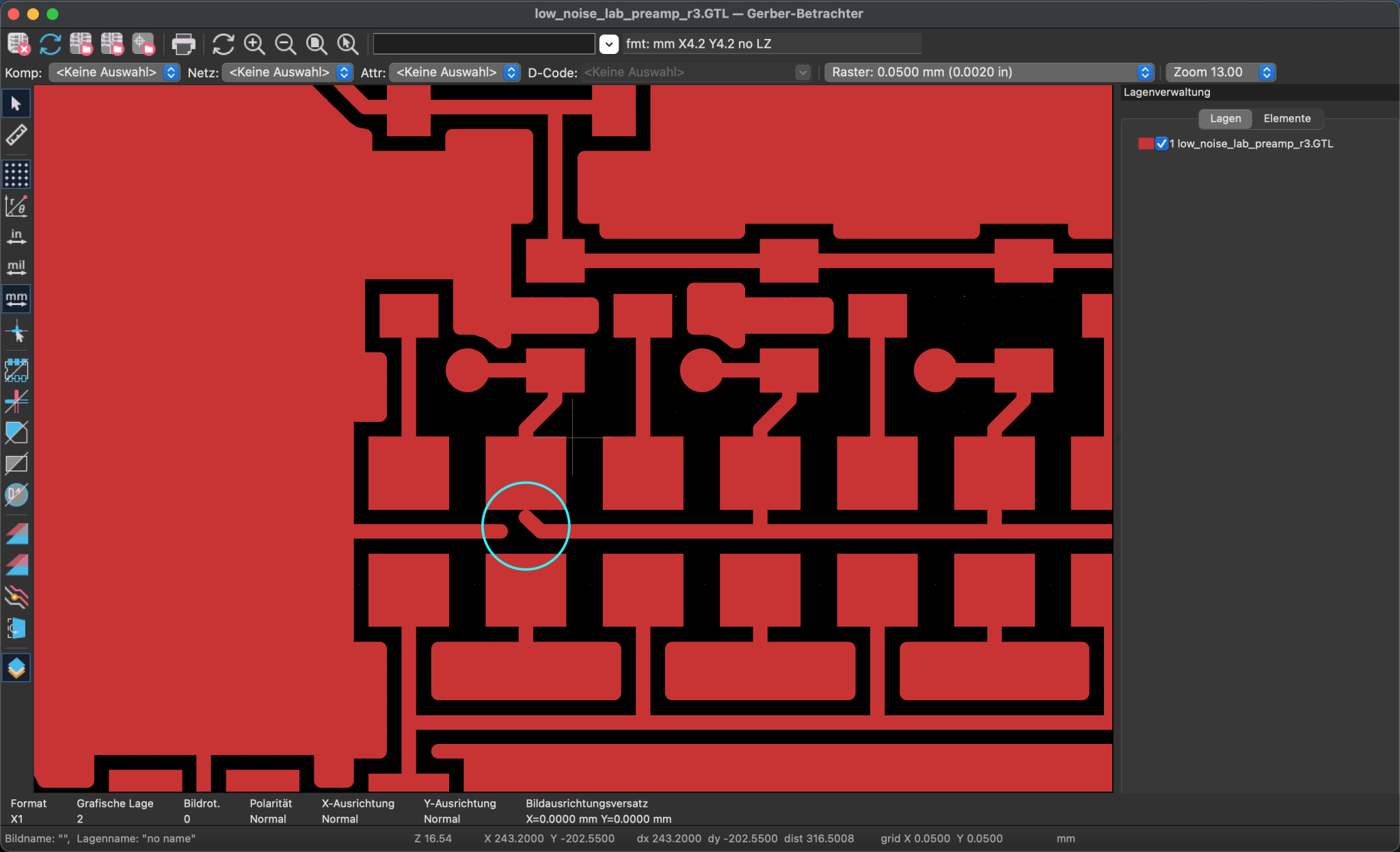

I don't know if anyone is still building this design, but just a note about the Gerber files: I was looking over them and spotted a small error on the top layer. The leftmost JFET has one trace that is barely connected, as indicated by the circle. Depending from which board house people got their PCBs, that error may have been spotted and fixed during review (in my opinion it should have, but one can never be sure).
About MMBF5462 replacements: Mouser stocks SMP5462 which seems to be a substitute made by InterFET. 2SA1312 is still stocked by Digikey. The JFETs that are suitable to replace BF862 are a bit thin in supply right now but not EOL as far as I can tell. 2SK3557/2394 seem to be the Idss ranked parts which are basically unobtainium right now, but the NSVJ3557/2394 which are not Idss ranked (just like CPH3910) are available. All in all, as of mid 2023 this LNA can still be built fairly close to original. I have attempted to fix the Gerbers and ordered another set, lets see how it goes.
Excellent detective work. I was sweating for the several minutes required to check on spare PCBs. Huh, all is good. 🙂
PCBs were manufactured at JLCPCB. I doubt that they correct anything at received Gerber files. Seems that standard minimum tolerance is enough to fill in small gaps. Here is actual macro shot of the PCB. The same error (?) is present at the right side of input JFETs row.
