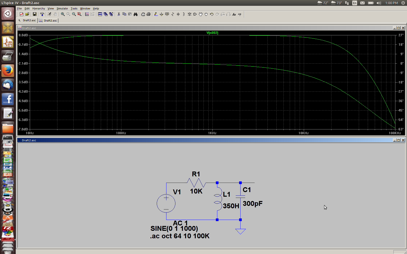

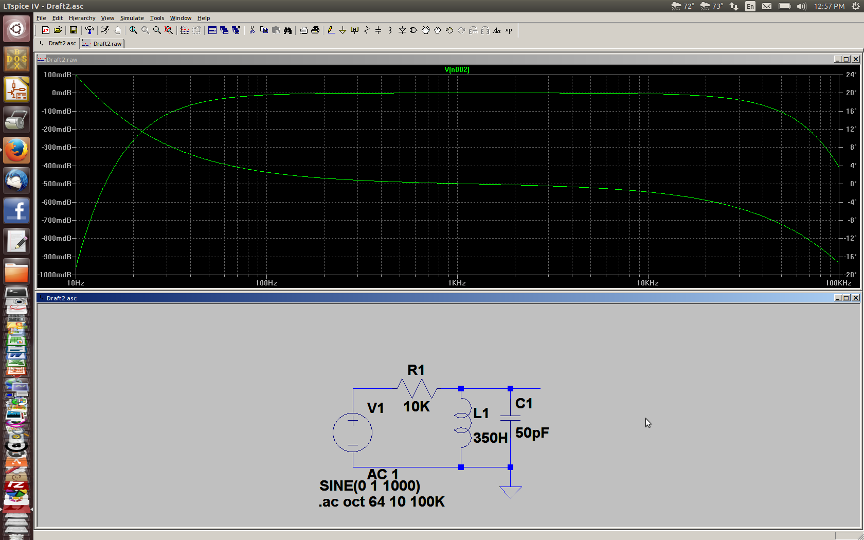

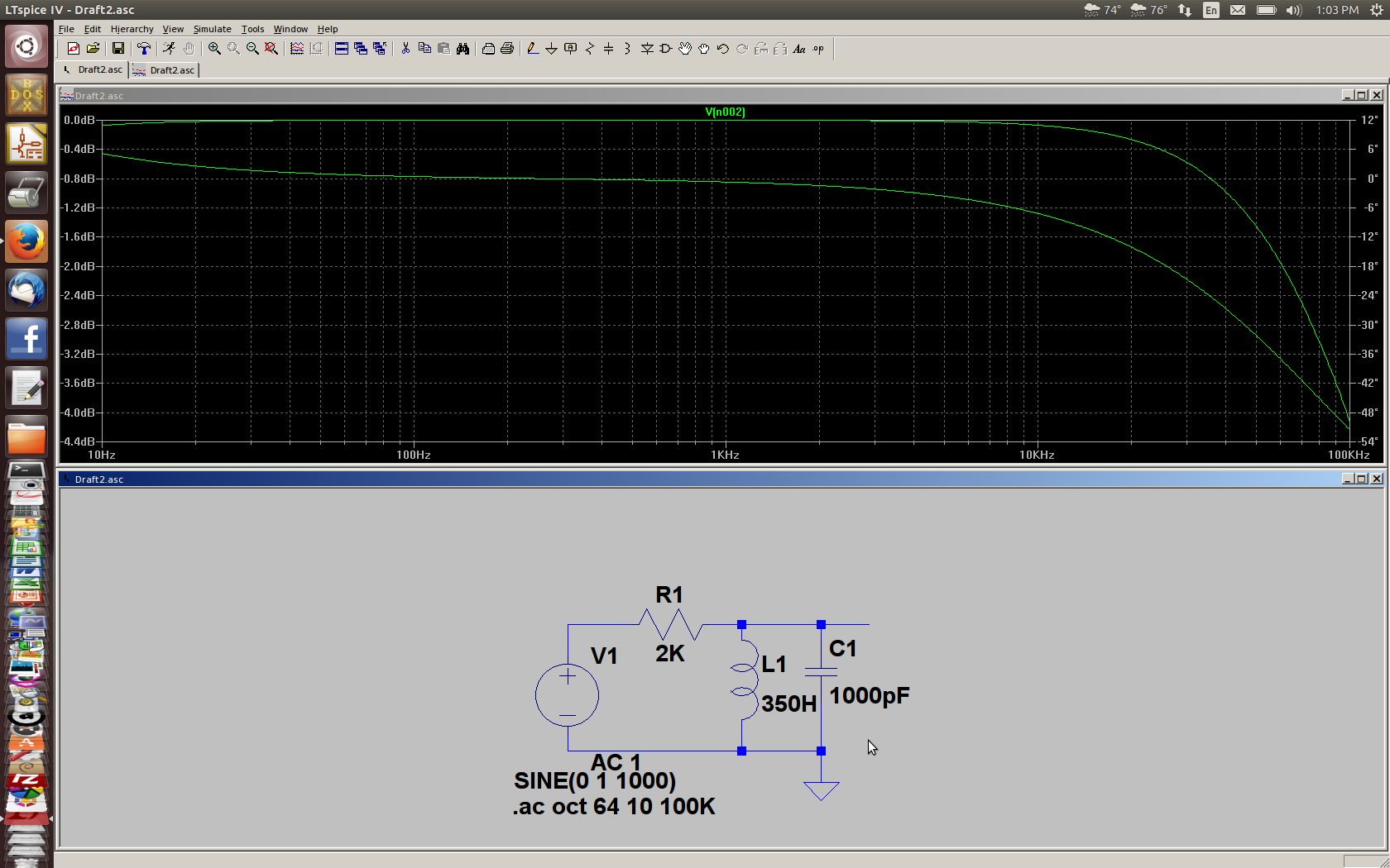

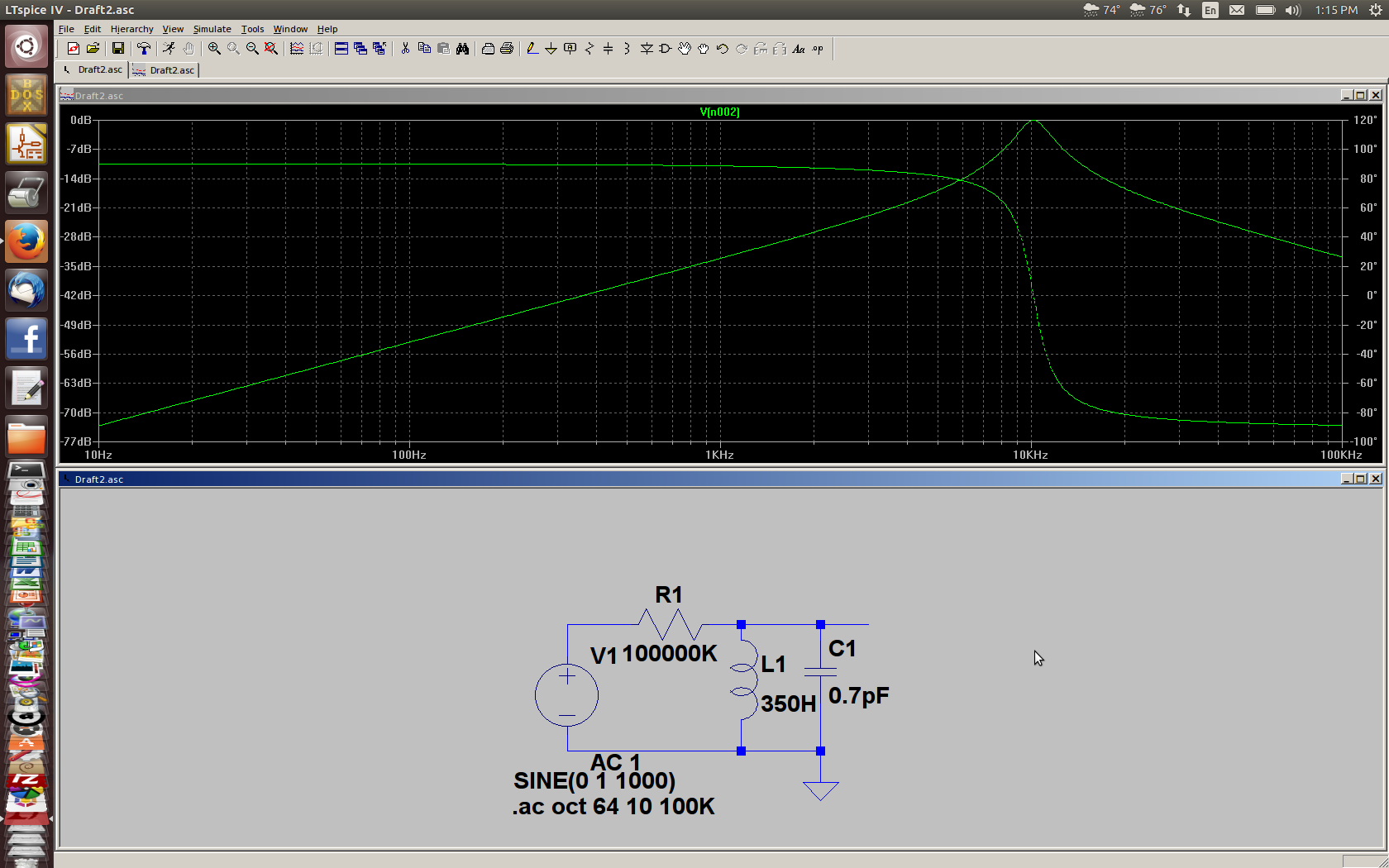

Grid Chokes
Note this assumes an ideal inductor with 1K DCR, in practice there will be appreciable shunt capacitance across the inductor.
I've added a second one where I added additional shunt capacitance which includes miller capacitance and the shunt capacitance of the choke.
The third one shows a better implementation with a lower rp tube, and likely a realistic amount of shunt capacitance.
See above, and I have measured exactly this behavior in the past. For the above to be true the source impedance of the driving source must be infinite. No question there can be problems with the implementation as my graphs show. (The source impedance appears in parallel with the inductive reactance and at all but very low frequencies completely swamps it.)
This is a common approach with tubes like the 50, AD1, and others where grid circuit dc resistance must be kept to 10K or less. I prefer ITs in most instances, but good ones are very expensive. Power drive would be a modern and suitable alternative.
Here is the case that most closely illustrates your concern, to do so I had to remove the effects of DCR in the choke and drive it from a 100Mohm source, but it shows a clear 10kHz resonance, but the conditions modeled do not even remotely reflect actual usage.

OK, but I still keep lots of questions about the use of such an inductor in such a circuit.
Resonance may or may not be of importance, but always is present. Also, an inductor has stronger nonlinearities than a humble high value resistor (say 220K), and it is also capable of high distortion, hum inducing and may be noisier than the resistor. And nothing to say about it's weight, bulk, size and higher cost device. Also a word with regard to their incontrolable parasitics.
All true of course, but there are situations where this works better than many other alternatives; specific cases where the dc resistance in the grid circuit has to be low, and the builder does not want sand in the signal path. (source follower typically)
