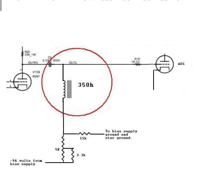

IIRC We are talking about AD1s in the output stage and these like relatively low dcr in the grid circuit.
Really? Ballpencil pointed out near the beginning of the thread that the datasheet says that 400k would be fine for fixed bias. Seems to not be particularly picky.
But if it really needs a low DCR path, a grid choke is a way to do it. I just was curious why mr2racer felt the need to make the change to the design, and I wanted to introduce the idea that there might not be much (or any) improvement over the 220k resistor.
But hey, sometimes I do something just to try it out and see if I can. Don't let me stop that. I'm just trying to understand the why.
When I first listened to the amp a while back it was distorted in a way I have never heard before. Some frequencies were fine, voice, others, bass and high frequencies were distorted. Grid chokes become more necessary as bis voltage increases. The amp required about -78 volts of grid bias. I built this same amplifier with 2A3, (@-40 volts) and it was great right out of the box. The only difference was the output tube. The voltages and currents were perfect and yet it sounded really strange. I have the grid chokes in correctly now but the bias PSU choke wasn't up to it and while testing it got really hot. I have a new PSU choke on the way.
This doesn't give me a lot of confidence that you have correctly identified the problem or have chosen the correct solution for it. You think you have a frequency-dependent distortion problem, so you are taking out a component which behaves well throughout the frequency band of interest and are replacing it with one whose performance will vary substantially with frequency. Your own calculations earlier in the thread reveal that you will have worse LF performance with the choke. HF performance might be better but only by a tiny bit since the 220k resistor isn't a big load for the 6SN7s that are already loaded by a 33k resistor in the plate.
Who says that "Grid chokes become more necessary as bias voltage increases?" I've built amps that require similar levels of negative bias without a grid choke. They aren't necessary at all. They are simply one option among many. They have pros and cons. They should be used when the pros outweigh the cons.
You made one major change when you changed tubes, you put a tube in that requires much more driving voltage. Voltages aren't labeled on the Uniamp schematic. Are you sure you aren't just clipping the driver? What is the driver supply voltage?

But surely you agree that if he is clipping the driver stage, a grid choke won't magically fix that.

Absolutely 100% in agreement, and it could well be the problem here. I'm a little overboard in the iron department these days but very pleased with the overall system performance.

This is how I have it now. What do you think?
I'm not sure what you mean exactly? The idea of the grid choke is to provide high impedance for AC, (the input signal) and low resistance for DC, (grid leak). So adding a cap where I think you are suggesting would shunt the signal to ground, no resistance/impedance to the input signal?
Not if you connect it to the bottom. To the top, yes.
