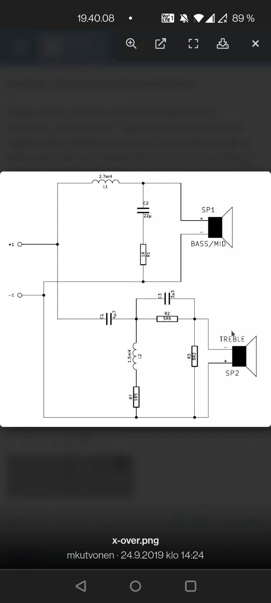

Thats Samu saurama's speaker called piste (piste means dot/spot of something like that). Finnish shop uraltone payd that project and thats why you cant see crossover information anywhere.I have not seen one, only a finnish website describing a kit. but no measurements other then a single in-room response of the kit and no crossover info
Good thing IS that uraltone prices IS very good and you can buy there only The crossover and speaker plans, If you allready Haven The drivers.
Another good news IS that there IS another speaker called contrapunctum. That project IS done with b&c 15fcx76. Speaker (and amplifier) designer Mikko kutvonen ( i am pretty Shure that he uses Nick "Adolf corkscrew") made IT before piste was released. IT IS pretty same with cheper drivers wich needs bigger cabin (130L vs 200L) and it goes little lower but highs Are Tiny bit (i dont know how to say IT) scruffyer? Or something like that.
Why i know this? Mikko kutvonen IS diy designers and they Are friends. So They Cross listening Both speakers on same Space and thats their conclusion.
Mikko desing contrapunctums crossover allmost two years (with another projects) and Tell his blog about Every step he make on that Time. Uraltone allso sells kit to contrapunctums because peoples Ask They to do so and Mikko says that its okay. Contrapunctum crossover IS allso given away to mikkos blog and i attach IT here so you can get a some kind of clue what those drivers need to get exellent home speaker.
