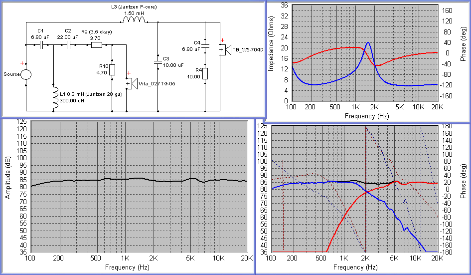

Zaph just posted his test result of the new non-shielded version of the TB W5-704. It turns out that there's virtually no difference in the frequency response beween the old 704S and the new 704D.
So, you can now be more cofident of using any of the 2.5-way crossover designs posted in this thread (three designs for TB 25-1166, Vifa D26NC55, and D27TG-05 tweeters).

Again, this is a Likwitz-Riley acoustic 4th order solution. All drivers are connected "in phase." The crossover occurs at around 2.2 kHz. As I always do, this is a result of full modeling, including box and baffle effects. A little different driver positions due to the larger flange of the D27TG-05-06 won't cause a significant effect on the response.
You'll need to experiment with the tweeter output by changing the R10 value (not R9). Don't be misled by the predicted frequency response above. You have to use your ear for the tweaking. My suggested range for adjustment is 6 to 10 ohms (default 8 ohms). A higher value will tilt up the treble, and a lower value will decrease it.
I'm so tired I can't remember if I asked already ~ which program did you use to do the modeling? Is that Speaker Workshop? Would you mind sharing the data files for the W5-704 projects?
edit: I looked now I remember, you use FRD Tools "The Passive Crossover Designer" spreadsheet for the FR charts...

I have no doubt that this design sounds good to the designer's ear. But I'm curious about some aspects of this design. First, where is BSC unless it's meant to be used in a wall? Adding a BSC circuit on the woofer will mess up the intended phase property. It will be better to add a BSC circuit before the system. Second, the design will be sensitive to listening axes due to the midwoofer's beaming. The crossover point is very high. The W5-704 is used virtually as a full range driver. I know every design is a result of compromise. But I'd choose better off-axis performance rather than inaudible minimal phase rotation.
-jAy
Jay,
I believe he intends not to add BSC. Mark in particular does seem to be interested in speaker designs which are either wall mounted, or, in very shallow and broad enclosures which can resemble large picture frames, and, which have artwork printed on the "grill cloth". ( see here: http://www.madspeaker.com/page08.html )
Every speaker is a compromise, let's ignore designs that are just downright bad, for now, for the sake of discussion, and consider that each speaker that might be considered excellent by some group of people will have it's own set of trade offs. Different people will be more or less sensitive to specific compromises.
I immediately thought "oh, that woofer will be beaming the high frequency" when I looked at his proposed two way design myself. But, I think I want to listen to it anyway because it's not often you find a speaker design which can actually work ok with the entire crossover consisting of only one capacitor. I can think some of applications.
I'll be making some "bass bins" with a pair of 6.5" woofers in each, I imagine those could handle the BSC well? Their 88db sensitivity and I'll use them in parallel. Hopefully my amp (Onky TX-DS787) is comfortable with the just under 4 Ohm impedance, if not, I'll have to build something like the 41hz.com "Amp 9 Basic" which is good down to 2 Ohms running off 12V DC.

Jay_WJ said:
OK, if you keep asking.
Ok,
What changes (significant I am sure) need to be made to this if I make 2 for the surrounds as an MT? I am not sure, but I am thinking that no bsc is needed because these are likely to be pinned up against a back wall that is 45 degrees to the listening area. (I live in an old Victorian home btw, in case you were wondering) So, along with less important program material being fed to them, they will be in a pretty poor listening location.
I am going to PE tomorrow morning, if possible, and have little time to research a design for the crossover. Any help would be greatly appreciated. I will be using the same drivers as is discussed in the quote, just not in an MTM.
Jon

I am not asking for a redesign here, just wondering if I would have to make many changes to your crossover design if I were to use 4 of the tangbands in the mains instead of 2, and would I get much of a useful gain if I were to do so? I will have 2 extra since I am not gonna do mtm's for the surrounds.
Jon
Rather than using any more of the W5s in the main drivers, I would crossover to (a) subwoofer(s), or, build a "bass bin" instead of a speaker stand with something like the RS225, or the Dayton SD215:

I do recommend reduced BSC for the surrounds, and possibly even mounting them on their sides so they face away from you somewhat for a more difuse sound on the surrounds. (Well, TRY that before you go making holes in the side of the speaker, see which way sounds better w/movies)

14G-Dutch^ said:
Sure Jay, I am sorry I was away tonight @ my good friend's daughter's basketball game. Much appreciated.
Jon
Here you go.
-jAy
