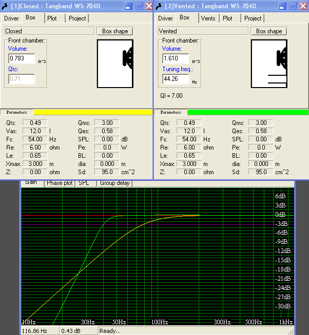

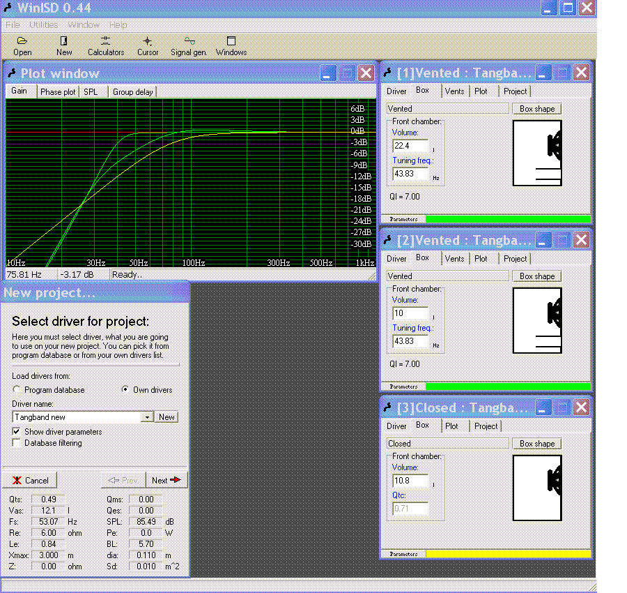

So, I got the measured specs of this driver from Zaphs post on another server that was recommended. When I plug them into WinIsd it actually recommends a small enclosure for closed, and vented is about what you recommended. If I am willing to lose some low end extension a somewhat smaller box looks good too. What I am ot sure of is if I am putting the numbers in right, or if this recommendation by the program is misleading. I will try to post an image of what my results were.
Jon
Here goes:
Ok, after looking at the spec I put in the WinIsb program I noticed that I mistakenly left the Xmax in Meters, so i have a 5 1/4 inch driver with a 3 meter xmax!:bigeyes: Sweet! bassheads have found their new champion!:smash:
I thought maybe this screwed things up, but after putting the figures in correctly, I think, nothing changed much.....Vented now shows 23L but 43.5 tuning, and closed is now 11L.
If I mis-entered anything else, please do tell.
Jon
John L and 14G,
I don't know how your WinISD sims gave those numbers. But according to my Unibox sim, using Zaph's new 704D T/S measurements, a sealed box volume that gives Qtc=.707 to a pair of 704D's is about 19 liters (0.7 cu ft). This is obtained by assuming no leakage, heavy damping, and 0.3 ohm series resistance (from inductor DCR in xover).
According to the Unibox calculation, a vented design with two drivers requires a large box volume. Software suggests 57 liters, and at the minimum a 28 liter (1 cu ft) box is needed to have reasonably smooth bass response without a peaky midbass. Two woofers in a 28 liter box with 45 Hz tuning give an F3 of 44 Hz with a .7 dB response peak around 100 Hz.
Yeah, that is a little strange. On the closed box, it is supposed to be at a Q of .703 and an optimum box size of .348 using two drivers.
On the vented side, it shows the optimum at .642 cubic feet, tuned at 56 hz. I'm not sure which set of numbers I used. Perhaps I probably should use the ones dlneubec actually measured and posted over at the HTforum.
Either way, the smaller or larger cabinet sizes should still work well, especially for the closed box. I don't see much change in the curve there.
I ran WinISD. Its default suggestions are .78 cu ft for closed and 1.61 cu ft for vented. Close to what Unibox suggested. See the attached image.
I used Zaph's new measurement. All values are very close to Dan's except Le. But Le doesn't affect bass response modeling. In WinISD, I found that only Qts, Vas, and Fs affect the modeling result. I think Unibox provides more sophiscated modeling.
14G,
Mine matches your result except (it seems that) you used a single driver rather than two.
Jon,
You obtained essentially the same result as I did. Only difference is the number of drivers. Similar responses were given by the Unibox, too.
Xmax is nothing to do with bass response.
I played with other box volumes. It turns out that two of these drivers can be used in as small a box as 10 liters to obtain a good, sealed 12 dB rolloff with a negligible midbass peak. For vented, as John said earlier, a 20 liter cabinet can be used with a mild midbass peak. But I prefer a result with 28 liters or larger.
The conclusion is, it is optimal to use this driver in a sealed design, but a vented design is also doable. Ideally, I'd do an MTM or a TMM in a 15 to 20 liter sealed cabinet for use with a subwoofer.
