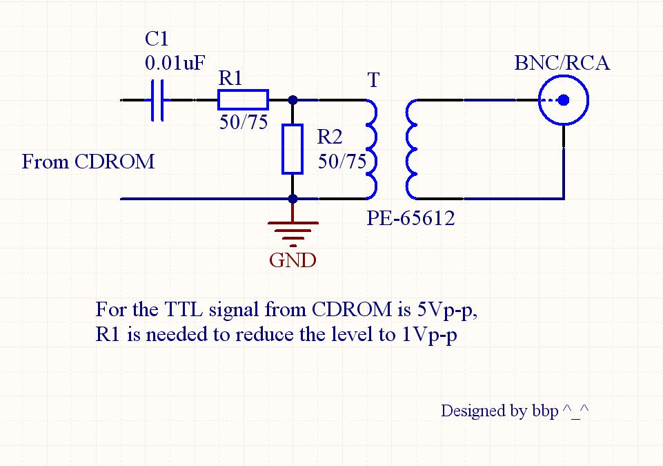

Another question: Does your kit take the TTL signal from the CDROM and output SP/DIF? Or do I need to try and find a CDROM that will output a true SP/DIF signal?

The Digital Out from CDROM/DVDROM is TTL signal in 5Vp-p, plus a 0.01uF and 75 omega (also,47/50 omega can be used) can easily transfer the TTL signal to SPDIF signal
-----|0.01uF|----------
TTL signal in 75 omega Spdif out
A PE-65612 Digital transformer gives a better performace and electrical isolation.
Hi bbp,
Do you have a circuit drawing for the PE-65612 Digital transformer and do you sell it ?

Hi Serge,
Here is the circuit. I am searching for the DIGITAL AUDIO transformer,too. Maybe PE-65612 will be available in one or two weeks.
