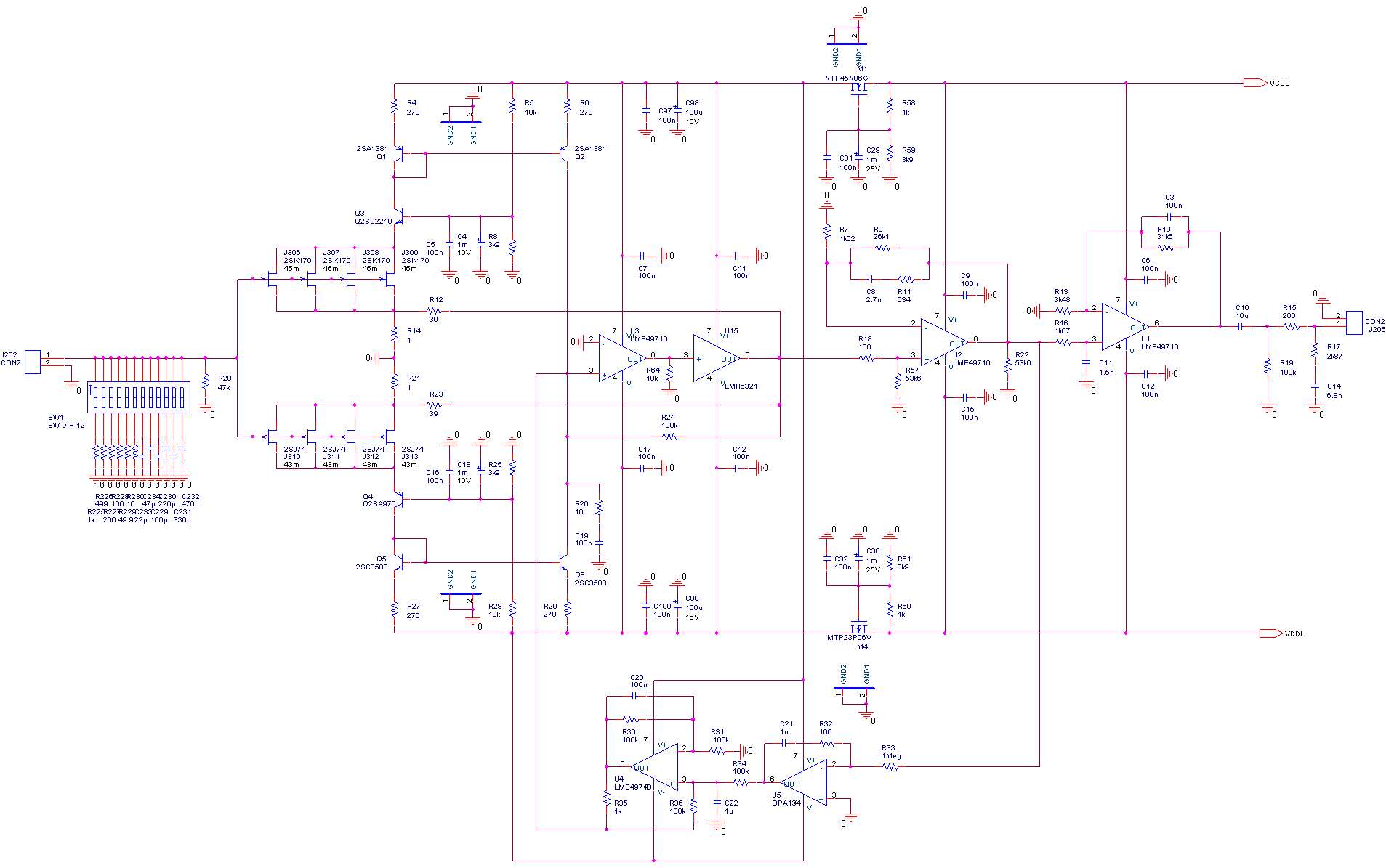

Hps 3.1
HPS 3.1 is finished.
Here's the board level schematic (one channel only).
Changes since HPS 3.0:
- High power buffer added to the head amp. LMH6321 has 300mA output current, allowing the head amp to swing to +/-10V.
- LME49871 opamps, supporting +/-22V power supply voltage. This and the previous are now allowing an overall headroom of over 36dB.
- MC input only, fixed gain.
- Local serial regulators for the head amp.
- Current servo allows no caps in the signal path (except for the optional output cap).
- Servo also allows largely unmatched JFETs; Idss can be +/-3mA, so BL class devices need not to be matched.
- Extended input impedance range (10ohm-47K and 0pF to almost 1nF).
Dual mono construction, power supply schematic will follow soon.
Some measured noise performance in the next messages.

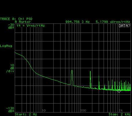

HPS 3.1 LF noise
This is the LF noise, unweighted. For measuring this, the RIAA network was pulled, the amp has an overall gain of 16550 and a BW of over 100KHz.
Noise at 1KHz is 5.18uV/rtHz divided by the gain, rendering 0.31nV/rtHz. Right on the design target.
The 60Hz odd harmonics are almost vanishing as soon as the case is closed.

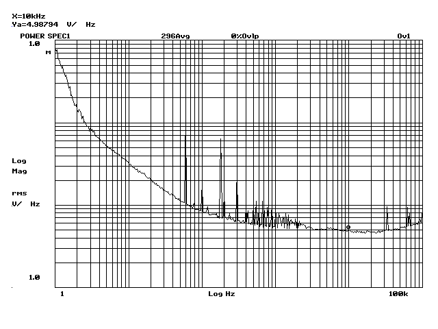

HPS 3.1 HF noise
This is the HF noise, unweighted. For measuring this, the RIAA network was again pulled, the amp has an overall gain of 16550 and a BW of over 100KHz.
Noise at 10KHz is 5uV/rtHz divided by the gain, rendering 0.3nV/rtHz.
The artifact is a TV SMPS running in the house.
More measurements to follow.
Re: HPS 3.1 LF noise

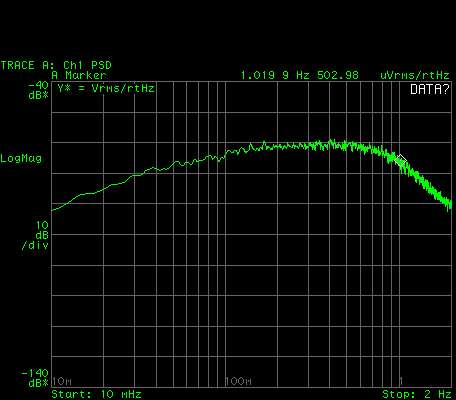

Lookin' good. A couple of observation/questions, the noise getting below 100Hz or so seems to pick up to more than 1/f maybe a little GR noise. The increase at very low f could be moving air causing local thermal uncertainty. Does this get better in the box? Not that it matters, more of an instrumentation question.
syn08 said:This is the LF noise, unweighted. For measuring this, the RIAA network was pulled, the amp has an overall gain of 16550 and a BW of over 100KHz.

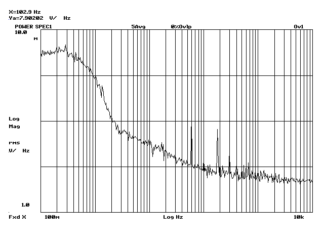

Re: Re: HPS 3.1 LF noise
Most likely, this thing is running pretty hot, in particular the power buffer, which is SMD and heats up the entire board. Closing the aluminum case seems to have a limited impact, though. It could as well be the buffer noise itself...
Here's a better view of the same effect.
Now, down to 0.1nV/rtHz 🙂
Nope, I don't think it's a thermal effect... It seems like after bumping around 1Hz the spectral density at 100mHz more or less goes back to 1/f, the physics is saved!
At this point I suspect the power supply, namely the power MOSFETs used all along. It's mostly academic, but nonetheless interesting... I'll let it overnight to get a few 10mHz averaged measurements.
