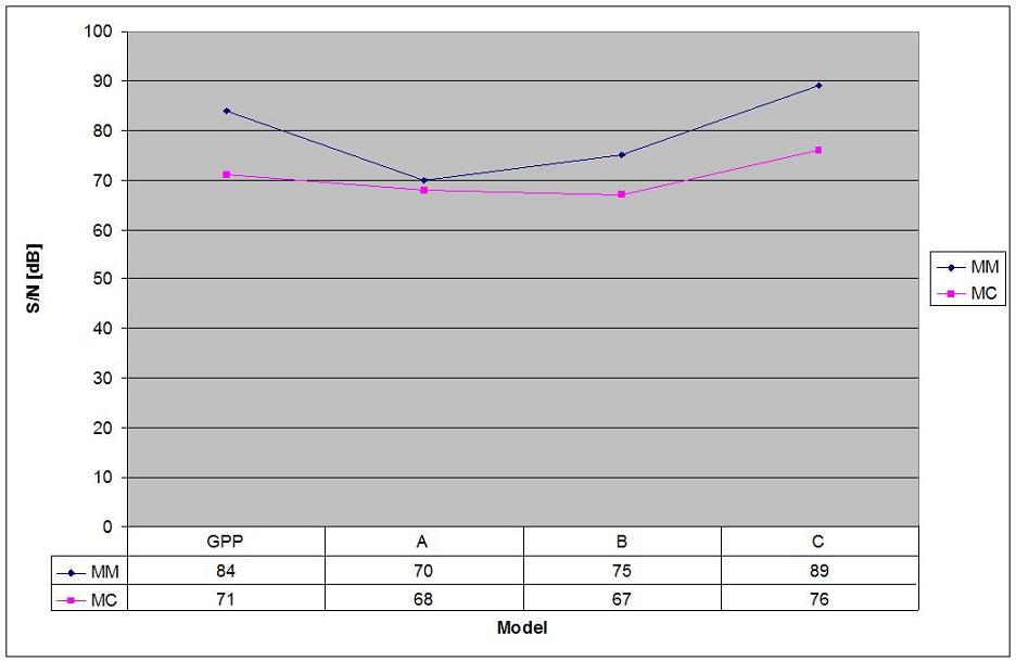

Here's the promised comparison. I won't disclose the manufacturer's brands and models, but only the current prices (brand new). Enough to know they are all brand names, while B and C are highly regarded in Stereophile and other reviews. I don't have the schematics for any of the A, B and C so I can only speculate about their internal architecture.
A - "Low end", $100
B - "Mid Fi", $1600
C - "High End", $3000
All S/N numbers are 20Hz-20KHz unweighted, 2.5mV input for MM and 0.5mV input for MC.
Looking at the MM results, the differences between models are significant. My assumption is that the low performers (A, B) are using a regular opamp input stage, hence the poor noise performance.
Looking at the MC results, it seems like B and C are using the same input stage (so does GPP) and switches the gain downstream. Model A seems to switch/add a low(er) noise input (bipolar discrete? it certainly doesn't seem to be a low noise JFET design) stage, the S/N difference between MM and MC is very small.
But what seems to be really interesting is the very small gap between GPP, A and B MC S/N. Now, you tell me if this gap is worth $1500 difference between models A and B?
Experimentally, GPP may reach the Model C performance if upgraded to 4x2SK170 in the input stage. But 2SK170 are close to unobtanium, so other ways have to be developed. Two questions arise here:
- Is the performance gap between 2SK170 and any other solution worth anything but a nice spec sheet?
- If such performances are really worth of, how to proceed from here?

71 dB SNR rel 0.5mV is OK, and excellent for a first design, but I would not settle for that when designing such a fairly complex RIAA amp as yours. Especially as I would design an MC-only RIAA amp for low resistance cartridges (<10 Ohm) with <= 0.5mV output voltage.
You might want to try low noise parallelled bipolars for the input stage. THAT has some low noise types, or you can try the 2SC2545,6,7E.
The 2SK170 are not hard to get at all. I do not understand that you find them close to unobtanium.....even the 2SJ74 are easy to find.
I would say that if you have a low resistance low output MC cartridge needing maybe 90dB of gain a low freq, more SNR can come in handy.
There are much more than SNR - how does it sound is the most important issue.
Overload issues are also important.
RIAA accuracy of course.

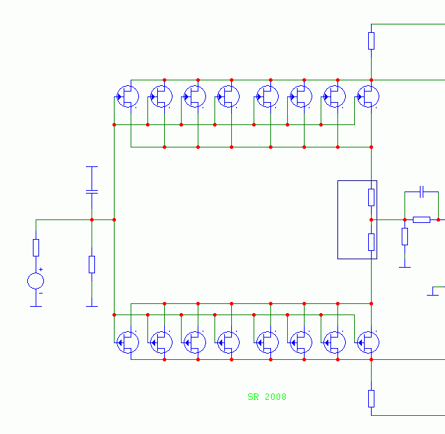

Syn08, there might be another possibility here. since the JFET you are using is ultra-quiet, it pays to put as muchof the verall gain in the quiet front end stage as possible. So, I would experiment with increasing the JFET + first op-amp circuit block stage gain. Tradeoffs are required, but if its low noise you are after, this is one way.
The attached input stage will give an SNR of about 77 dB rel 0.5mV 20-20kHZ unweighted with RIAA curve using 8 pairs of matched SK170/SJ74BL,
and a very low resistance feedback network and a 5 Ohm pot.

Sigurd Ruschkow said:The attached input stage will give an SNR of about 77 dB rel 0.5mV 20-20kHZ unweighted with RIAA curve using 8 pairs of matched SK170/SJ74BL,

Sigurd,
Paralelling more JFETs is the obvious solution in an attempt to gain some extra SNR dBs. Unfortunately I have found significant stability issues when using more than four 2SK170, unless you add some gate resistors which are then, of course, pooping the whole party.

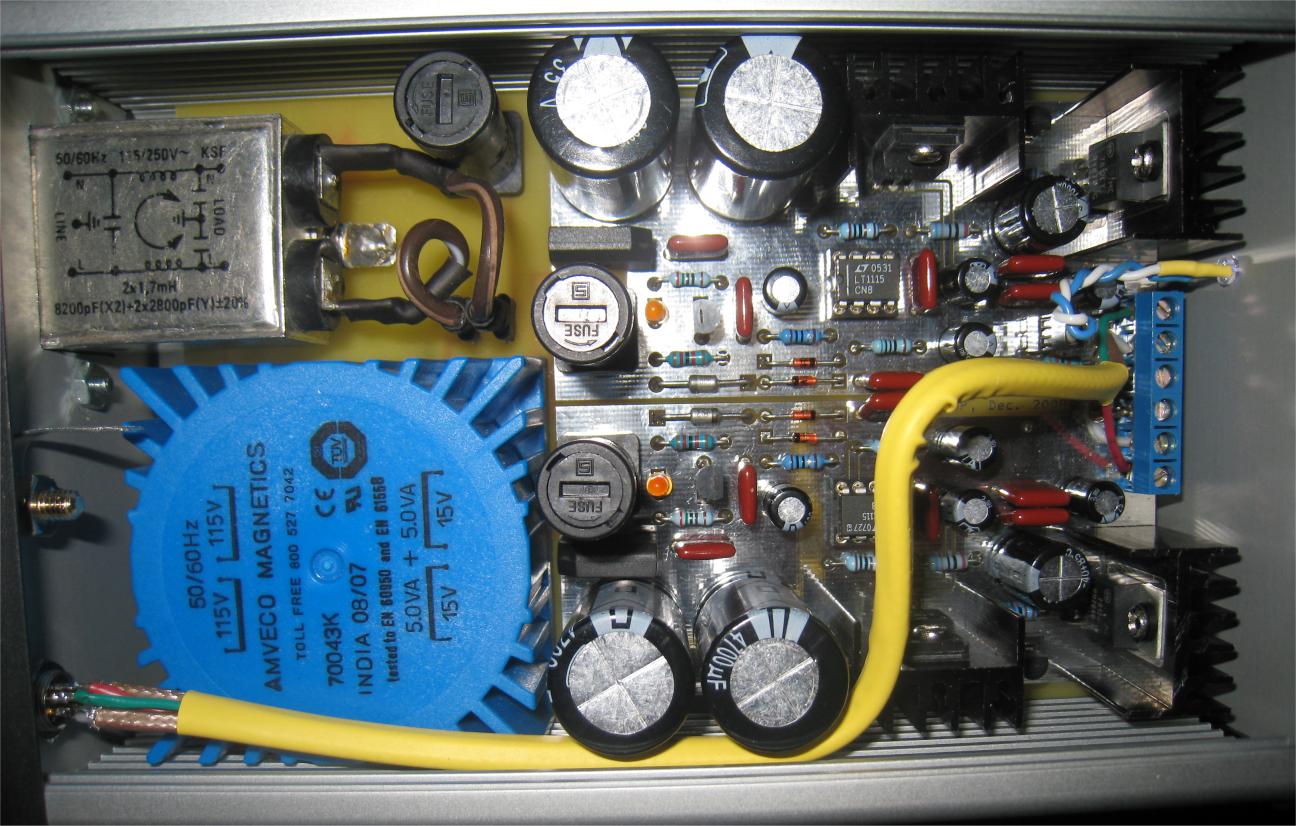

syn08 said:
Sigurd,
Coincidentally, the Nelson Pass Xono (which I highly regard) AFAIK uses four cascoded 2SK170 in the input stage.
Sigurd,
...and a pitiable sound. Innocent attempts to fool physics like this have been made before, always with modest success.The attached input stage will give an SNR of about 77 dB rel 0.5mV 20-20kHZ unweighted...
Hps 2.0
Well, GPP is now re-baptized as HPS (Hybryd Phono Stage)...
HPS 1.0 had already very good performance, however I was looking forward to add a few new features and further improve the overall performance. While HPS 1.0 has under 1nV/rtHz noise (SNR is 71dB for MC and 84dB for MM) and -88dB crosstalk, I was targeting better than that. I already knew that 0.5nV/rtHz requires 4 x 2SK170 in parallel (and, for stability reasons, that's about all you can do without adding gate resistors), but what else? Having a spare 1.0 PCB, I've decided to cannibalize and use it as a "breadboard" to further experiment. The sad news is that going under 1nV/rtHz requires a completely new overall architecture... So it was time for HPS 2.0
First, I had to drop the idea of a wall wart power supply and TLE2426 virtual ground IC, even if followed by Jung super regulators. For whatever reasons, this solutions generates 60Hz harmonics which could be filtered at the output (before the Jung regulators) but unfortunately TLE2426 handles very poorly capacitive loads. It simply becomes unstable...
Secondly, the Jung regulators are pretty effective (having very good line rejection) but some degree of harmonics are still going through... The input stage (see the 1.0 schematic) had basically no PSRR so some of these harmonics appeared at the output. Nothing audible (I am talking here well under 1uV levels) but certainly annoying in measurements.
Third, moving from a wall wart requires a line transformer, so forget about hosting the power supply in the same case with the signal path... And then to add insult to injury, moving to a separate power supply requires extra wiring for sense and sense shielding, otherwise the line and load requlations are strongly affected (see Jung's article http://waltjung.org/PDFs/Improved_PN_Regs.pdf)
Fourth, the input stage could use some PSRR. Therefore, cascoding the JFETs and adding an extra local regulator would certainly help.
Fifth, improving the crosstalk to -90dB and beyond requires some power supply wiring layout changes. Keeping power supply traces, for the L/R channels, separate all along is critical. Note that in practice a -100dB crosstalk for a phono stage doesn't make much sense; a typical cartridge has a crosstalk of -20dB. So improving the original performance was more like a self challenge rather than a requirement.
And sixth, while I still don't believe in loading the cartridge with very low inpedance does anything good for the sound, I thought some input flexibility would be a nice feature; I added 4 resistors (10, 100, 499, 1k) and 4 capacitors (100pF, 220pF, 330pF, 470pF) giving 256 combinations of RC input impedances. The default impedance is still 47k/100pF. These are switchable via onboard DIP switches.

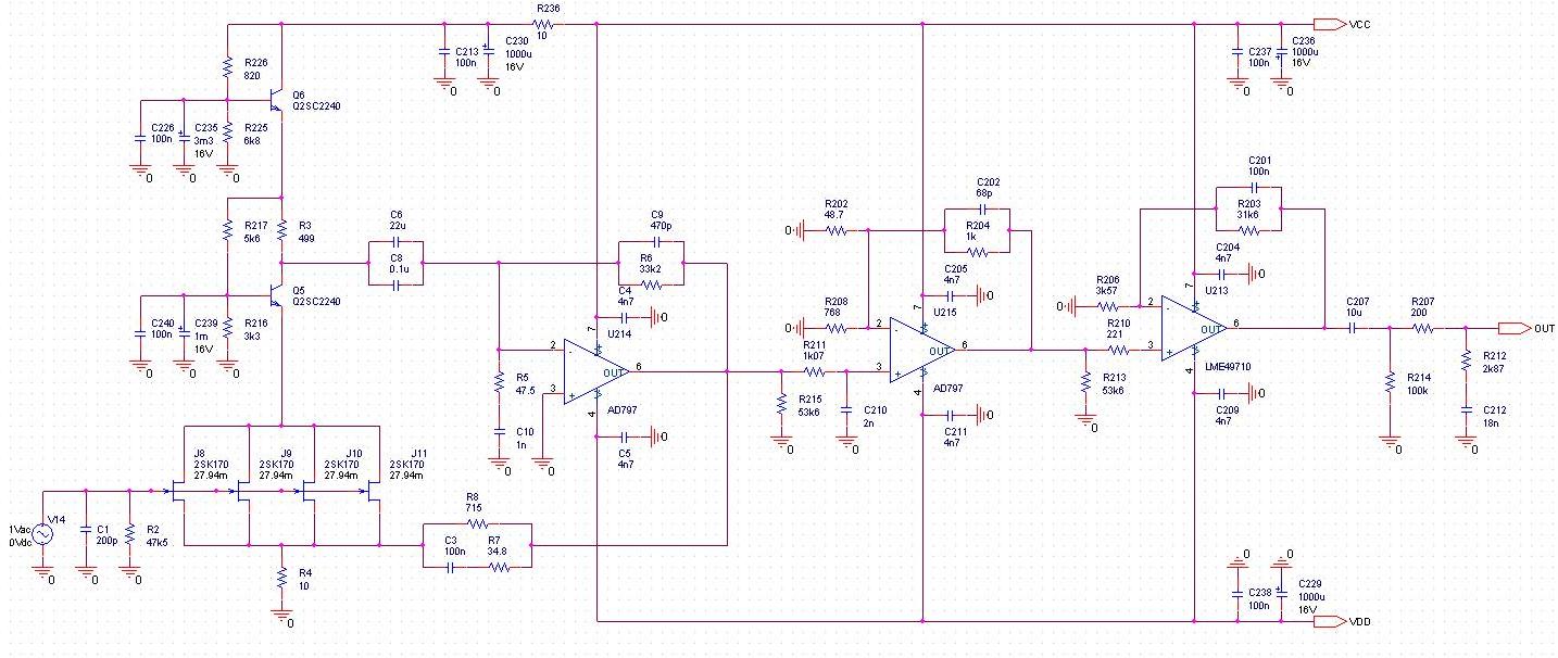

The HPS 2.0 schematic:
The power supply:
The signal channel:

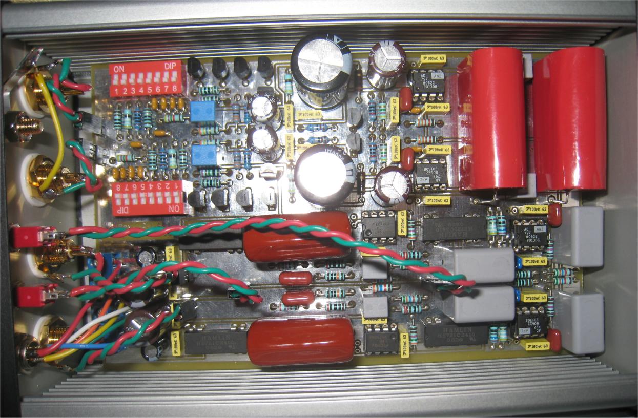

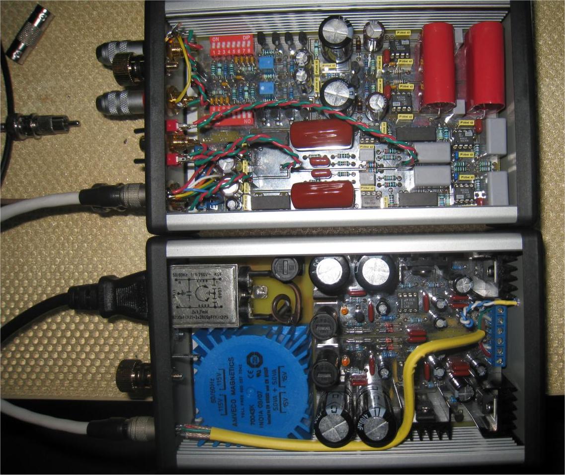

An overall picture of the implementation:
Performance:
Noise:
0.44nV/rtHz @1KHz, both MC and MM
SNR: 89dB MM @ 2.5mV input, 76dB MC @ 0.5mV input
RIAA:
+/-0.15dB 20Hz-20KHz
Crosstalk:
-101dB @1KHz
-97dB @20KHz
Distortion:
Better than 0.002% 20Hz-20KHz
To me, that's about all one can wish from a phono stage. Comments are welcomed.

Cute and probably not bad sounding. Power transformer is about 20 times smaller than what i use 🙂 Jung regs or not this is quite audible.
Syn08, That board sure is handsome. Did you etch it yourself? How did you do the solder plating and have it so smooth and level?
John
John
analog_sa said:Power transformer is about 20 times smaller than what i use 🙂 Jung regs or not this is quite audible.
Superstition.
We made a listening comparison with very expensive preamp, that uses two 100VA transformers and 164.000 µF filter caps. Anyway, that preamp was assessed as worse in a listening test. The preamp is not about transformer size that much.
Re: Hps 2.0
Good to see that you decided to improve the design!
SNR is now so good that it is no problems to use the RIAA with medium output MC cartridges. For MM use 89 dB is not really needed, so one can wonder why not connect an MM cartridge before the JFETs.
The huge red caps in the upper right corner and in the middle, what types are those?
Ideas for improvement could be to have adjustable gain, and adjustable input resistors for MC cartridges (although doing this manually might be the best solution).
BTW,
what gains do you have,
and what are the overload margins?
Sigurd

syn08 said:Well, GPP is now re-baptized as HPS (Hybryd Phono Stage)...
PMA said:We made a listening comparison with very expensive preamp, that uses two 100VA transformers and 164.000 µF filter caps. Anyway, that preamp was assessed as worse in a listening test. The preamp is not about transformer size that much.
We made a similar comparison. Opposite results. Of course comparing wildly different topologies and power supplies is silly. I am only talking of transformer size, everything else kept equal. Had to redo the casing to fit a bigger unit; not something i do lightly.
