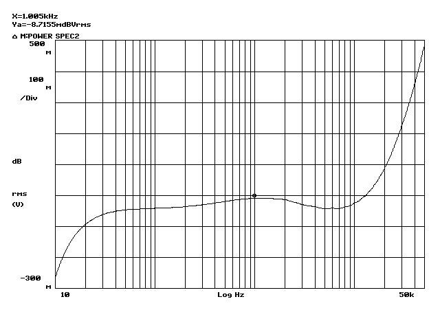

Finally got some time to precisely measure the RIAA errors. The attached is the difference between the measured frequency response and the ideal RIAA response, synthesized by the pole-zero method (two poles at 50Hz and 2.12314KHz and one zero at 500Hz; the mythical f4 zero at 50KHz was not included here). Both the measurements and the synthesis were performed in a HP3562A DSA.
The graph shows clearly that the +/-0.1dB target (20Hz-20KHz) was reached. The shape of the curve is very close to the Hagerman results http://www.hagtech.com/pdf/riaa.pdf in fig. 7
Now, certainly, +/-0.1dB is and absolute overkill. Assuming the decrease in intensity of a spherical wave as it propagates outward in air as an inverse square law, and a listener at 10ft., 0.1dB is equivalent to the variation you would get by moving the listener by plus or minus 3/8 of an inch, off axis. Anybody willing to set up a test and report back the audibility of such and error?
Anyway, for any practical purposes, +/-0.2dB should be more than enough.

I agree on the tendency for some to obsess on RIAA accuracy. My big divergence from most is this. How often do you change cartridges? Me rarely, so I solder everything in permanently, by this I mean termination R&C, and all connectors too.
If you think about it a new cartridge means a set up (draging out the Dennesen Protractor or whatever). The time spent soldering new termination components is small change.

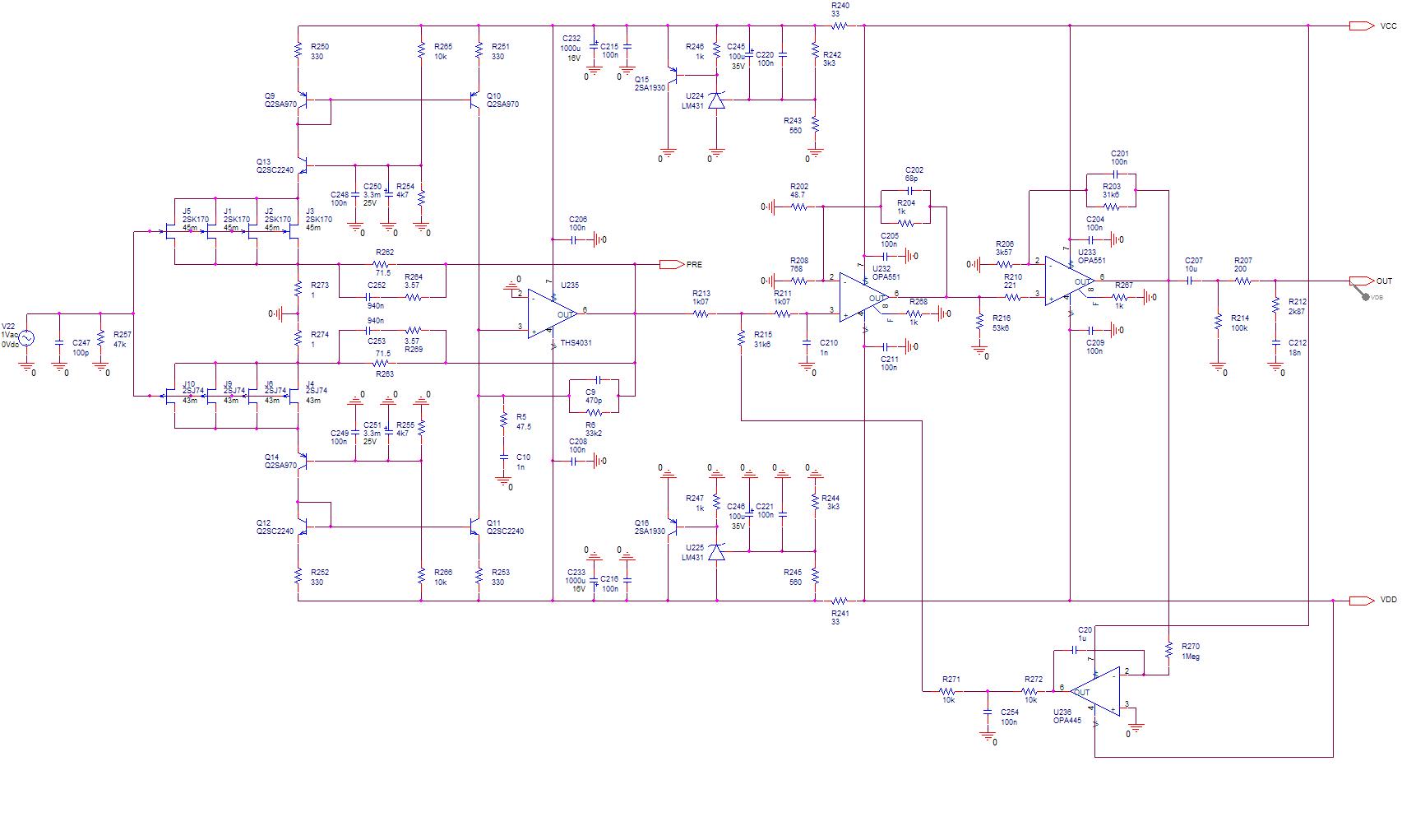

HPS 3.0
Full concept schematic (shown here with THS4031, a good alternative here to AD797, SMD though). Whatever very low noise opamp will work here instead, but has to have pretty high output current (around 100mA) to drive the feedback network under overload conditions.
High voltage opamps are used for the rest, to provide a large headroom.
Some minor changes may eventually occur. The PCB schematic has onboard provisions for input impedance switching and gain control via DIP switches.

Have you considered opamp + UG buffer to drive low imp FB network? I tried and it helps, a right way IMO.
Re: HPS 3.0
You mentioned simulations. I have found sims to be accurate regarding noise analysis.
If you simulate your design with your JFET models, how much discrepancy do you get between real world measurements and simulations?
And how does your JFET models look like graphically noisewise?
Sigurd
