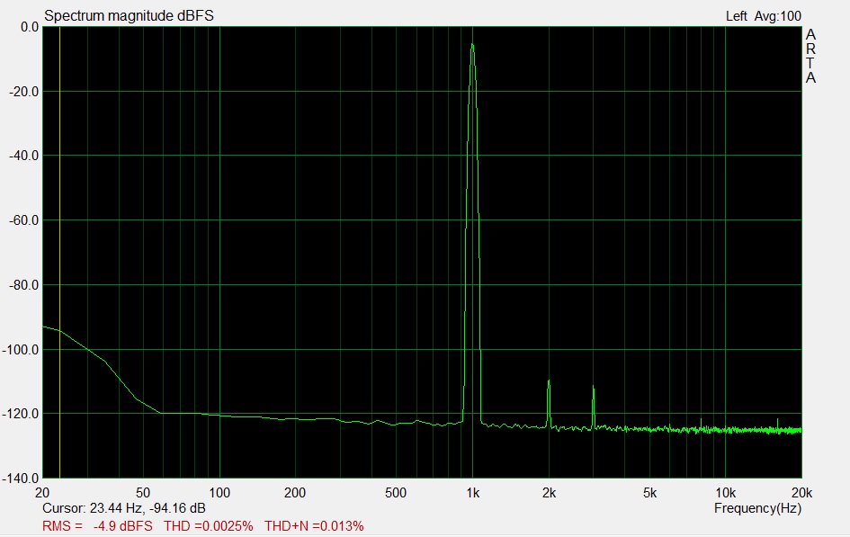

That definitely doesn't look right. I think you have some outside interference. 2nd and 3rd harmoic are present. But the higher stuff is not a harmonic of 1Khz.
The sloping noise floor is also dubious. I'd expect some rise at low frequencies, but overall I would expect it all to be below -120db and closer to -140db.
edit: oh I just realised this is measuring something else so the noise floor comments above probably don't apply. could you post an SE loopback measurement for comparison?

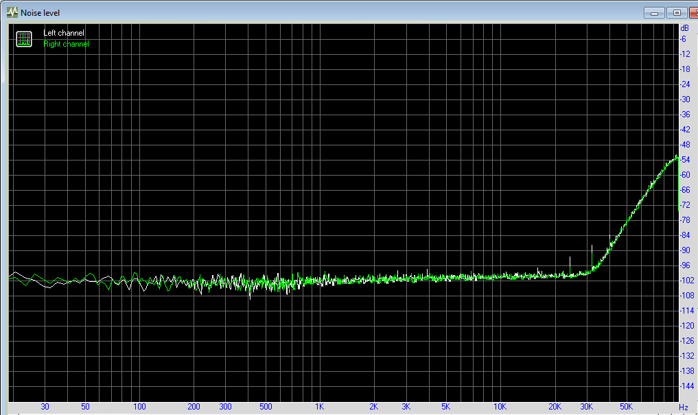

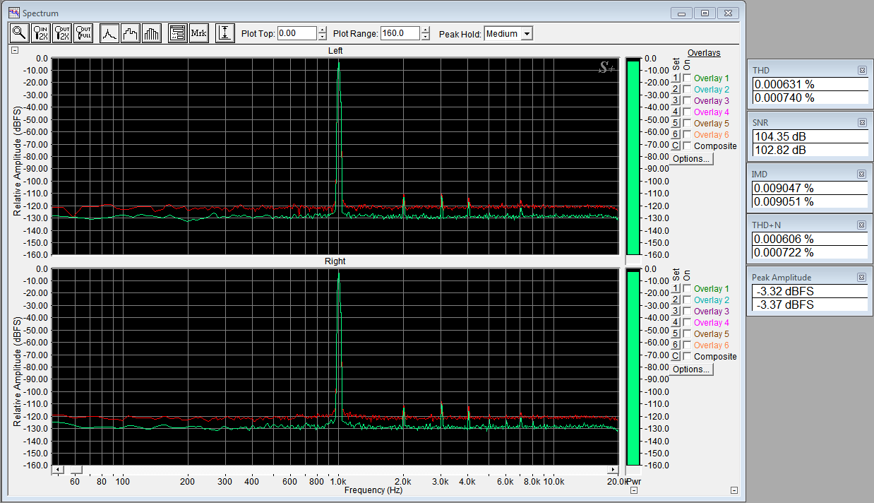

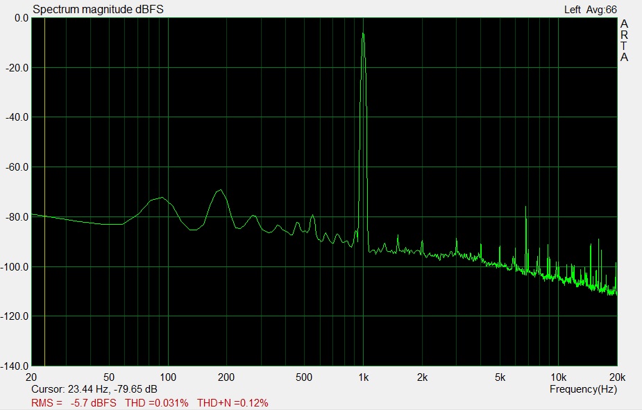

This is SE loopback test, looks pretty normal, Full Scale is about 835mVrms, if I turn the output volume smaller, the 2nd and 3rd will be pretty tiny.

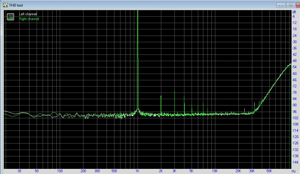

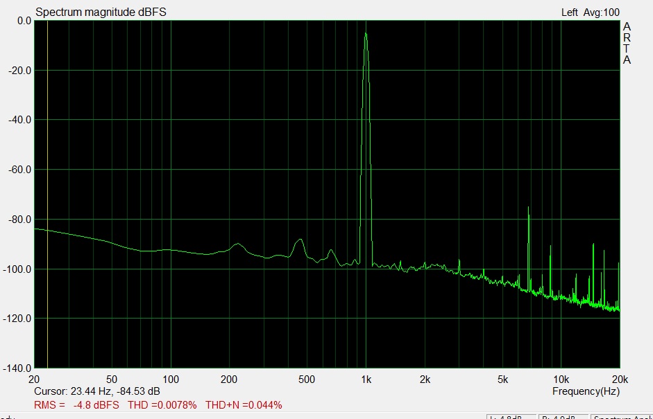

The nasty measurement with high frequency interference, don't know where does that come from. But it's in every measurement I attempt to do. puzzling.

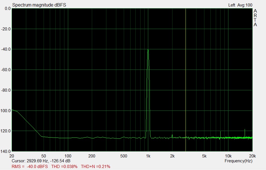

Okay, I did the loopback -40dBFS, some high frequency stuff showed up.
Any metal tins you can put the whole test setup in? My bet is you're getting coupling to the outside world. What does your setup look like for loopback vs the Fiio?

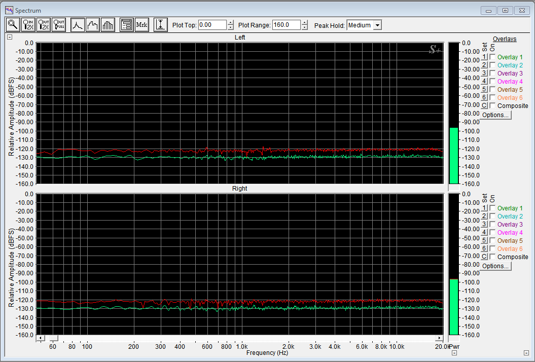

Tried to measure 3 things, Notebook SoundCard, Fiio E17 outside of box, Fiio E17 in Box, all with the connectors in box. Result is similar.

Loopbacks look fine. How does it go with ARTA just showing the RTA without the 1Khz input signal? I'm assuming the high frequency spikes will still be there.
I found that the best thing to do for input of SE to the focusrite 2i2 was to only use tip and ring. hot to tip ground to ring don't short sleeve to ring. Also if you are doing single ended output do the same (ie no sleeve). There does seem to be some sort of ground loop problem in SE mode, though in my case it just manifests as higher 2nd and 3rd harmonic. Better still is to use an SE to Balanced converter.
Tony.
Tony.

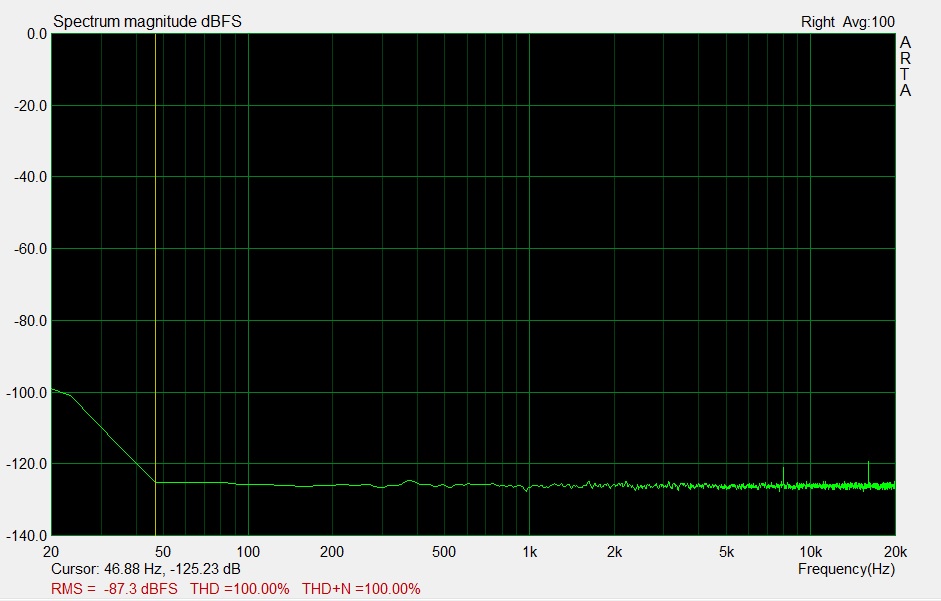

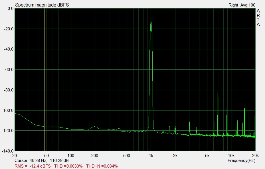

It looks super, but the interference is there, you can see the 7k , 16k peak, looks like the nasty stuff is just hiding.

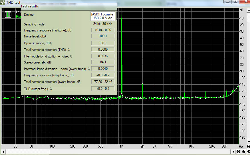

Also if you are doing single ended output do the same (ie no sleeve). There does seem to be some sort of ground loop problem in SE mode,Better still is to use an SE to Balanced converter.
Thank you for the nice tip, do you use BAL to SE on signal output as well? or only use the hot signal?
needtubes said:Can you use the Focusrite 2i2 to measure 2 channels (left and right) simultaneously using the RightMark Audio Analyzer? I am trying to decide between the 2i2 and the Solo, which is definitely mono only.
My loopback measurement with RMAA shows the nasty stuff.

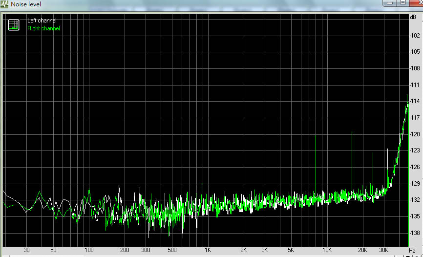

Hmm hard to tell if that 7K and 17K is inherent to your focusrite or is being picked up by the leads. Do you get the same with balanced loopback? Regardless of whether it is coming from the card or not, there are quite a few other noise spikes in the high frequency range that are not there in the loopback.
I think I posted a circuit earlier in the thread for what I used for balanced to single ended on the output. Basically a simple circuit using an LM4562 opamp, though experimentation showed it was more a problem with the input than the output for the performance. Most specifically not allowing earth signal from either in or out to go back to ring on the input (from memory).
link to post with balance to se circuit. http://www.diyaudio.com/forums/equi...2-2nd-gen-measurements-whats.html#post4963930

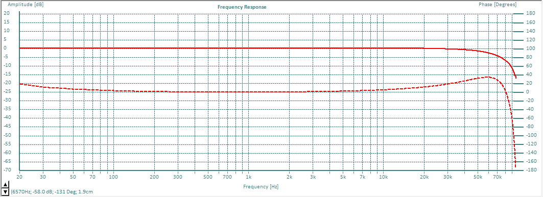

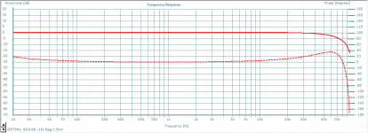

Just noticed this thread and thought some AP measurements might be of interest on the Focusrite Scarlett 2i2 (and RME Babyface Pro).
The sound reinforcement industry where I come from uses the inexpensive 2i2 quite a bit for acoustic tuning. OlegSh is dead right about sweet spots on the gain with these things and I don't have the patience to deal with stuff like that - I want to make measurements without having to think about hardware variables. The RME fulfills this requirement nicely, but at almost 5x the cost. But you also get a much longer useful life and a whole lot less frustration out of RME products. In the long run, I wouldn't be surprised if the RME is cheaper.
The Focusrite Scarlett 2i2 measurements.
The RME Babyface Pro measurements.

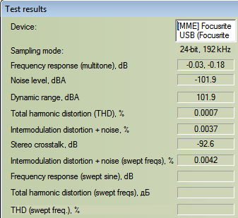

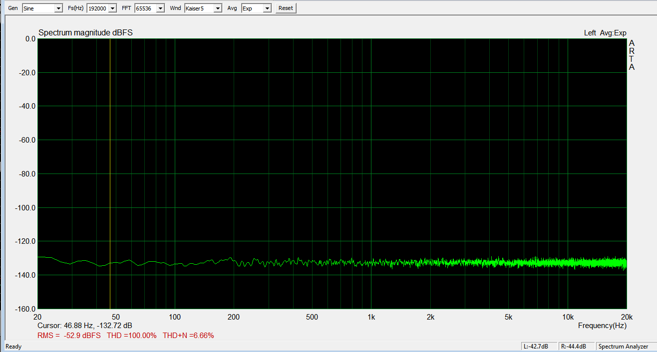

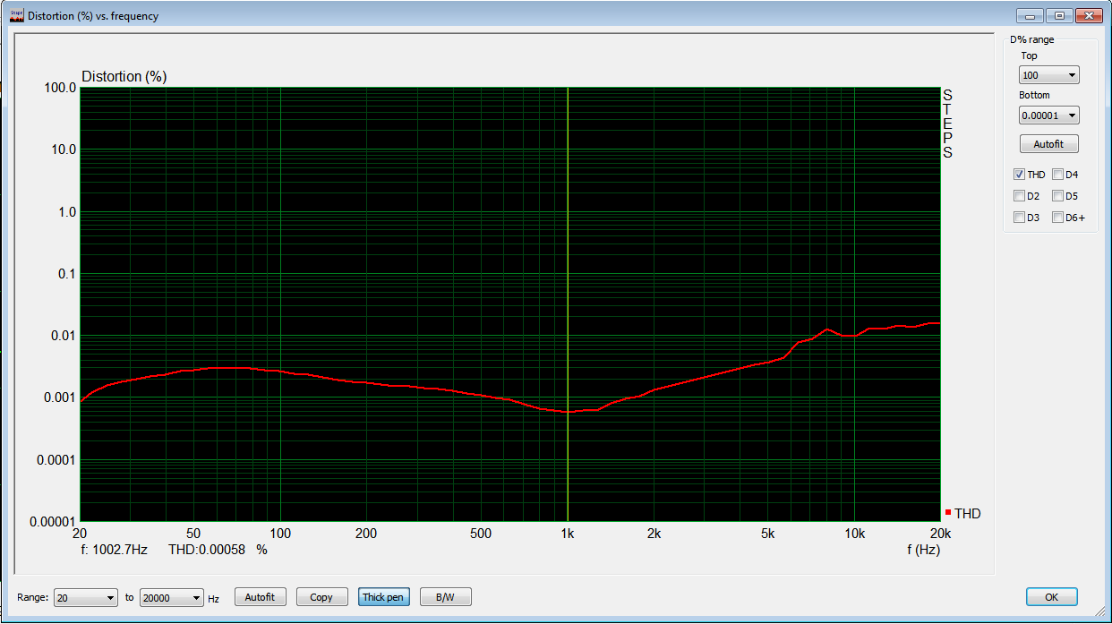

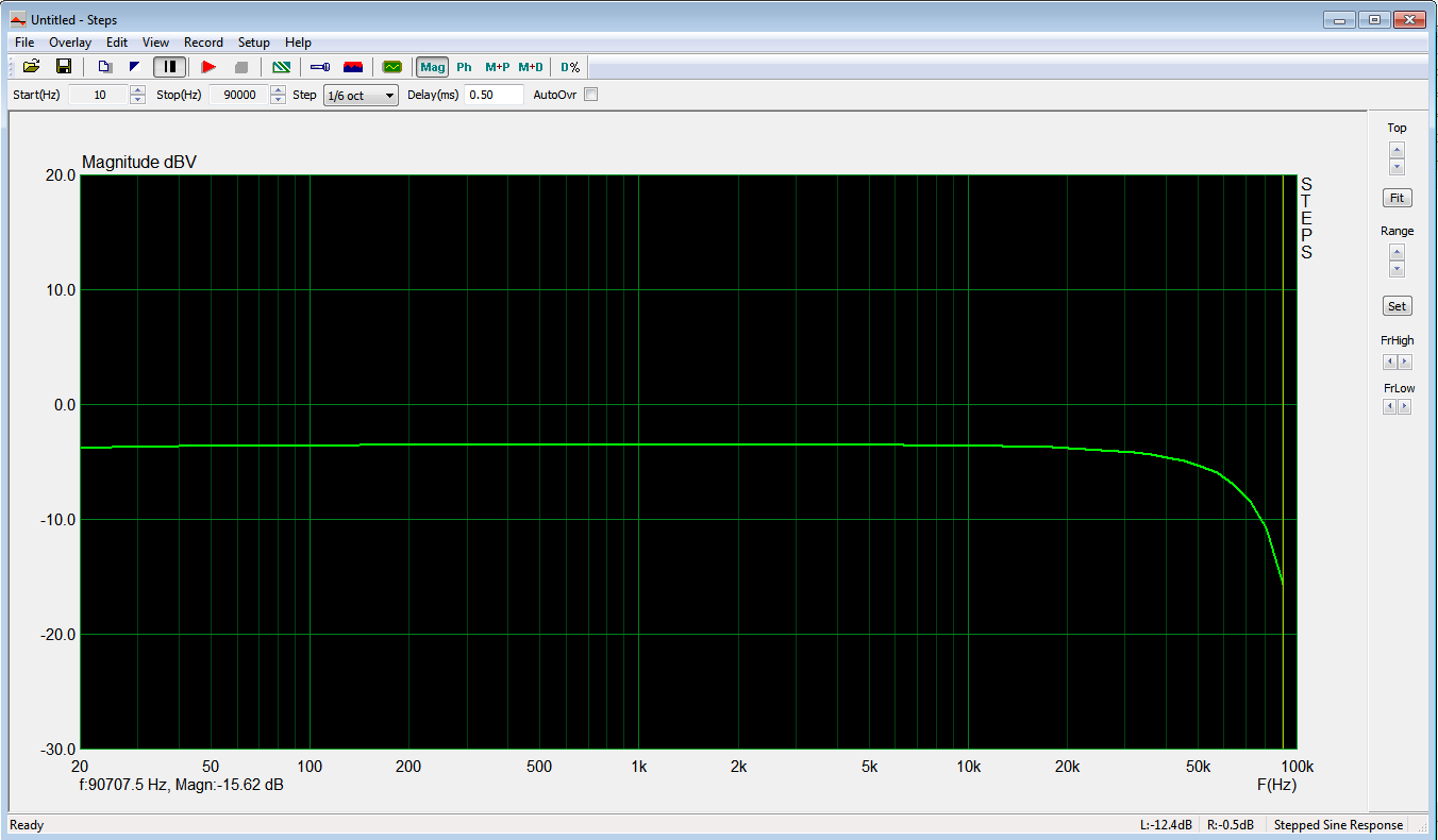

I also have a Scarlett 2i2 (snd gen) and here are some loopback test results for comparison, in case it helps anybody.
All tests were done on Windows 7, sample rate was 192kHz.
Arta settings: FFT: 65536 Window: Kaiser5 Avg: EXP
The Bode vs Phase was at 3dB and was taken with Holm Impulse
All THD measurements were performed at -3dB level.
I used various different programs, and in my experience, I have found that the THD measurement of Arta can sometimes be a bit misleading (the measurements in Arta Steps seem ok though).

Your circuit works super duper, it eliminates those weird spikes. can't thank you enough.
