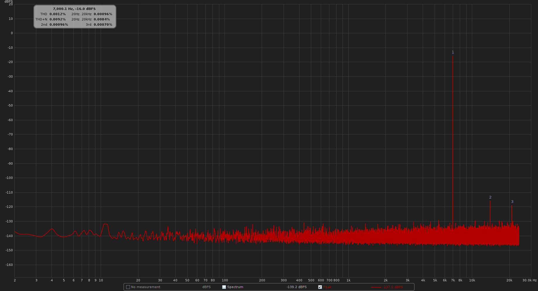

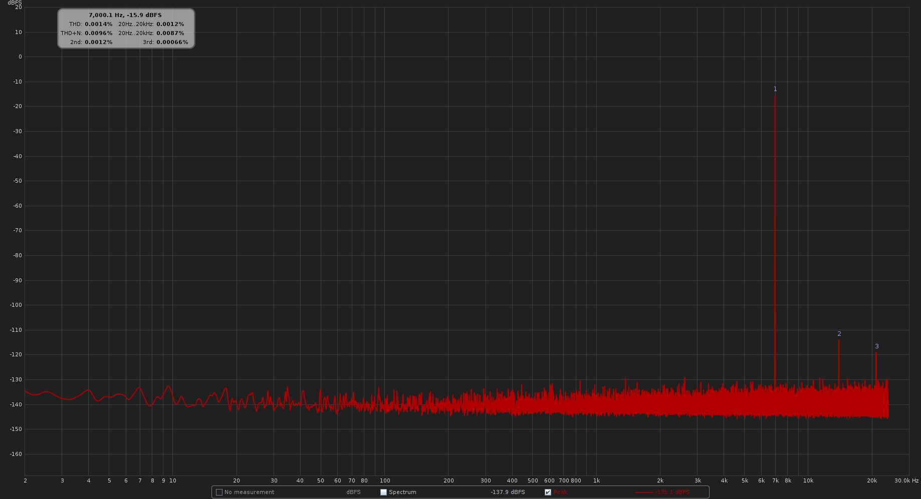

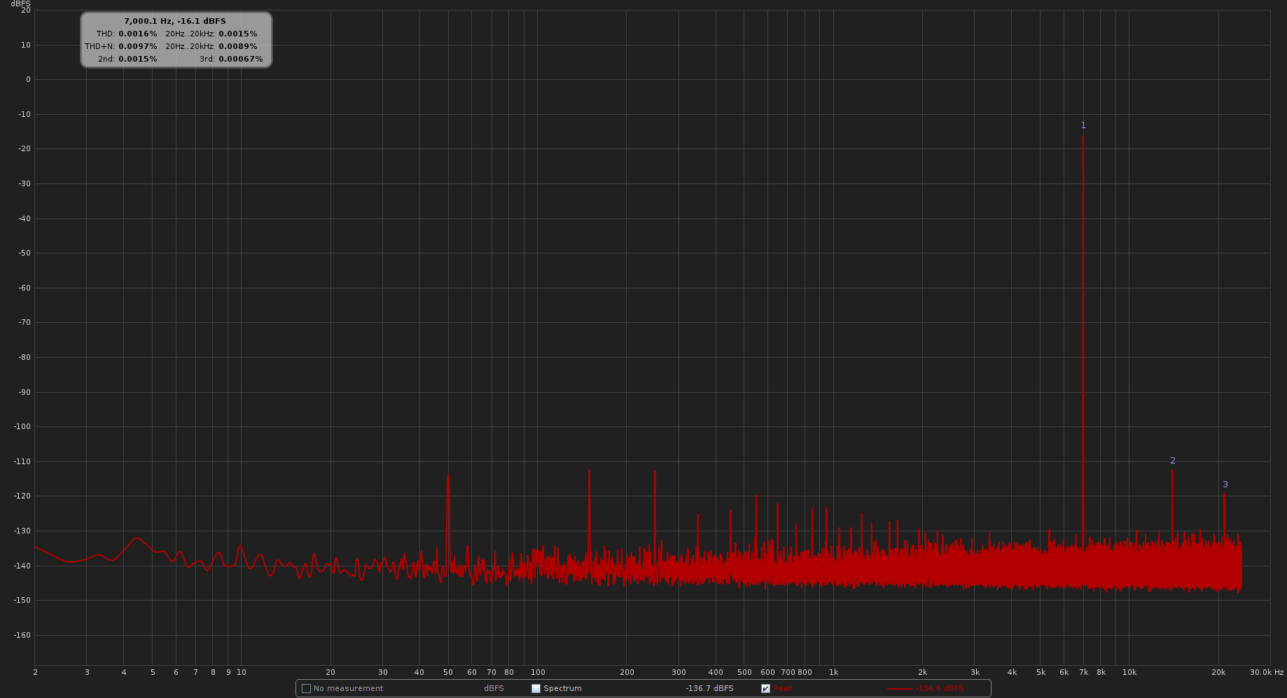

I played with the interface by measuring my head amps. I tried two different setups. First I used diff-to-SE cable (negative signal of the diff. pair is shorted to GND) from the 2i2 out to drive the head amp and SE-to-diff cable from the head amp out to the 2i2 input. As the result I've got a lot of mains harmonics (first attachment).

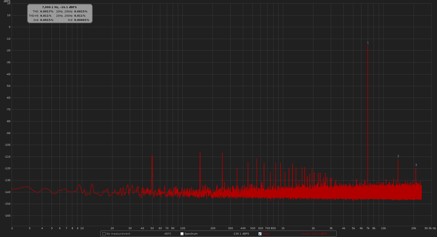

Next I connected differential cable from the 2i2 out to stereo jack of the head amp, so one channel of the head amp receives positive signal of the differential pair and the other channel receives the negative signal of the diff. pair. The stereo output of the head amp drives the diff. input of the interface so the head amp is connected as a differential buffer except that pos. and neg. signals are referenced to the common GND of the stereo headamp. The result is in the second attachment.
The question is if it is reasonable to measure the stereo amp in such a "differential" way. It helps to avoid mains harmonics in the measurement but do I see the true THD of the amp this way? I'm puzzled because I see reduction of the second harmonic in the case of "differential" setup. The third harmonic does not change.
For comparison I also attached SE and differential loopback measurements (third and fourth attachments).
Oleg

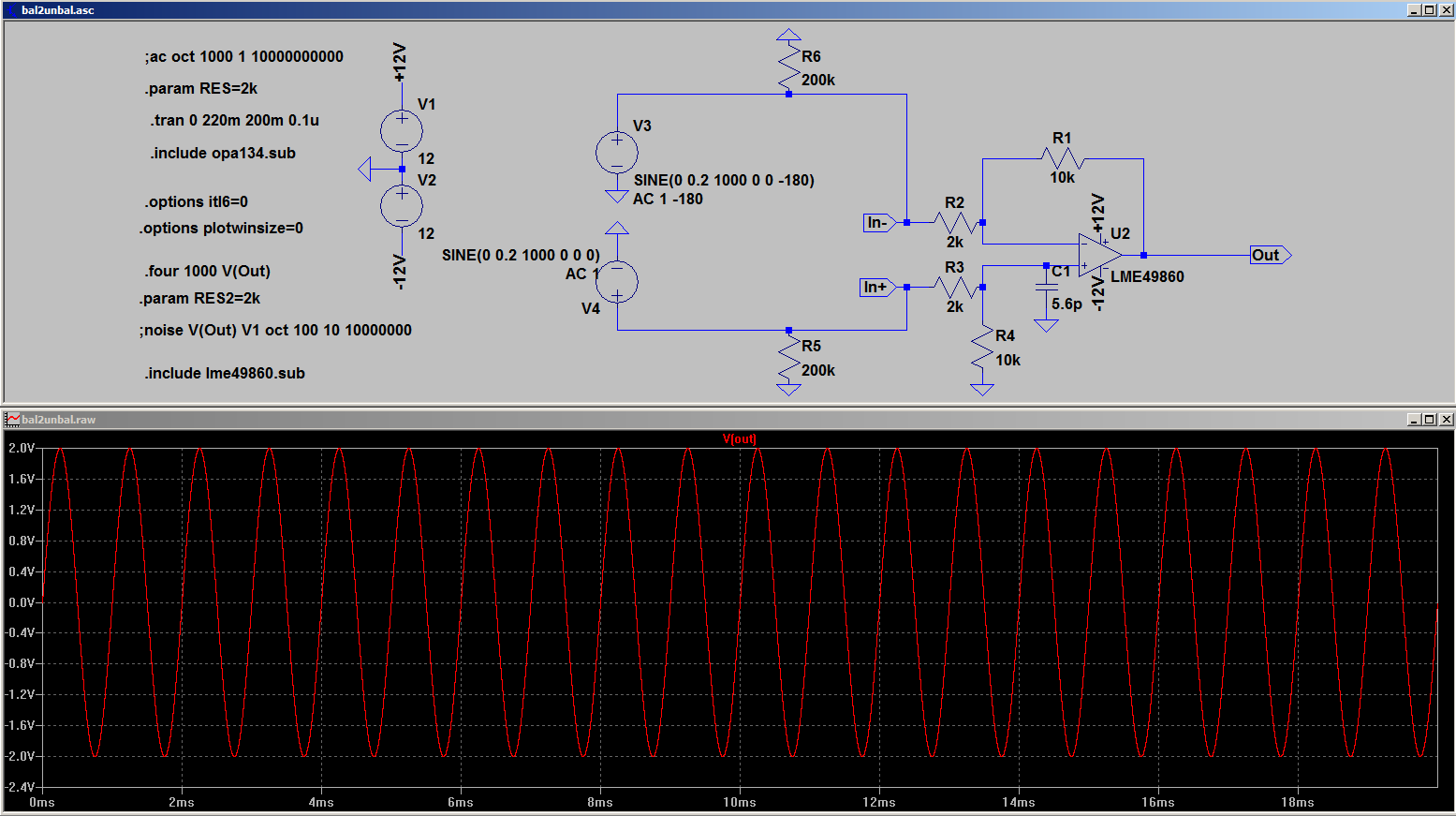

Hi Oleg, were you planning on doing the circuit 16 but changing it for gain rather than unity (actually it doubles) as it is at the the moment.
Not sure whether this will work well or not. Certainly worth experimenting. I originally used 2K resistors to ensure low noise, but have since found that going higher has very little impact, so maybe going to 10K will be easier on the opamp.
Tony.

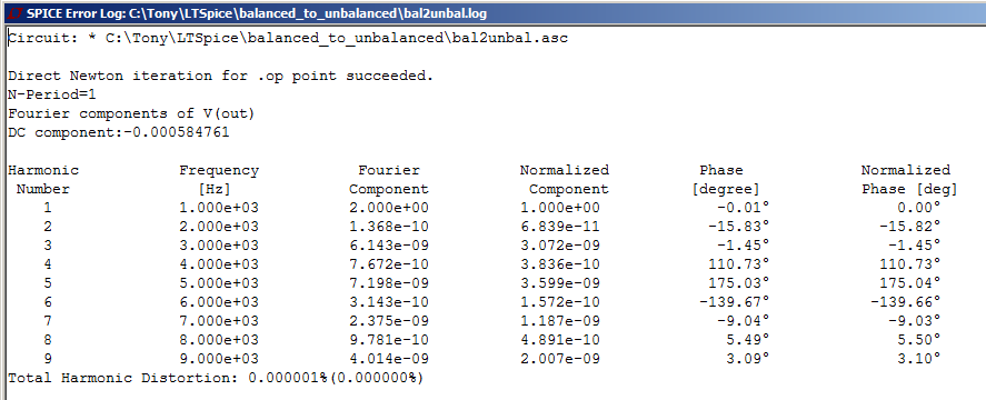

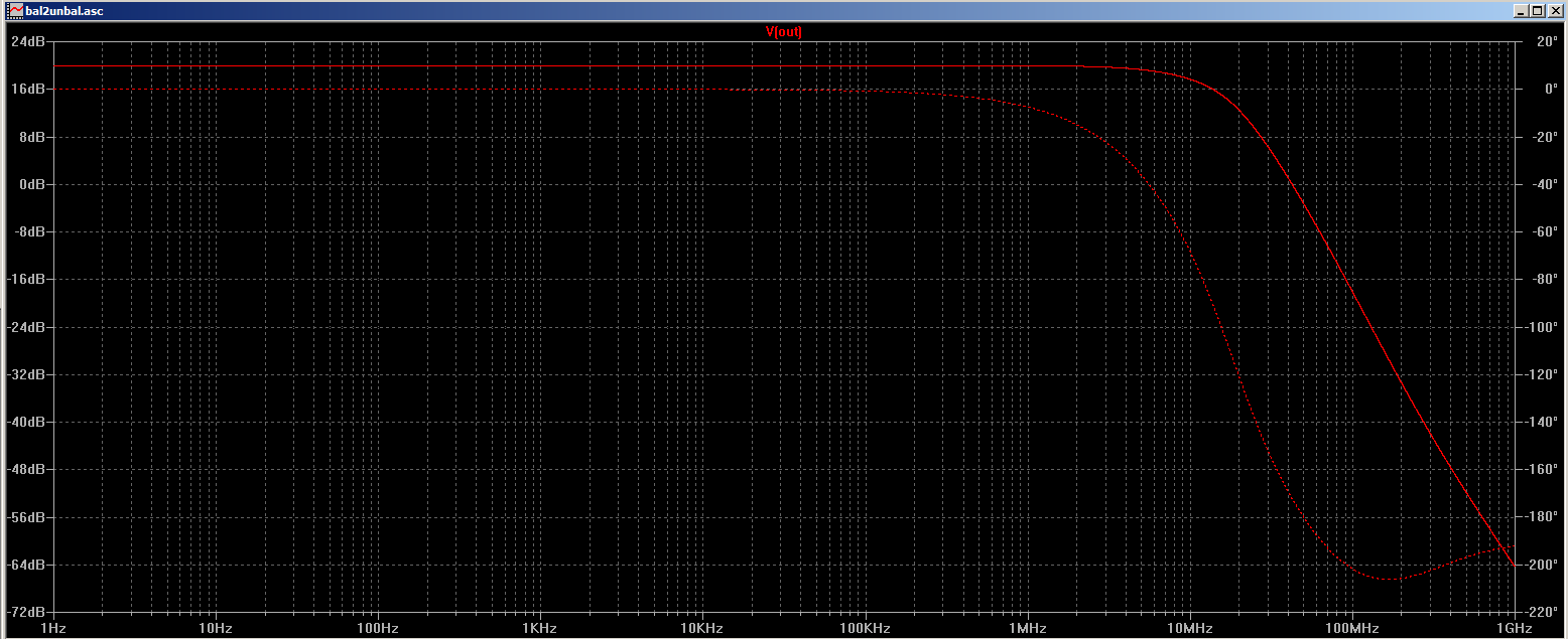

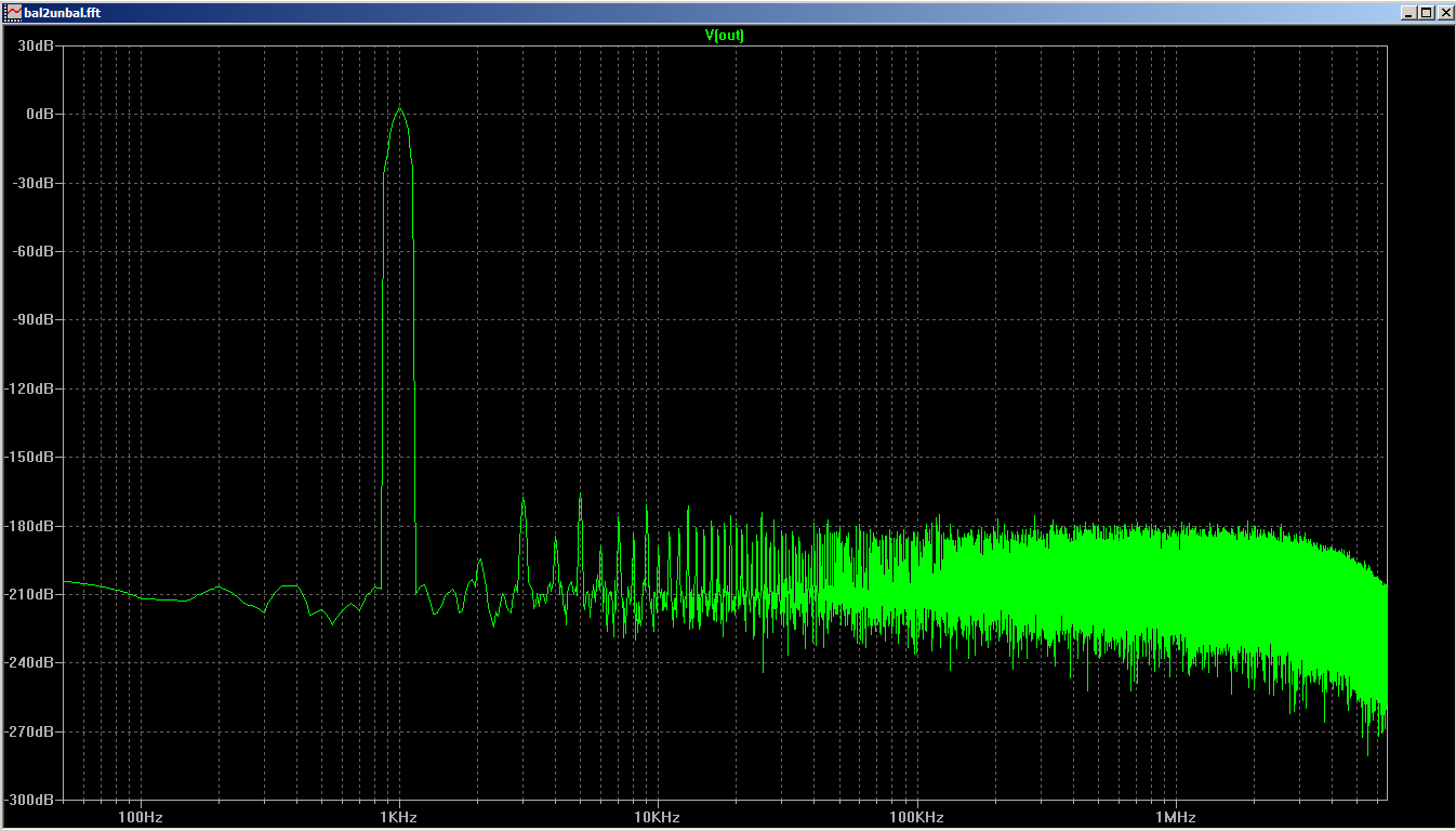

Hi Oleg, I did a sim, and it certainly looks like you can add the gain you want direct to the converter without needing a separate gain stage.
See the attached. It's a great idea, and I will try it myself on my breadboard when I get a chance. 0.2V in 2V out :)
Real world of course won't be as good as the sim, but the sim indicates that distortion should be minimal.
It sounds like they've created a virtual ground, there must be a dc-dc circuit to as usb only supplies 5V . Will be interested to hear the results of any mods you make!
edit: note also that the 5.6p was to stop some peaking in the sim around 20Mhz (with the original circuit). The version with gain does not have the peaking so I think it could be eliminated.
Tony.

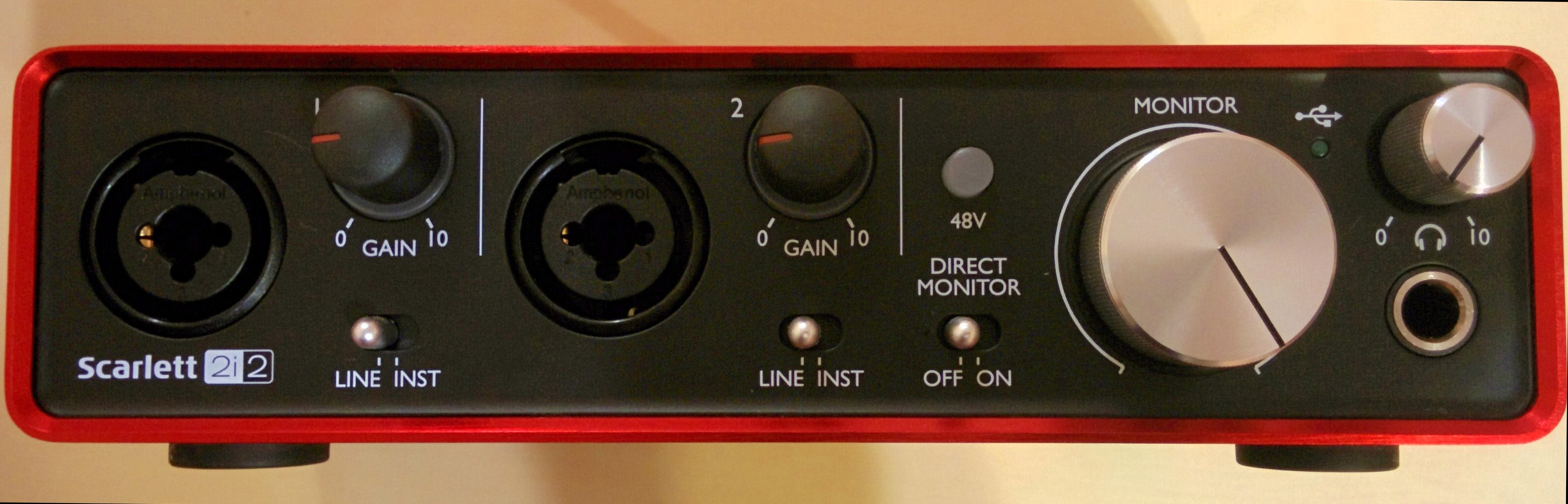

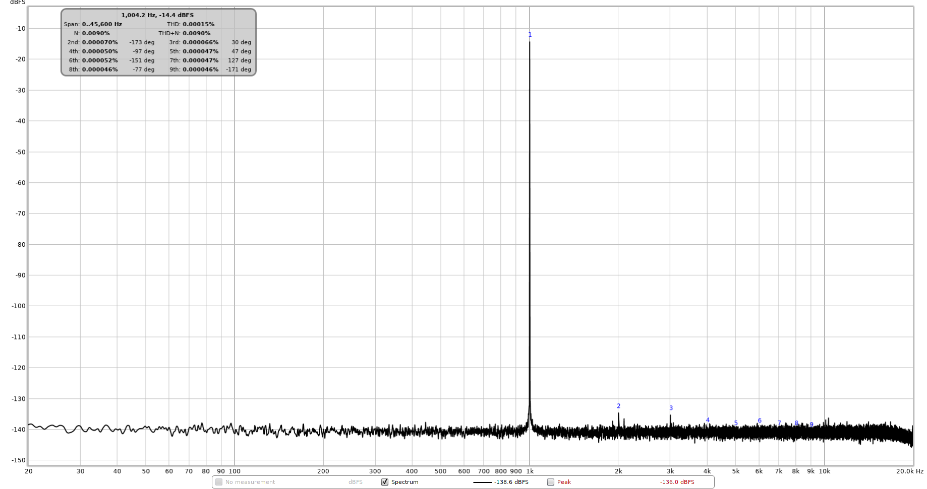

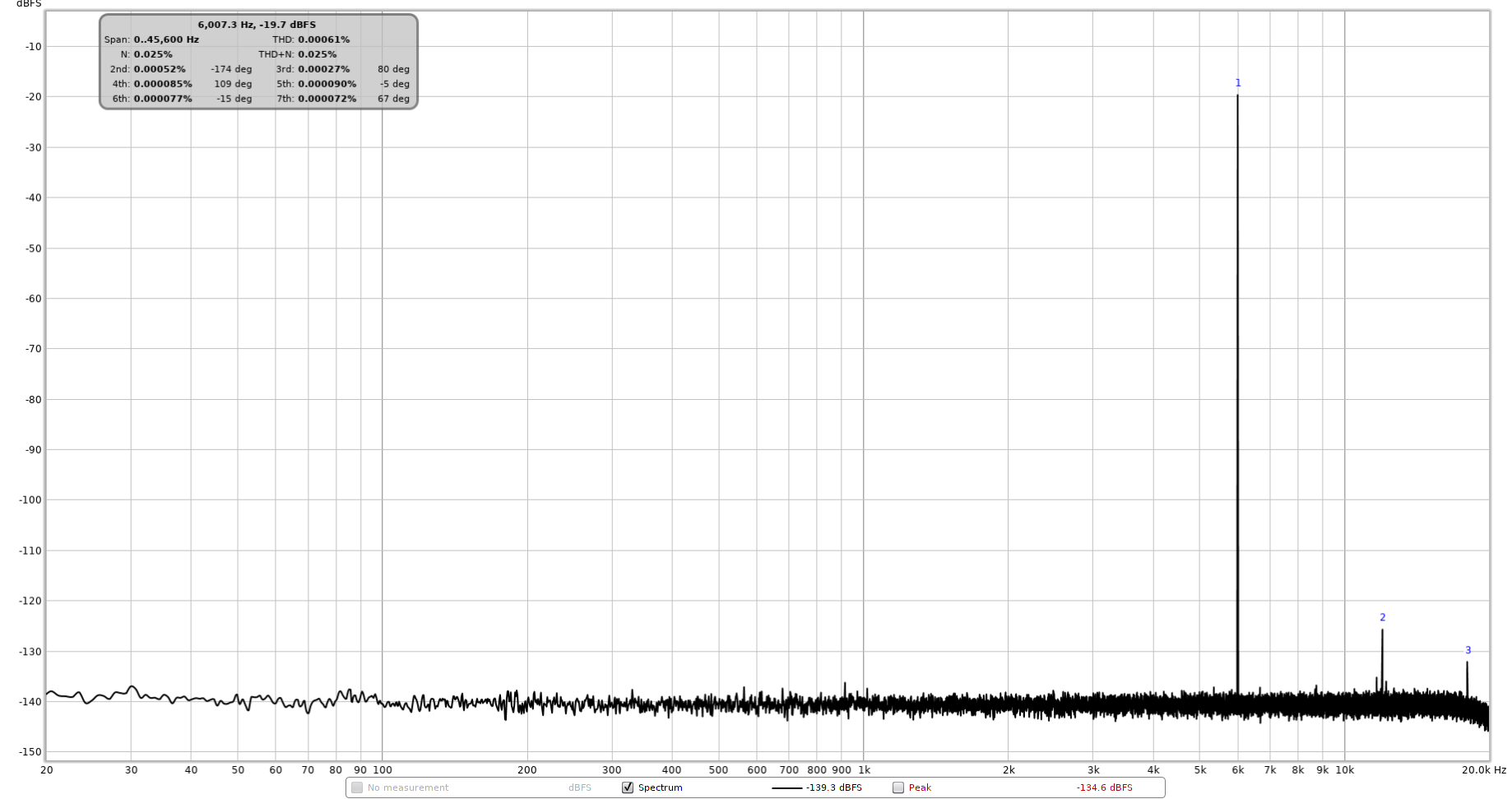

After a bit of testing I can say that electrolytic capacitors at the inputs and outputs are not a problem at all. I tried shorting them (DC coupling) and haven't noticed any change in measured THD and noise floor. I also found a new sweet spot (see attached). The front panel controls are as depicted, the output of the generator is set to -8dBFS in REW, 96kHz sampling rate, balanced loopback connection. This results in measured THD of only 0.00016% which I find very good.

Just bought gen 1, How's the test going?
I just measured -8dbFS, it's about 235mV. so that means the maximum input for 2i2 is 560mVrms?
The front panel I just tried, I think it's gain control for pre-amp, turning it up will only add more noise to measurement.
it's blinking red around 560mV, but arta predict around 800mV rms will be peak input.
Dose that mean when I measure noise floor, it will be referring to 800mV?
So -100dBFS will be 8uV?
I did some test with SE, it was miserable. lucky that I saw this thread :)
