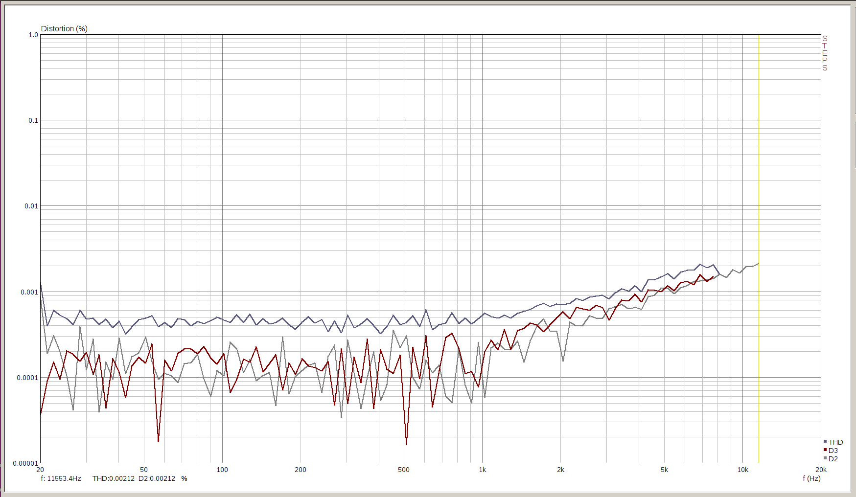

Here is my 2i2 (gen 1) loop back at -10 dB for comparison. Not so good over 1kHz as distortion rises rapidly.

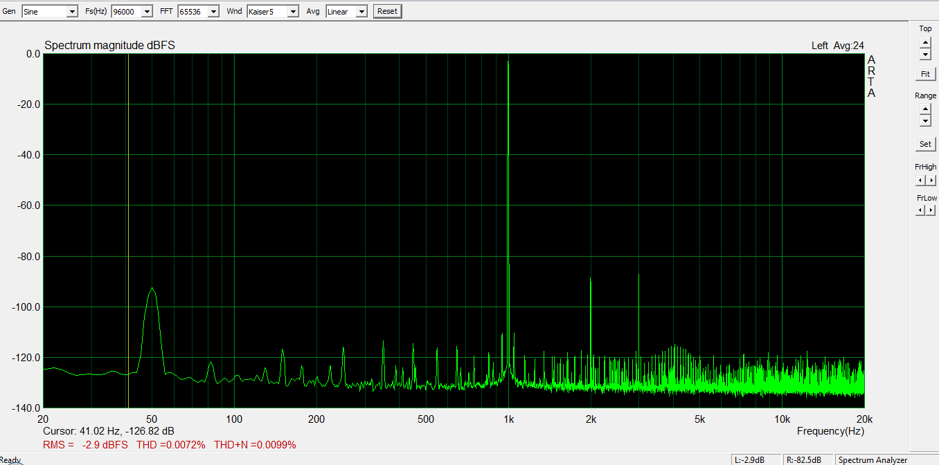

Looks not so impressive, but I can't get even that. I can only get 2nd harmonic of the 10kHz signal. For some reason I can't use sample rates beyond 48kHz. Anything higher and the noise floor makes a step down to -200dBFS past 20kHz. So far I can't find the cause of it but I think it can only be software related, hardware itself can't produce such a low noise floor. May be it is a problem of running Windows application on Linux!? I run ARTA on Ubuntu via Wine.

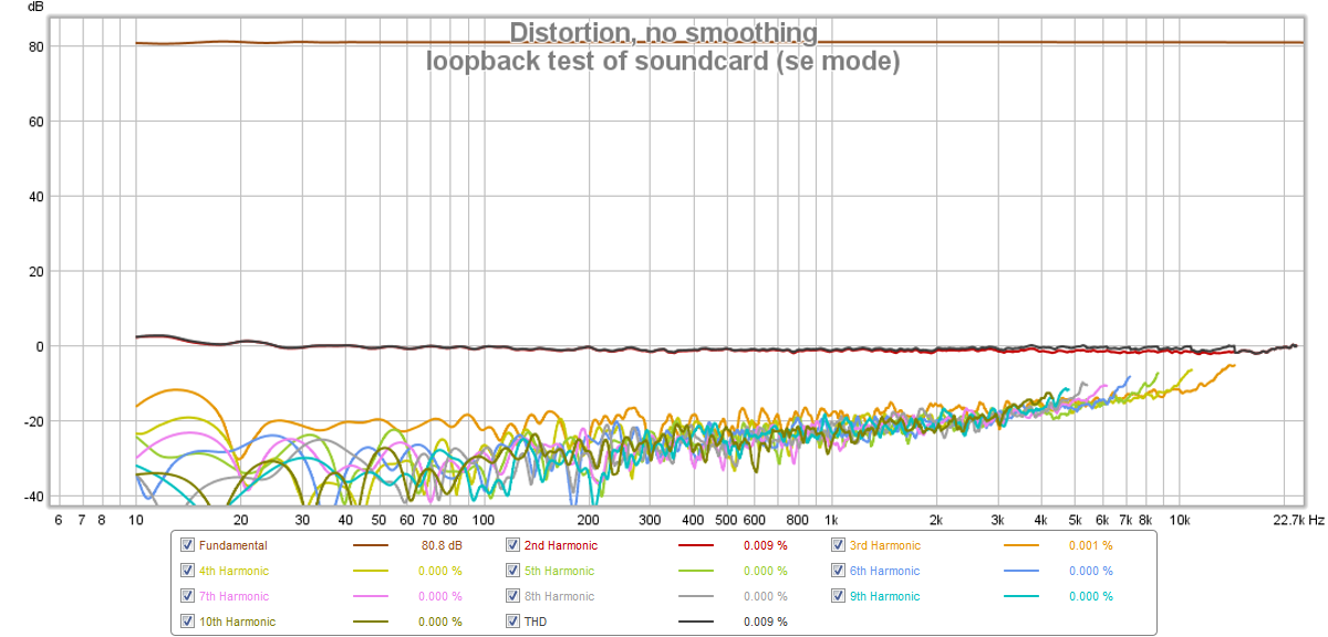

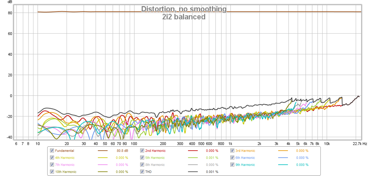

Here are the distortion figures for mine I did a while ago using REW, will have to give steps a try (never used it before). Basically shows similar trend. You can see when doing SE it is a lot worse.
I tried one loopback last night and found same as Oleg, to get NO visible 2nd or 3rd harmonic I had to back off to around -14 to -16 db. I guess this is where notch filters on the output may come in handy?? Or a dedicated very low distortion signal generator.... I haven't had a chance yet to do the proper tests but I have a vague recollection that the performance with the balanced to SE converter feeding back into TR on the input was actually better than the straight balanced loopback.....

Hi Tony,
I played a bit with my unit and indeed the sweet spot for the generator output is -16dBFS, not more and not less. Playing with the input gain or external amplifier allows to squeeze a bit more out of the unit but not too much. Balanced connection has significant advantage in suppressing mains harmonics in my case. In SE configuration I get a lot of mains harmonics all the way up to around 2kHz. With the balanced connection I don't see them at all.
I started putting together an attenuator for the input. Then I figured out that I may need an amplifier for the output. But now I realise that using extra components like filters, attenuators, amplifiers before and after the 2i2 makes the whole thing more complicated and more expensive than it suppose to be. Once you arrive at 300 Euro (and above) total budget it would probably make sense to consider a more serious tool which has most of it built in. For me Focusrite 2i2 was meant for quick and simple tests to see if I haven't screwed up badly. Serious measurements down to 0.000x% THD figures should be done using other tools but that is not so important for me since so low THD is inaudible anyways, IMO. At the moment I just explore the limits of the 2i2 interface and possible performance improvements with minimal efforts. If, for example, changing output op-amps can prevent such a drastic THD rise with frequency or get down by one digit in the overall THD figures I'll consider it justified intervention. But if it only brings insignificant improvements than I'll stop and will just use the unit as is. The more I search around I see that the real performance limiter is the AD/DA chip itself but I still hope that some reasonable improvement is still possible.

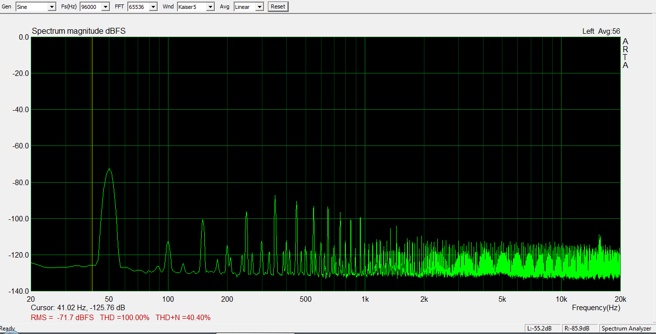

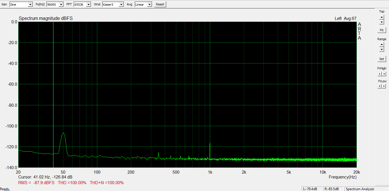

This is a measurment I did with just the input lead floating (ie unpluged from the DAC but still plugged into the 2i2, it's even worse than when connected to the DAC!!! Interestingly though when connected to the DAC but with DAC powered off, the 50 Hz harmonics pretty much disappeared... The weird thing with that one is the 1Khz as I had no generator running.. My old Audigy 2 ZS also does that, ie shows a 1Khz spike with no signal..... odd....

1kHz spike is strange. I don't see such in my measurements. Picking up mains harmonics with floating cable (basically loaded only by the high input impedance of the interface) is probably normal in nowadays urban conditions. When connected to a DAC the cable (say antenna) gets loaded by the much lower output impedance of the DAC and thus harmonics go down. At least this how I see it.
