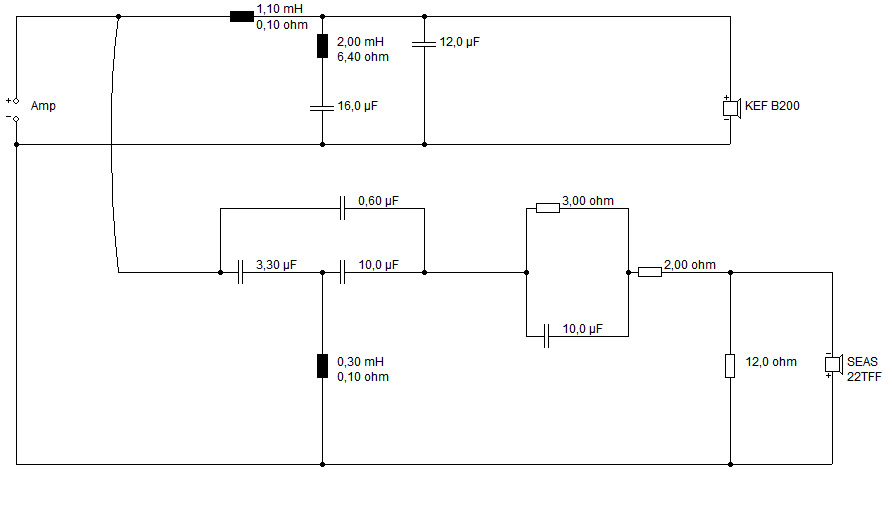

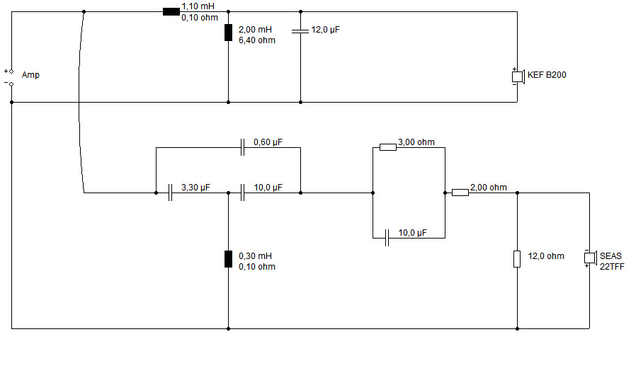

What the 3 ohm and second 10uF DO is lifts the very top end (around 10kHz) by about 4dB. I'd guess this is a T27 thing, where it is falling away. I'm guessing you don't need this. So you omit this section and apply your attenuator. The 0.6uF adjusts the crossover slope and attenuates output slightly. It may do no harm to fit it.
You can be quite clever and use the 3 ohm position as the first leg of your attenuator. You can try 3 ohms and maybe 15 ohms shunt across the SEAS tweeter. It may be that 4 ohms is about right, leading to this:

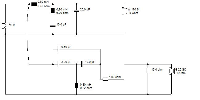

OK, so I only need a single 10uF cap in series with the 3.3uF not the pair. My attenuation is 2R and 12R.
I was just running this past BoxSim. The 0.6uF actually LIFTS the output a couple of dB at crossover. It does something to flatten the tweeter response too, so seems a GOOD THING.
To adjust tweeter level with your 12 ohm shunt fitted, you adjust the 2 ohm series UP to 3 ohm or 4 ohm. This reduces the overall tweeter level in a fairly sensible way.

I've tried it with the 3.3 and 10 and the difference is subtle. You reckon i should add the 0.6 and swap the 2R out for the 3 that I've got?

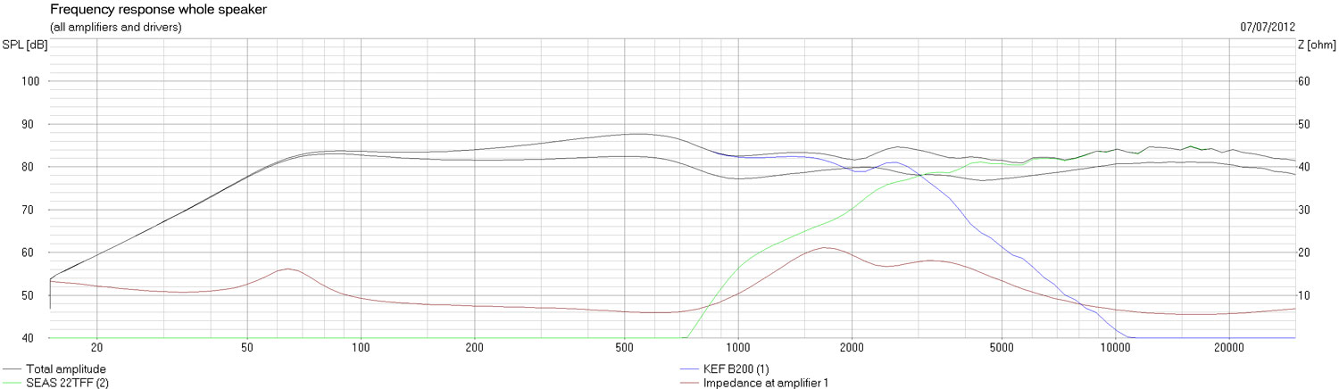

I've run the system through basta and it showed a crossover point around 2.5K, is this what you get with your software?
I'm getting about 3kHz crossover, as it goes.
What it boils down to, is lose the second 10uF, because it isn't helping at all. 12 ohm shunt on the tweeter and adjust between 2 and 4 ohm series for tweeter level. This treble brightness is for your ears alone to decide, because we're guessing on tweeter levels.
Fitting the 0.6uF is really not a big deal, but I quite like what it does, and so do KEF and Falcon, so I'd use it. It gives you a bit more presence around 3kHz. Which is metallic guitar harmonics FWIW.

This is probably a good point to have a review of what has been done and what has been achieved. And very good too, IMO. 🙂
You've got an officially approved decent response from the bass via Falcon.
All that remains is to match it up to the SEAS ferro tweeter which is more advanced (and flatter impedance) than the 7 ohm KEF T27 the crossover was designed for.
You could go second order with 3.3uF and 0.3mH. You can do the full third order 3.3/10uF thing too. The attenuator is one of your variables. You could also try a Zobel which is probably 6.8R + 0.82uF across the tweet. Play with Phase too. Really your ears and familiar music are your best guide now. Listen out for precise stereo image too.
FWIW, your Boxsim plot looks out of phase at crossover to me. It's certainly set up for standmounting rather than close to a wall. Acoustic power response is more a function of dispersion and maybe best ignored. When phase is right, you won't hear much difference as you stoop to listen or stand up. But all crossovers lobe a bit.

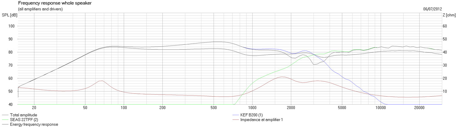

The tweeter is out of phase with the B200 which is what causes the big dip in the plot at 3KHz.FWIW, your Boxsim plot looks out of phase at crossover to me. It's certainly set up for standmounting rather than close to a wall. Acoustic power response is more a function of dispersion and maybe best ignored. When phase is right, you won't hear much difference as you stoop to listen or stand up. But all crossovers lobe a bit.
This is what the plot looks like if the tweeter is wired in phase.

Having had some more time to play with boxsim, I am confused as to why falcon & Kef choose to wire the tweeter out of phase as it seems to create a big dip in the response at 3k. If i built the crossover exactly to design the response at 3k is down by around 10dB.
You'd use your ears to decide in practise. Turning the speakers upside down and wiring IN PHASE should give you something reasonable at equal distance from both drivers which is above the listening axis. The sim I did with a W200S makes it OUT OF PHASE with 5cm difference in acoustic centres at 3.5kHz. Wavelength being 10cm. 3rd order filters are good at aligning phase on a flat baffle.

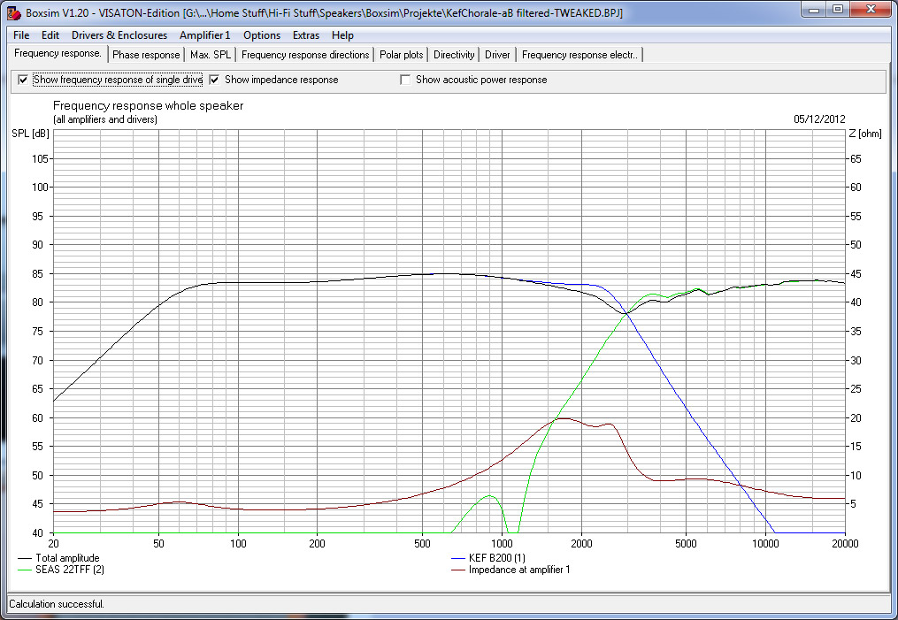

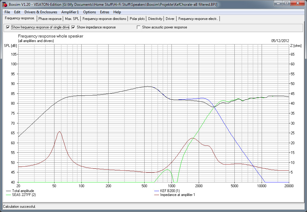

Been having another look at the simulations from boxplot on these. Corrected the big dips in the response with the tweeter out of phase. (due to driver placement on the baffle not being set correctly)
This is the current crossover setup:
and it's simulation, with a large "hump" in the mid range:
Taking the 16uF capacitor out of the notch filter results in a much flatter plot (taking the whole notch filter out isn't as flat):
I'll have to admit that i cannot hear this large hump in the mid-range, but i still find that they can sound quite bright even with the attenuation. I have noticed that the bass response is much improved when it is simulated as a closed box vs ported. Is there any easy way to close the port easily? Presently is is fully stuffed with dense foam matting, but that doesn't seal them. (and according to boxplot sims, a stuffed port has even worse LF than both open ported and closed box)

Any ideas?
