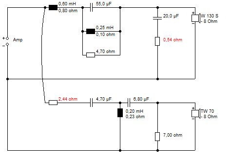

Onto WaveInform's notch/trap question. Traps are better IMO, because they avoid low impedance. Obviously any filter which uses resistors is going to lose some efficiency, but traps are brilliant. I use this calculator to work out series or parallel LCR filters for Q and frequency:
Alan Yates' Laboratory - VK2ZAY's Engineering Calculators - LCR Resonance
Once you have a working circuit, you can adjust Q with resistor value, or changing L and C as long as you keep the product constant. It gets easier with practise. 🙂

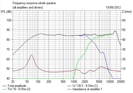

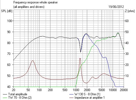

Here's how I fixed the awful 1300 Hz resonance of the Visaton W130S 5" woofer. The deep notch is created by taking out the resistor. This lets you see exactly where it operates. Another technique is to notch a particularly nasty resonance with a TANK, which is a capacitor and resistor across the bafflestep coil, but it does nasty things to impedance at high frequency and is a last resort.
One of the nicest speakers I have ever simmed. A tiny little 12L design with everything right about it. You should visit Visaton and download BoxSim. The Visaton Casablanca III model would interest anyone trying to build a 3 way.

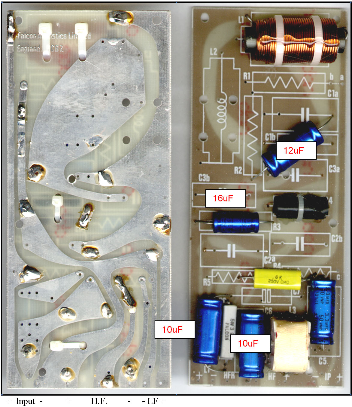

Well i've ordered all the bits for these spaekers. Gone with the Falcon kit and -3.5dB L pad for the tweeters. I'll take some pictures of the crossovers when they arrive and attempt to draw up a schematic so we can compare it to the original KEF SP1015.
I've now got the instruction sheet for the falcon 37K crossover. It doesn't look like it completely follows the original kef design, but i reckon that is to do with their "advanced butterworth filter" for the HF. If the kit comes with bipolar electrolytics, should i stick with them or would it be beneficial to swap them out for MKP? Also it states that the tweeter should be phase inverted as the chorales were, AFAIK my speakers have been running in phase and have sounded fine, should i invert them or leave them? (or is it a case of pick whichever i prefer?)

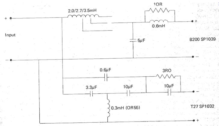

On a flat, non-time aligned baffle it is surprisingly and impressively phase aligned. I'd expect the Falcon offering to resemble the tweeter section of the KEF 104ab below. The upper section, Zobel or notch, is second order.
For all that, some work remains to be done getting a SEAS ferrofluid tweeter to resemble the KEF T27 exactly. But doable, I feel. 🙂

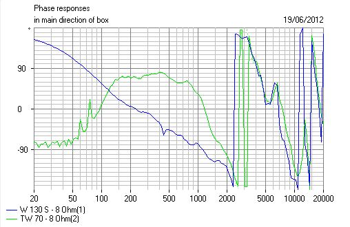

On reflection, the phase issue is actually to do with how deep the bass unit is. On shallow small ones like the W130S or B110 you probably wire 2nd. Order Bass and 3rd. Order Tweet in phase. With deeper stuff like a B200 it works out as out of phase. This is because the wavelength is quite short at 3.5 kHz.

Here's the way the Falcon crossover is going to look with your SEAS attenuator:
I'd guess you will lose the 0.6uF and the 3 ohm/10uF sections. That's a bit KEF T27 specific.
Oh wait, Falcon have slipped a 12uF in there. Not a big deal, but wait and see, eh?

Fitted the crossover that i built yesterday and compared the two. (initially i wired it up wrong with the Tweeter connected to HF - instead of HFR meaning it only went through one of the 10uF caps) Now it's correct, I cannot believe that i managed to live with it the way it was before as the old crossovers give an extremely sharp sound. Not too sure on the notch filter, might just take some getting used to as I've lived with these speakers as they were for a long time. (resistance measured correctly so I believe they will be filtering as they should)
I'm not quite following what you are doing here, Kei. 🙂

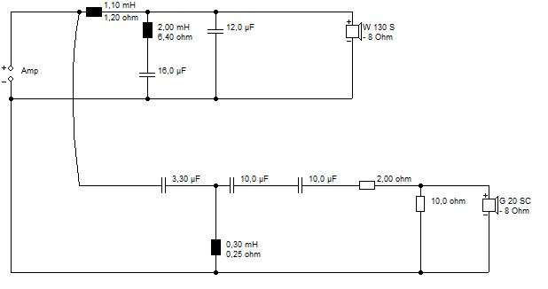

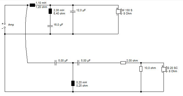

Are you currently at the highpass layout in the first diagram? Two 10uF in series makes a 5uF, which isn't where you want to be with a butterworth IMO.
It's not far different from the original KEF Chorale design which is a bit sub-optimal, as shown in the second diagram. You generally only use identical capacitor values when the input filter is attenuated with 6 ohms resistance or so. Otherwise it's a 1:3 capacitor ratio (3.3uF and 10uF) for a filter with no input resistor. This avoids a peaky filter.
I've built the crossovers to match your first diagram. (2x 10uF in series with the 3.3uF followed by the L pad)
Yup, and that's not good! 😀I've built the crossovers to match your first diagram. (2x 10uF in series with the 3.3uF followed by the L pad)
The original KEF Chorale tweeter filter with two 5uF capacitors and 0.2mH was excellent for a valve amp with an output impedance of 6 ohms, but for solid state 3.3uF and 10uF and 0.3mH is better.
The exact details depend on modelling, but for sure, the second 10uF is not helping your cause unless you add a 3 ohm in parallel.
