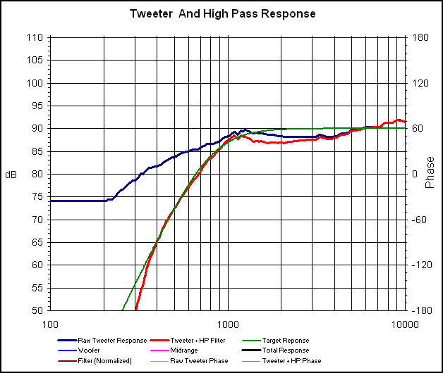

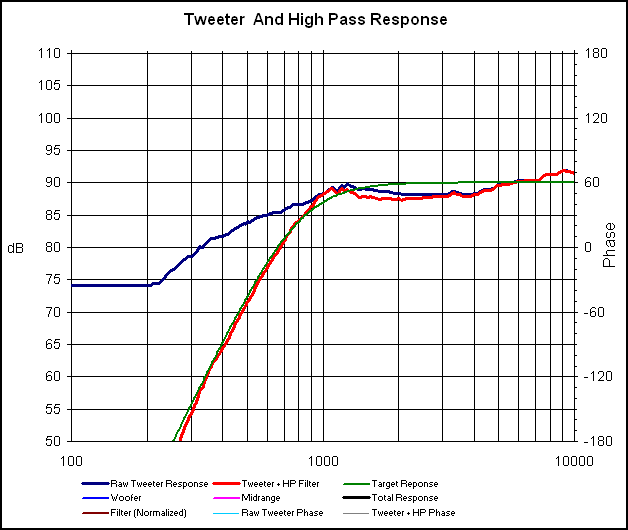

First. A graph with a 4th order high pass. The green line is the target - Linkwitz-Reilly 4th order roll off. Had to play with cap and inductor values a little to get a good match.

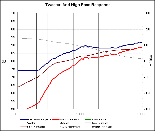

panomaniac said:Here's the response, phase and filter plot.
You can see that the 1st order filter gives a long slope.
To clarify, that's actually an acoustic 2nd order slope. If you want to achieve an acoustic 1st order rolloff with a single cap, you need a flat raw driver response far down to lower frequencies. In fact, there are few high-frequency drivers that can be used for acoustic 1st order.
