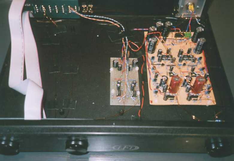

My own present linestage is a 100k Panasonic pot feeding an AD744/LM6181 combo with - 3 - feedback loops. Sounds very sweet and smooth.
(The alternative path in the same box is
a 389-based FET buffer).

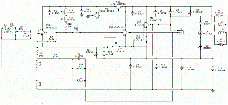

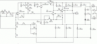

The BUF-634/AD-744 is only on hard copy However i have posted a newer Headphone Amp Based upon Walt Jungs Multi-Loop Feedback articals in 1998 EDN" Walt's Tools and Tips"
this version is Based upon a pair of Gutsy and extreamly articulate sounding Buffer that some have called Too Hot in the High End. However this quality is perfect for the normaly Dark sounding Portable Devices it is used with. However on Quality Cleen recorded SACD's and DVD's the involvement is captivating and Draws about 27 MA of Quesent Current. However I can't stand this amp un My computors MP3's via a Audigy with AD-8620 opamps replacing the 4558 types installed from the Factory. In this case the less Hot sounding BUF-634 sounds better in this Amp than the HA-5002 But if a cleen and potent High end that seems to extend forever beyound what Humans can hear and the Ability to resolve the last Bit of imfromation from High resolution Sources then the HA-5002 is my choice. Eather way the same Topology works with eather.
Sonicaly the AD-8610/20 are Better than the AD-744 evean using the comp pin. the resolution is improved over the 744 with the 8610 and the Dual AD-8620 is alot better sounding that the Dual AD-744 the AD746. With the 746 lacking the ability to use the comp pin since that is unavailable on the Dual. Plus the 8620 runs on about 2/3 the current of the Older Analog devices part.

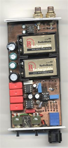

What it Looks Like
This is what the Innered's of the Amp based Upon the Previous Schematic looks like.
This Amp Has and AD-8620 soldered into a DIP socket and then pluged into another Dip socket upon the Board. The Volume control is the 9 mm Bourns 51 series conductive plastic, Generic Low Z Electrolytic's. and Wima MPK-10 Polypropylene Bypasses.
