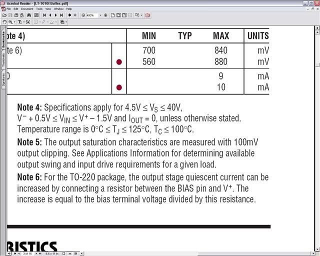

LT1010 - A great TO220 Output - For Small Amplifiers with real Drive-Potential
So is formula - I=1.10/Ohms - ????
22Ohms x 0.050Ampere= 1.10
when we set the bias for the LT1010
Better to be clear about it.
We can not take for guaranted everybody is going to download the Datasheet, just to get the more accurate formula.

/halo LT1010 - A great TO220 Output - For Small Amplifiers with real Drive-Potential
😎 LT1010 - A great TO220 Output - For Small Amplifiers with real Drive-Potential 😎ppl said:the sound of the LT-1010 buffer are way better than the specs would indicate this is a very Dynamic and articulate Buffer.
The Buffer should be operatted High Bias by a 22 ohm Bandwidth resistor
If Enough heatsink is available real strong Class A Bias is possible but be careful
but 50-60 Ma is possible with enought heatsinking.

So what is the formulappl said:electrode10101> I also thought that Op Amps in the Metal can and the Cer Dip Packages sounded slightly Better than the Plastic versions. why this is so i do not Know. Maybe Capacitence of the Different Packages or somthing.
for setting the bias current in LT1010
Maybe you just did not see my question?
ppl
/halo - is waiting for answer - so are others, maybe
