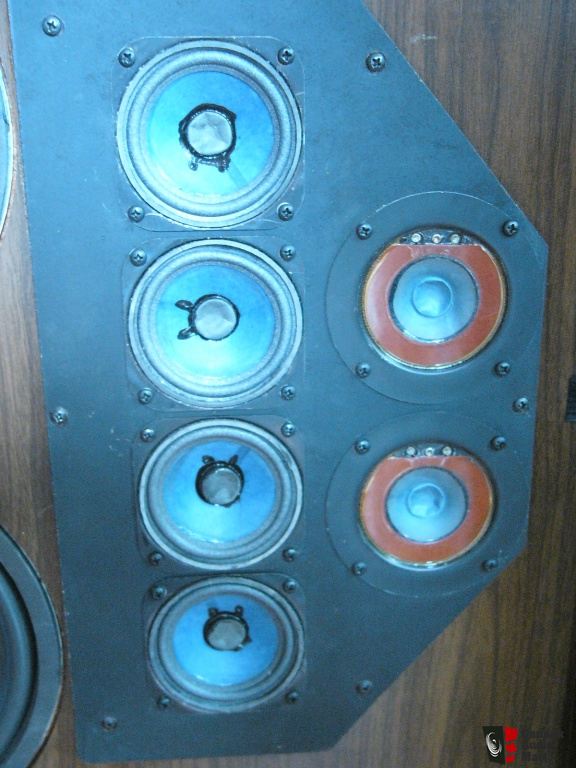

If you want the ultimate in midrange clarity / dispersion / and sensitivity
It would be the good old fashioned way of using multiple drivers.
Plenty of 4" 5" fullrange drivers will cover this, But...
If your really really concerned about beaming.
Your more likely looking at at least 3" or smaller 1.5" drivers
for superiority around 3 kHz to 4 kHz
Then again that will start imposing on your 300 Hz lower bandwidth
Would probably be looking at 3" driver
And for good sensitivity/ power handling
You would likely do a line array of 4 to 8 drivers.
Definitely steering away from a single driver solution.
But thinking the same thing myself for the ultimate midrange.
I keep going back in fourth between 2x = 4" drivers or 4x to 8x = 3" or 1.5" drivers
Main goal was similar to yours to have a high 3K to 5k crossover to reduce tweeter distortion.
likely have 2x tweeters to reduce distortion.
SPL not the concern for the tweeter.
But obviously when Using 3" or 1.5 " mids
sensitivity and multiple drivers
a must.
All though not a cutting edge design by todays standards,
The Marantz Imperial 8 or Marantz Imperial 9 is still a feasible concept.
Using multiple small mids and multiple tweeters for sensitivity / dispersion
and reduce distortion at high SPL.

Four 3" drivers playing up to 3.5kHz would beam like single ~12" driver on the same frequency, on the stacking axis. The "beaming" problem is in the physical dimensions, need to keep small compared to wavelengths. If phase/beaming problems are to be avoided using multiple drivers sharing same bandwidth on flat baffle seems counterproductive, although might sound good enough. Develop and idea how to stack multiple drivers into small enough physical dimensions and you end up with MEH. MEH narrows the low frequency dispersion but is able to widen the high frequency dispersion. While it might be rather narrow nominal dispersion overall, the beaming can be avoided.

No, two drivers in parallel will have +6db compared to one driver.
+3db for double Sd and +3db for half impedance
I am referring to why Juhazi is using 2 pcs of 4 ohm driver in series versus a single 8 ohm driver of the same model. Both are 8 ohm loads but one is 3db more sensitive than the other. It effectively doubles the driver cost though. This is the approach that many hifi speaker manufacturers uses, 2 X 6 inch driver versus 1 x 8". The issue is sensitivity is very critical because if your mids are 88db. Your woofers need to be about 94db to match the mids because of baffle loss. Hifi woofers don't reach 94db sensitivity... so this is the way to get around the issue.

Another way of looking at it is since if you put 2 X 4R in series, power will be reduced to 1/4. So output is down 6db but having two of them, it is up 6db. So it is back to original sensitivity, except it is now 8R. Of course another way of doing it is just use a 4R speaker of course. I suppose nominal 8R is preferred for hifi purpose....
