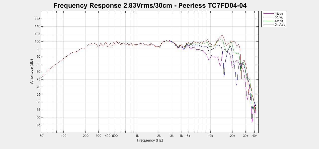

It's not that simple, it also and largely is related to the cone depth, shallow cones beam less than deep cones for the same diameter. So your way of determining it is just not true. But it is true that cone diameter is a factor.
Nope.
It's almost exclusively related to diameter (and by diameter I generally mean from the top of the surround (surround mid-point) from one side to the opposite side, NOT from frame edge to edge.)
What you can alter is the overall dispersion pattern, or how it beams. A common trick here is "spreading-out" the dispersion of a driver with a rising high freq. response with a phase-plug (or a dust cap that acts more like a phase plug).
..and a semi-exception to this is a decoupled dustcap or whizzer (..and the whizzer variety often also makes use of a phase plug - though by the time you extend out to 45 degrees or more the response typically drops like a stone at higher freq.s.)
The TC7FD04 is a small efficient cone (considering it's bandwidth).
Subtract 10.5 db to get its 1 meter result.
(dave)
