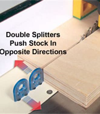

I have added the Micro Jig splitters to my Delta saw and they are quite effective at eliminating pinch-out kickbacks. There are two splitter fins installed with a supplied jig so that the front one is even with the fence side of the blade and the back one with the outside of the blade. Used in a zero clearance insert they greatly reduce the risks of rip cuts.
