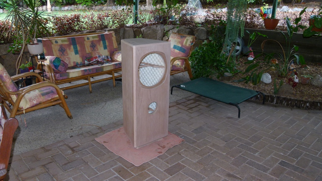

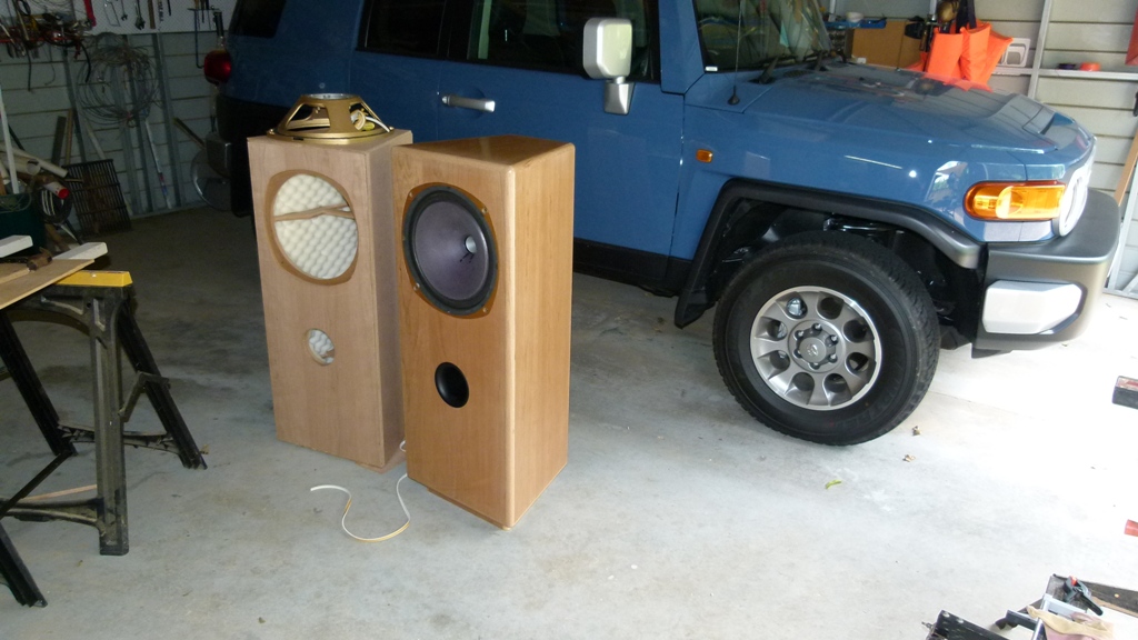

I totally agree , just think what you're doing , know your tools . measure twice or more and use sharp blades . I managed to build ALOT of things with an old Ryobi tables saw bought for $247 NZealand dollars in 2003 . I used it to renovate my house in Rotorua and cut firewood with it for 2 years . In 2005 when we moved to Australia I build this lovely Tannoys with the Ryobi . I still use it today , but bearings are a bit gone , parts still available online for cheap !
Enjoining the Tannoys every day !
Cheers ,
Rens

Those Tannoys are magnificent!

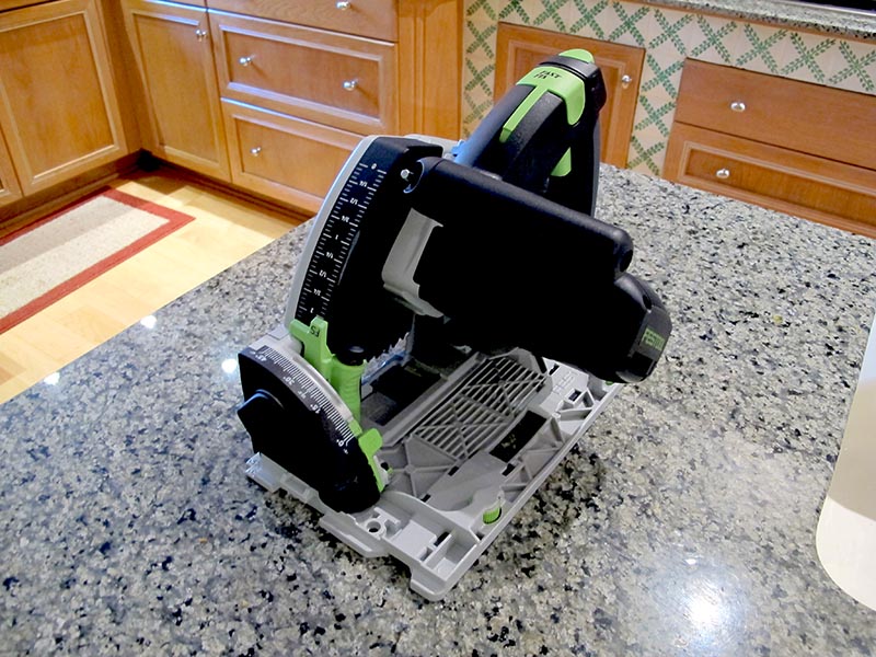

The gents at the tool shop suggested a track saw. I had always been interested in them, as it affords you lots of flexibility and more precision cuts than the typical rip board with a circular saw. The dust collection issue I was told could be solved by using a good vac on the saw side itself, and placing the cut material on top of an XPS sheet, which prevents the dust from blowing out the bottom. Also may help with tear out.
If you're considering not going with a table based saw, and have the ability, the track saw is worth a look. Makita makes a nice one that isn't too rich. They don't do everything a table saw does, but for bigger projects, it could be better than an undersized table saw in some ways.
If the track saw seems too pricey, and you're considering a circular saw, there are a few products that allow a circular saw to be converted to a track saw, as well as some DIY videos/articles that show how one can make their own track.

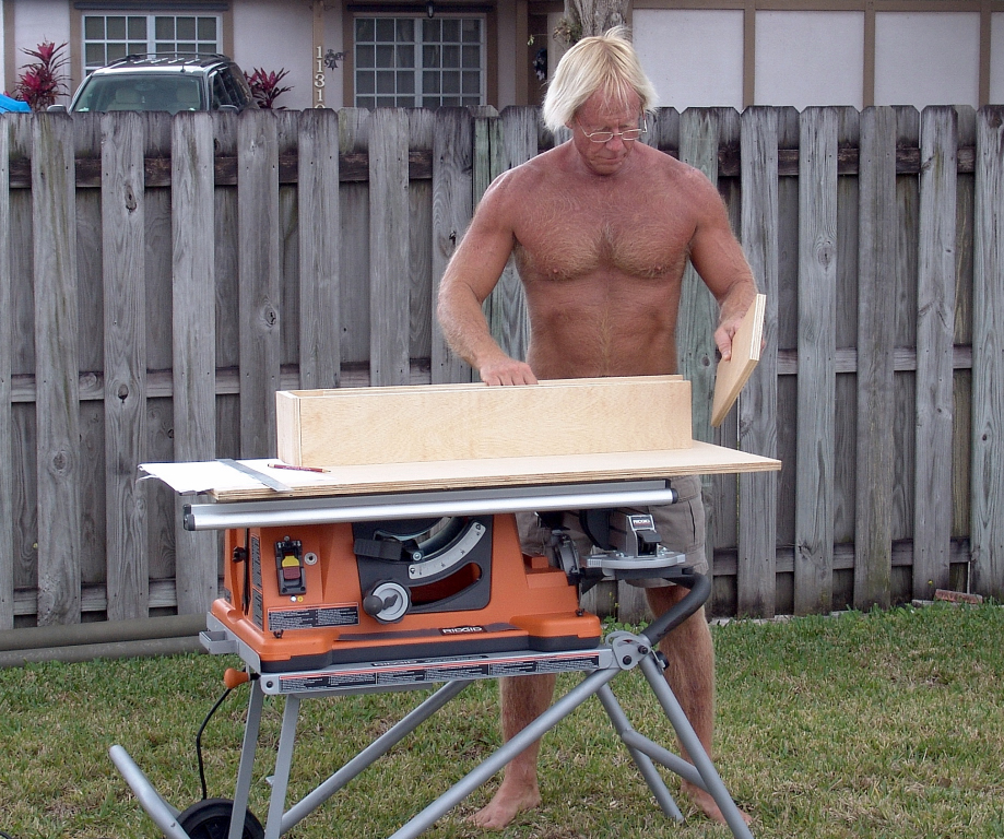

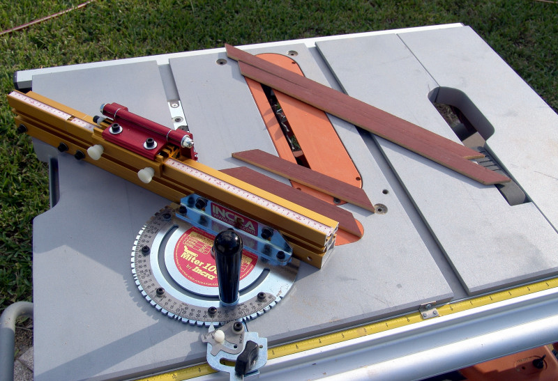

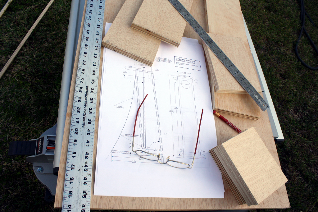

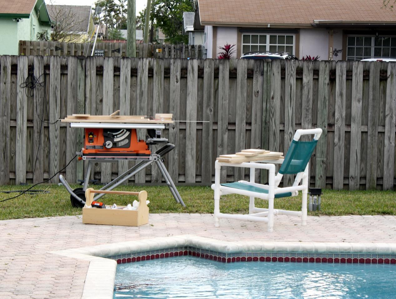

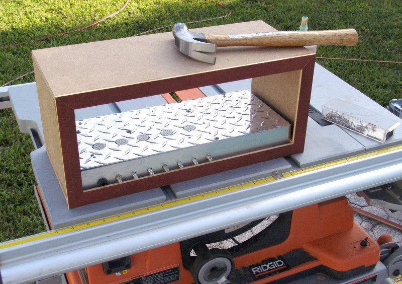

I have the same saw and have used it for nearly 10 years. I was lucky enough to get mine for $279 on a Black Friday sale.
It can be folded up and stuffed into a corner of the garage, and it does a decent job. I got a $100 INCRA from Amazon for miter corners on faceplates. Does it work as good as the 5 HP monster in the wood shop at school? No. Does the quality of work that an average craftsman like myself get out of it compare with the work I got from the school saw? Yes.

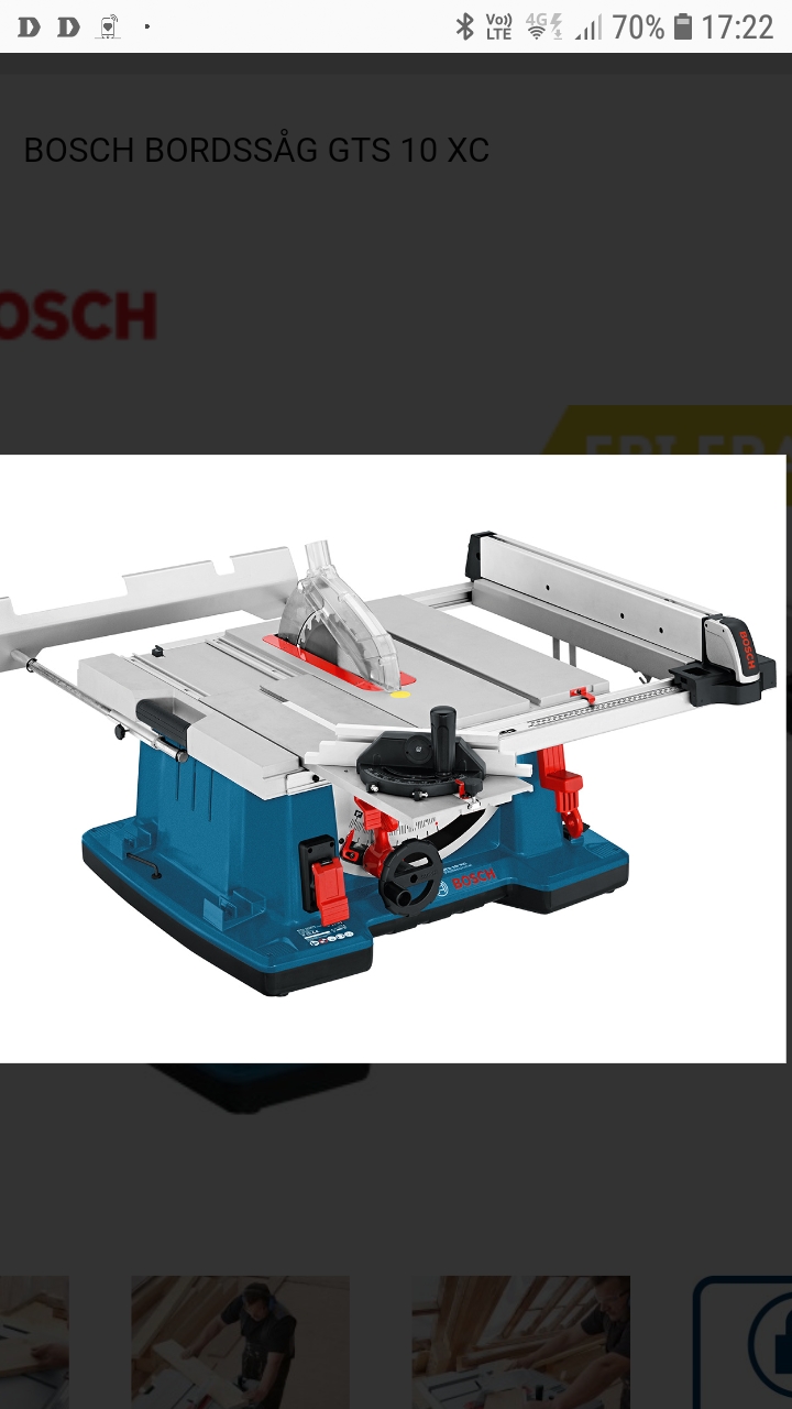

I've got Bosch GTS 10 and GCM 10.
Works great with perfect precision, but I always doublecheck
When cutting angles.
The tablesaw is built in to a bench so I will be able to cut whole boards 2.40x1.20 m without problems.
Figge
Forgot to say that 60 or 80 teeth blades cuts nice !
My only complaint is the miter stop is inconsistent, sometimes it will set correctly at 45 degrees, and sometimes not...it shifts off position when I tighten the clamp lever. Do you have that issue? Other than that I love it.
