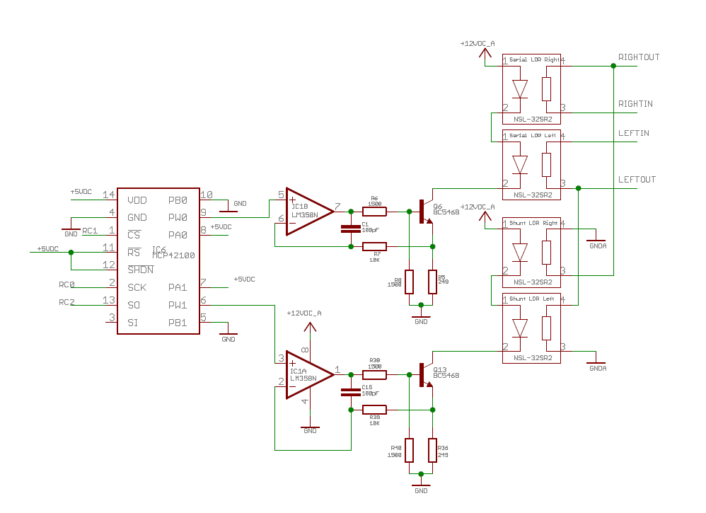

I have tried to operate the LDRs from a dual digital (!) potentiometer, which is followed by a VCCS (see attached images).
But it does not work.
The initial values of the serial resistor (8k5) and shunt resistor (45 Ohm) look good, but when I increment the input to the digital potentiometer by a value of 1 (resulting in an in increase / decrease of about 19mV to the input of the CCS),
the LDR's resistor values resulted in 1k6 for the series- and 46 Ohm for the shunt-LDR - which is an absolute NOGO.
Fenris would you please be so kind and publish your LM134 schematic?
Best regards - Rudi
