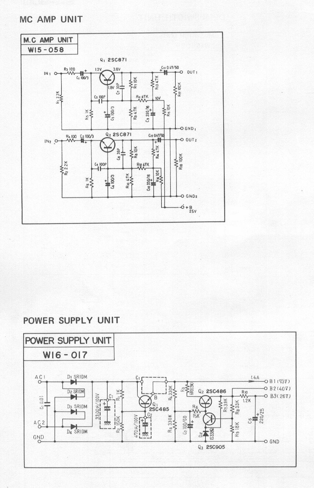

Q2 emiiter is less positive than its collector, voltage drop between the two being 0.757v
whilst not strictly with a negative DC bias, it is never the less less positive than the
collector.
collector.
Yes, but that stage does not have a base connected straight to ground - unlike your circuit. For an NPN BJT to act as a transistor, it is not sufficient for the emitter to be less positive than the collector - it also has to be less positive than the base so the base-emitter junction is forward biased. As far as I can see your transistor simply has two reverse biased junctions so unless one or both of them enters reverse breakdown it plays no role in the circuit at all.
Well explained, Thanks. I will see what I can do to remedy.

Your circuits certainly speak volumes, for those who can read a circuit diagram.

Seriously, what a load of bollocks. The way the LED is connected does not in any way affect the sound. Maybe your perception of the sound because you believe it to be better without doing any objective measurements. For all that hassle you could have just used a potentiometer, which would have better tracking (even with the cheapest examples), and none of the low level distortion that LDRs produce.
You don't need any chokes in a linear power supply, in fact they're probably producing some nasty spikes across the rectifier.
Your circuit is probably the most nonsensical one that I've ever seen, stop using Oregano and start using SchemeIt or something web-based that produces acceptable looking schematics.
Seriously though, read up on proper audio design, Elliot Sound Products would be a good start.
