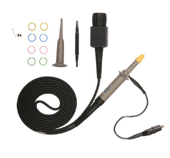

Very satisfied Rigol DS2000 series scope owner here. Glad I bought, would buy again.
However,
There are a few annoyances. Number one on my list is the Rigol-made, Rigol-branded probes. Have a look at the kit, taken straight from the Rigol sales page:
What don't you see?

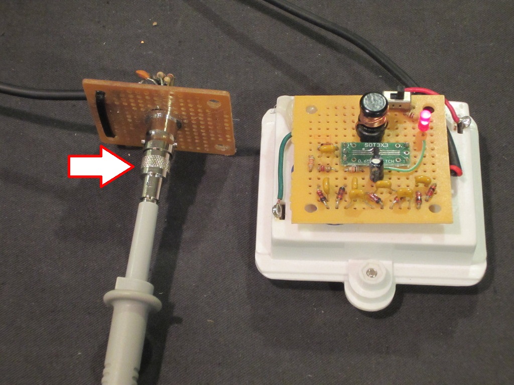

That's right, you don't see a BNC adapter that lets you plug your probe straight into a BNC female jack without a pigtail + crocodile clip GND attachment. The gizmo I'm pointing to with a red and white arrow here

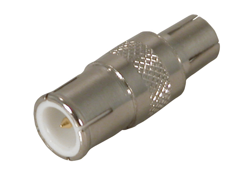

Furthermore, the Rigol probe's GND sleeve is much smaller diameter than "industry standard" so the aftermarket BNC adapters (like THESE, qty=10 for $35.00) don't fit. So I swallowed hard and bought a couple of aftermarket, non-Rigol probes that are the industry standard size and that do fit BNC adapters. They work fine but the extra expense chaps my hide .

Are you telling me that industri standard probes does not fit into the scope or that i have to buy new better ones?
The ground clip looks very short, to short?
Silversweden,
I think you misunderstood Mark.
Probes will of course fit the scope. Problem is, in the other end, when you connect probe to a BNC adapter.
Why wouldn't you use a bnc cable instead of a probe in this case? The cable has less inductance issues, are cheap and easy to find. The only thing I can think of is ease, you don't have to switch out the probe with a cable.Silversweden,
Silversweden,
Thanks, now i feel really stupid 😀
Why wouldn't you use a bnc cable instead of a probe in this case? Less inductance issues, cheap and easy to find.
BNC cable add capacitance. That adapter let you take advantage of a dividing probe.
Good to know! Thanks!BNC cable add capacitance. That adapter let you take benefit of a dividing probe.

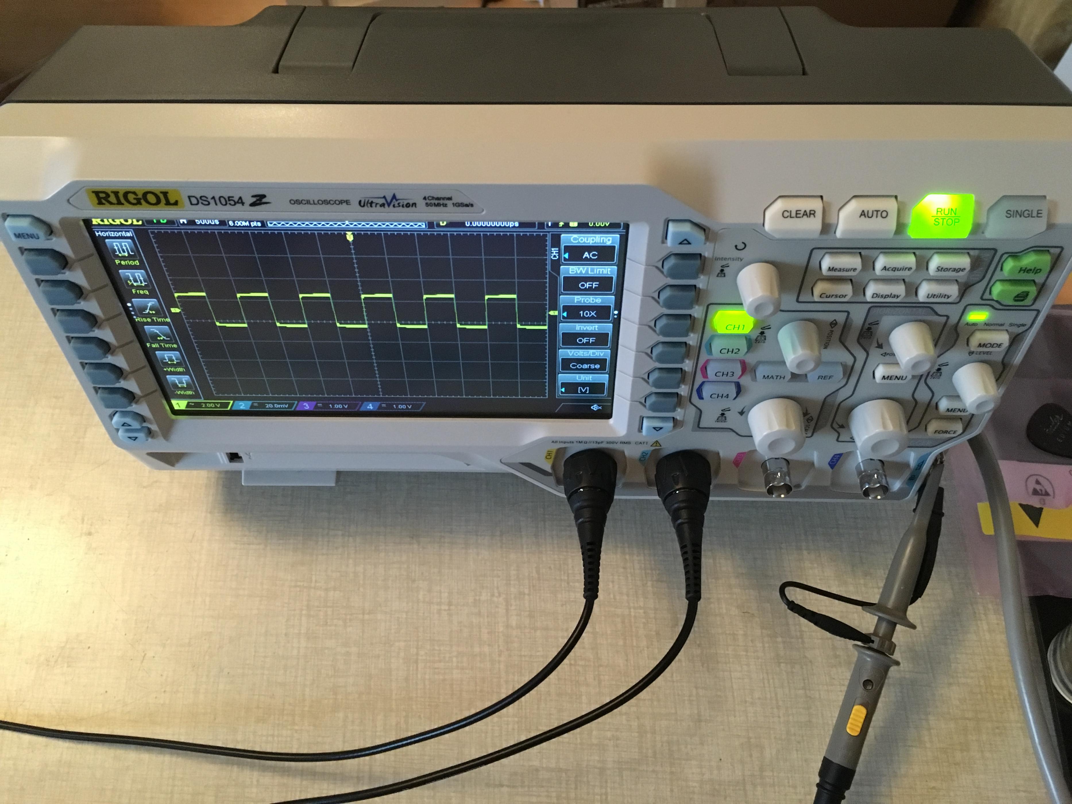

This is my new scope, after testing it at the dealer i decided to go for it. Compared to the 2000series this has 4 channels and is a later design, for less than half the price.
The guy i spoke to told me that a lot of their customers buy the 1054z, altough the 2000series is a better scope many go directly for the 4000 if they need something better.
I have used this scope for two days now and im satisfyed.
It was really easy to probe a balanced signal using two probes and inverting ch2. Then using the math a+b i could directly see both the signals and the sum of them. Maybe it could be a bit more responsive but i have nothing to compare it to and i can live with it.
Still like my old tektronix better, it has some kind of magic 😉
Maybe i will report back after using it for some days, still havent got used to it, but at this price its really good. And i have a lot of money over that i can spend on some kind of fft set up.

Glad ot hear that you are satisfied. Have you visited Riglol to unlock all of the features of your scope (ignore the 500uV feature, that was in beta and found to not be stable enough for Rigol's liking so they removed it). Im actually surprised many people jump for the 4000 series scope. It is considered to be kind of an also-ran. While Rigol is great forthe price range, when you need that degree of higher performance, you are no longer int he hobbyist range and as a result usually not looking to cut corners. In the upper ranges most people are looking at Keysight, Rohde&Shwartz, Tektronix, LeCroy.
Otherwise, good luck in building out the rest of your lab.
.....Maybe i will report back after using it for some days, still havent got used to it, but at this price its really good....
Please do 🙂
