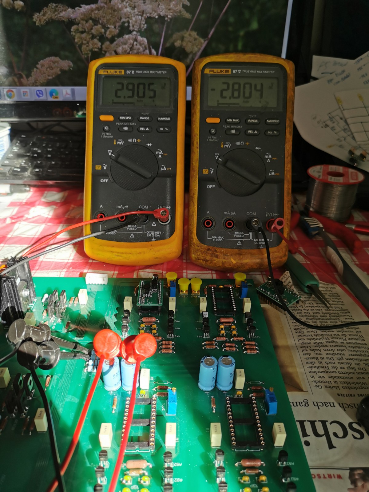

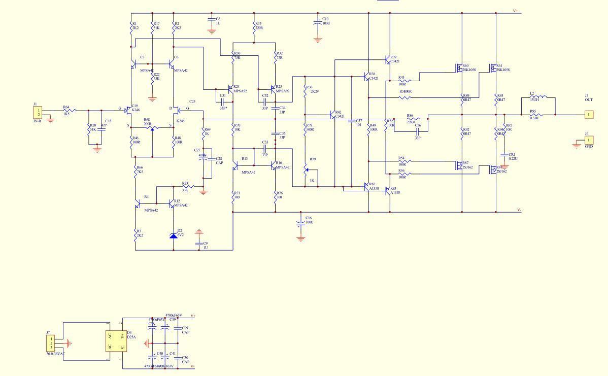

Hi would this be any good ?
bought with a job lot on ebay .
i have removed 1 of the 4 2N5566 dual fets and it was very closely matched .
I am currently building a Mezmerize B1 buffer .
would it be worthwhile building this in to a chassis or just stick with the Mezmerize build .

I have the exact same preamp board which I am using as my main preamp since 2013. Never had any issues with it. It works perfectly fine and I think it sounds quite detailed.
I have never carried out measurements but it's dead silent. It gets a little warm but nothing to worry about.

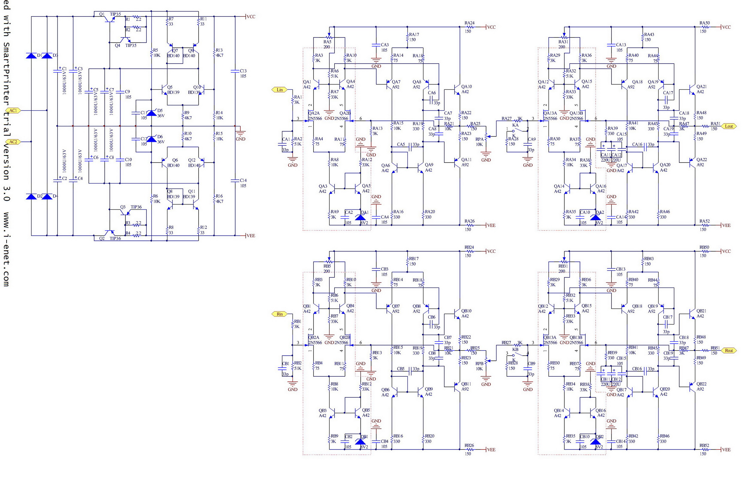

The board layout looks like the original G27 preamp board

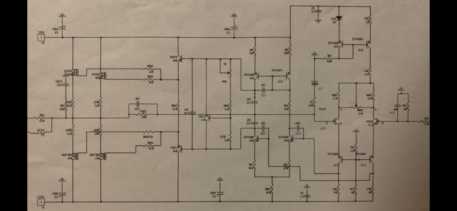

schematic attached

Why do you connect two preamps one after another. First you amplify the line level, then you attenuate it, then you amplify it again. Any particular reason?

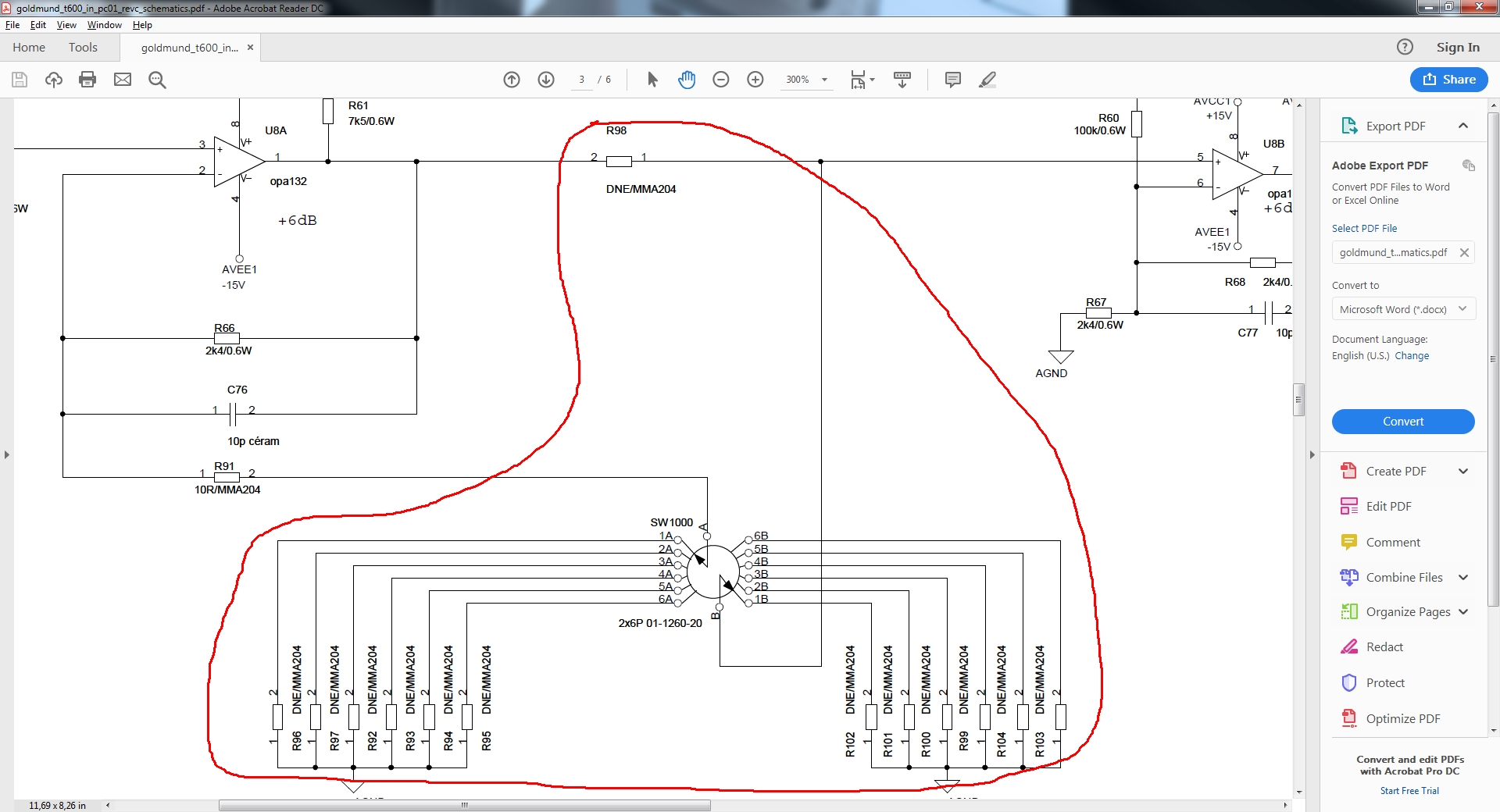

hi.
can anybody provide the values in the telos schematics i marked in the screenshot?
schematic attached

I don't know if we are talking about the same guy, but when I asked for information regarding the adjustment of the pots or a schematic, I got no reply..Thankfully, I was able to find the schematic some years later after a google search.

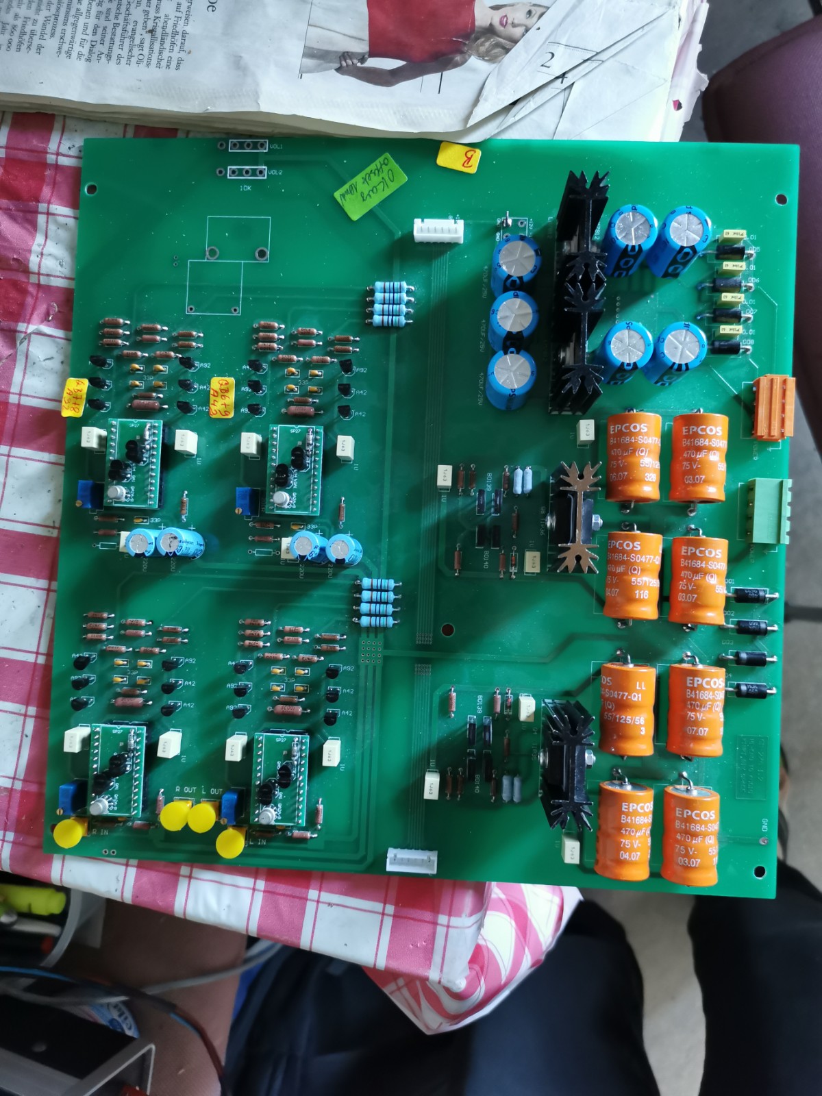

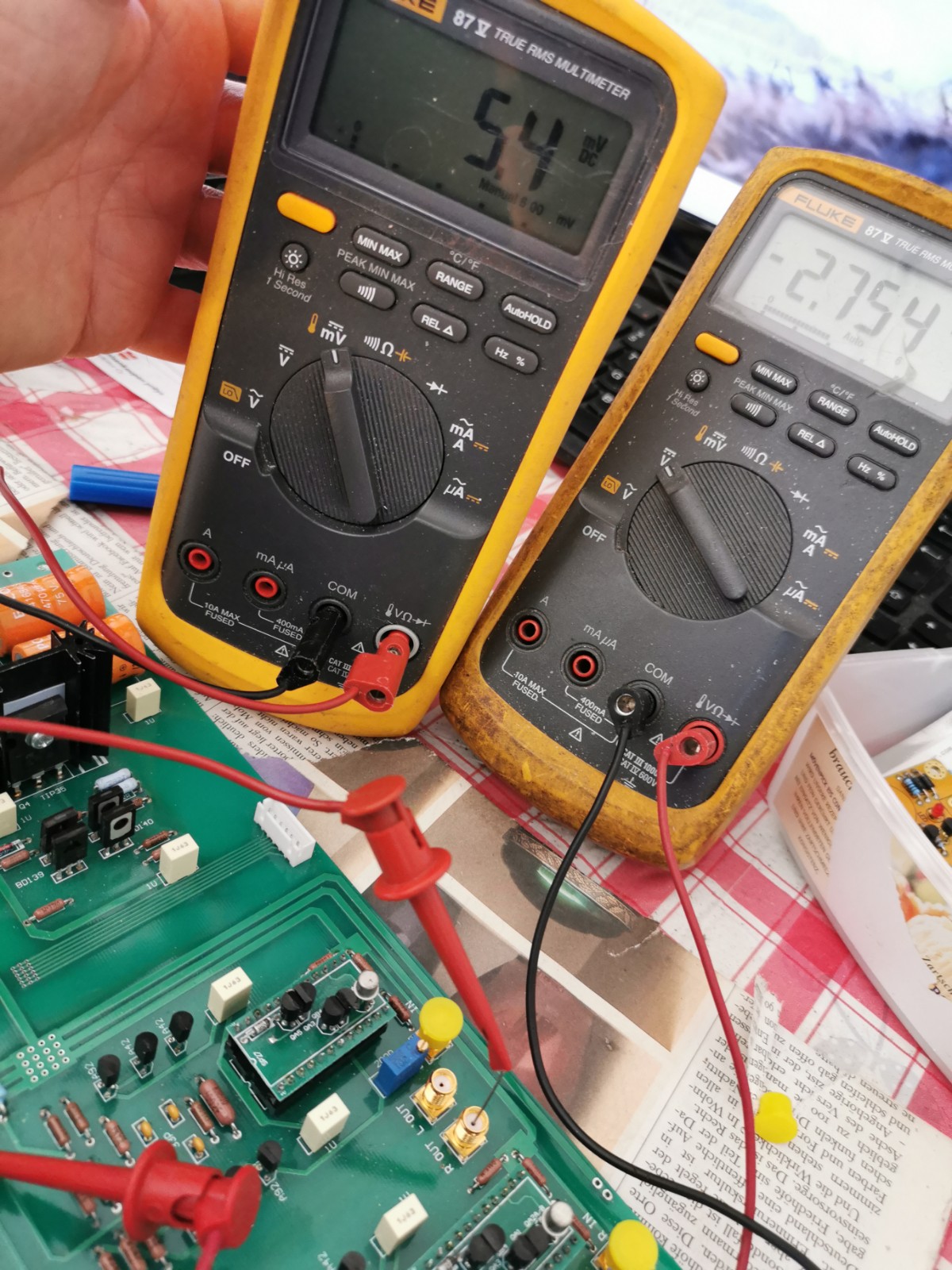

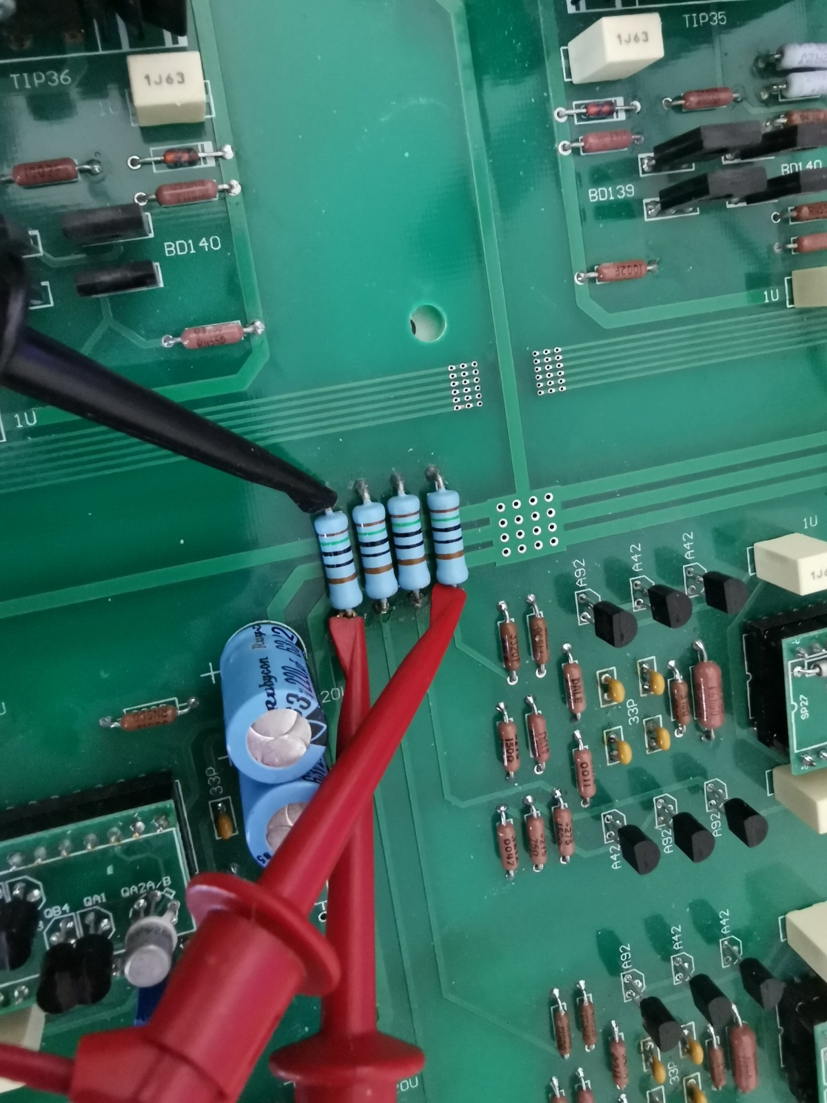

One thing I have done was to change the electrolytic capacitors in the power supply. Since the ac voltage of the transformer is 2x45V the dc voltage that the filter capacitors see is up to 63V which is their rating. Therefore I used 1000uF/100V capacitors. No need to change all of them, but surely those four filtering capacitors just after the rectifier bridge need to change
By the way I suppose that each pot is a dc offset adjustment for each amplification stage and the switch should attenuate the signal coming out of the first stage. Now since the volume pot is sitting between the two stages I guess that each stage acts also as a buffer to match the impedance between a line source and a power amp and the switches will control the total gain of the preamp. Having the volume pot away from the input and/or the output of the circuit should be a good thing since the impedance is kept constant no matter the position of the volume pot which is nothing more than a voltage divider..(of course it depends on how it is wired in the circuit)
carlmart, thanks for the suggestion, changing the capacitors is easy, I can do that from top of the board, and see if I can measure any improvement, but as I explained I use limited setup, just a laptop with RightMark software, no fancy stuff
as for adding the zener and other diode for drivers, that would likely require removing the boards from the heatsink...so I will see about that

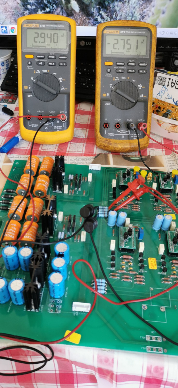

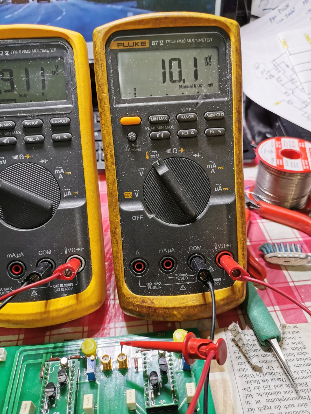

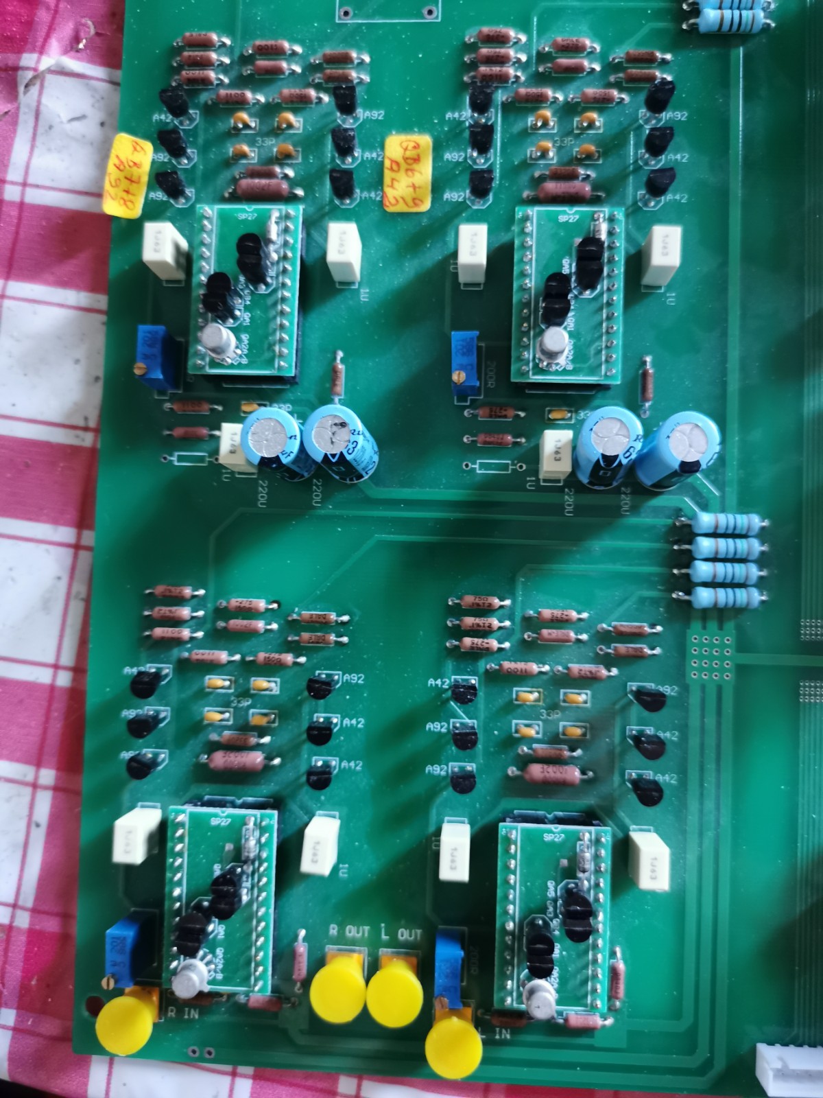

I build up two GM27 preamps using Motorola MPSA42 & MPSA92, the one i build without machting the offset on the output was 60mV - 70mV what is pretty high. So matching the MPSA is needed at least they are used in the Current Mirrors. When i build with the matched MPSA offset was 5mV to 10mV without for touching the offset pots.

I believe this is a schematic of a Telos 390. Look at post #262@ Sensation45 here is the Goldmund 29 diagram you are looking for😕

Are you looking for the schematic for the HM3S board?
Hello hm3s goldmund29 clone scheme?
you could just google it

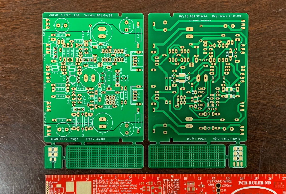

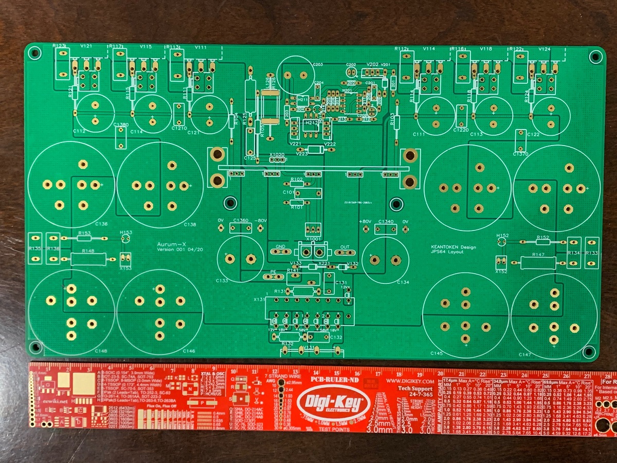

In case anyone is interested, here is Keantoken’s take on this amp (10 years in the making) but with state of the art layout by JPS64:
Keantoken's Aurum-X 300w Amp with LatFETs
Prototype PCBs are in...
Front End mezzanine:
Main amp board:
I just need to find time to build it. This will be an epic build with the outlay of resources needed for the 16x 100v rail caps, the 12 latFETs, and dual 600VA toroidal trafos, and miscellaneous parts and pieces. The PCBs are huge 2mm, 2oz, ENIG.
