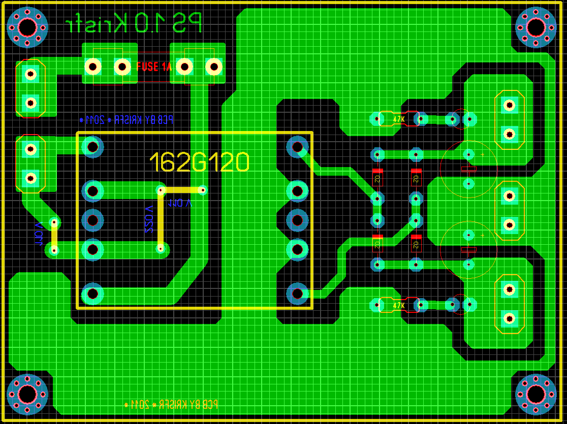

Keantoken: and Others
I have been working on several things, but I decided to let you start in on the actual testing of the amp.
I ran into some self inflicted wounds with bad jumpers and more. And in the process tore up my power supply board I had made for testing. While preparing to make another one, I thought about your admonition that the design I had built did not fit every criteria you wanted to address. I am talking about the post 1421 and 1442. Also should your Cap multiplier be inserted between the pre regulator and the front end of the amp.
So, IF and when you have a few moments will you post a schematic of a pre-regulator that works fairly well, it does not have to be perfect. JUST functional for basic testing purposes.
I have done a transformer board to feed it.
I have also finished my variac supply for the sake of testing, I have got to address some issues with it also, but it works well and is been a GOD send for my purposes. Along with the Keithley 192: 5 or 6 digit meter:D I have got to find a AC plug in for it.
Other wise carry on...:car:
I am not going out much with Gasoline selling for more than cheap liquor, I do not even drink that much...:p
It is like the cost of those 10 cent steel washer for the bolts at Lowes... shameful.

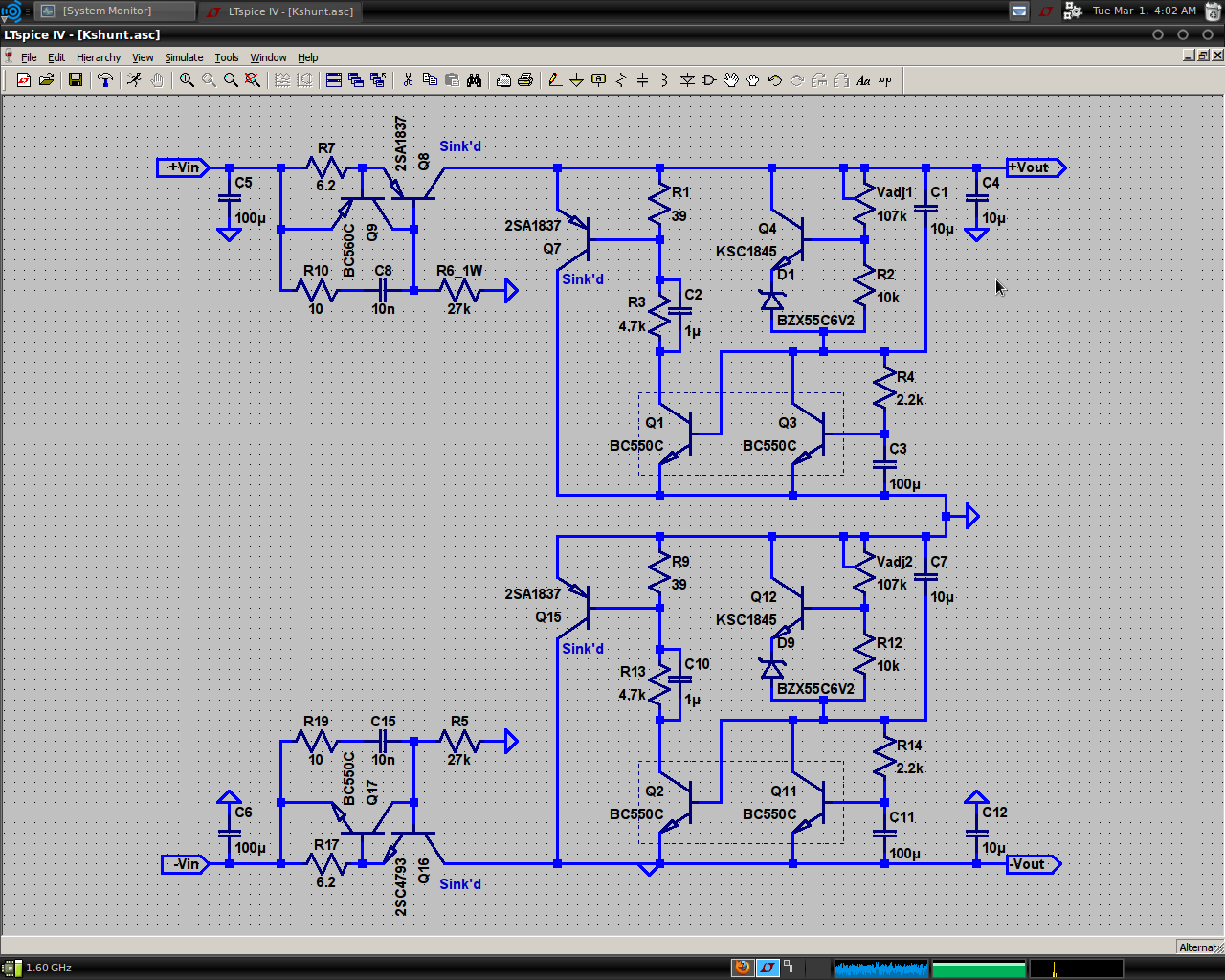

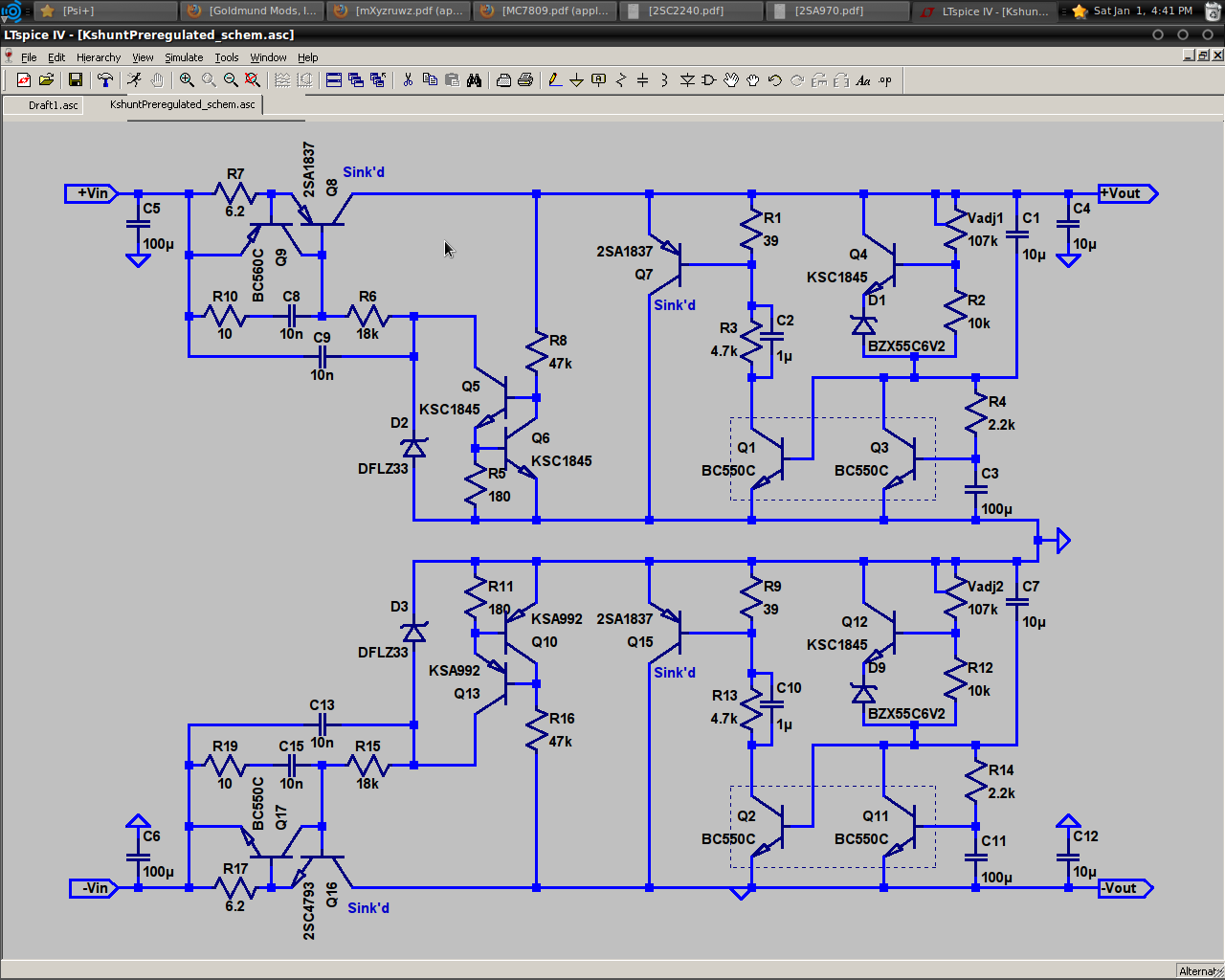

Krisfr, I meant for there to be only one frontend regulator for the official design. However if you want to use more than one, I recommend putting the shunt design closest to the amp circuitry, and the preregulator can be whatever you choose.
For basic testing no regulator is needed. Attached is the barest shunt regulator version. If this doesn't work, then none of the other versions will work.
- keantoken
Keantoken:
So in this order, The transformer board in post 1572, a pre-regulator, then shunt from post 1574, then the amp front end.
Any suggestions for the pre- regulator? ANY ONE can suggest it.
Can the pre-reg and the shunt go on the amp board, I am just trying not to put AC on the main amp board.
How is your testing coming?
You could use the K-multiplier. It is simple and well-performing. How much ripple do you expect from final supply, at say 50mA current? I could adjust the Kmultiplier for a HV supply. It would not need a heatsink.
There is nothing wrong with having all regs on the board. I would suggest local decoupling both at the rectifier and at the input to the board.

re: schematic of post #783
Don't understand position of C15, across R3 would make more sense?
I mean, we got to drive gates, which need same pull up slew as pull down.
Yet we got emitter vs 220R+emitter difference between up and down drive.
Only mere 100R gate stopper in series doing anything to bring symmetry.
Wouldn't a cap across R3 220R (maybe a bigger cap) drive more equally?
If so, would it make the small C15 in its current position redundant?
