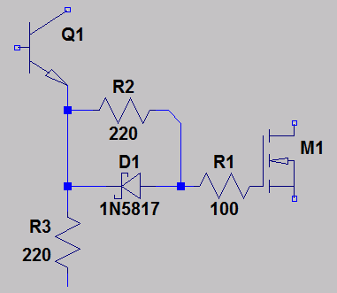

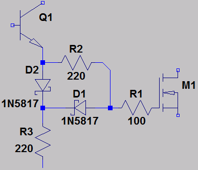

Seriously Kean, you got mosfet gates misdriven such they turn on at faster speed
than they can be turned off. There ain't gonna be symmetry of push and pull when
the waveform gets moving fast.
Unlike your Allison output stage, there's no local device turned backward to watch
this mismatch of drive slew happen and immediately correct it. Only a cap coupled
global loop watchin' over the sum of two source followers with different delays.
I take back about global loop bein' cap coupled. Its still a long fix to a short problem.
And while it may fix sum of mismatched slews, it don't make either problem go away.
Linking the drive emitters also "closes whatever in the loop" would be linked by cap
coupling bases. Diode drops, go figure...

Another factor affecting this is the base stoppers. Unless these are chosen to give equal time constants, transverse currents can still occur. And this relies on the capacitances of each FET remaining proportional, which will not happen except at crossover.

Reminds me of blocking distortion in tube amps. Same thing only completely different...
Imagine you take this output and jerk it up and down fast enough that the difference
in drive slew becomes significant. The gates pump up charge that eventually prevents
a clean crossing.
Even a big cap across the 220R will eventually pump up if challenged with a continuous
fast squarewave, and for the same reason. If you like, throw a zenier across this cap
to limit the blocking madness from getting too far out of hand. Normal waveforms are
never going to pump up such charges anyway, I'm just nitpickin.

As we approach the rail, bias on the drain goes away.
Miller capacitance approaches symmetry with gate to source capacitance.
We have 100R charging gate (and an ever increasing miller) toward the rail.
Yet 320R must discharge all coulombs of stored miller going away from rail.
No sim today is going to show you how the miller caps change with bias.
Problems with large signals can happen at lower frequency than you might
expect.
Might help, or not????

The original Goldmund design didn't have any fancy drive. As much as I would like to explore this option, one of the original design goals was to not get complicated. Many amplifiers exist without fancy drive, so I figure it's not important for audio...?
