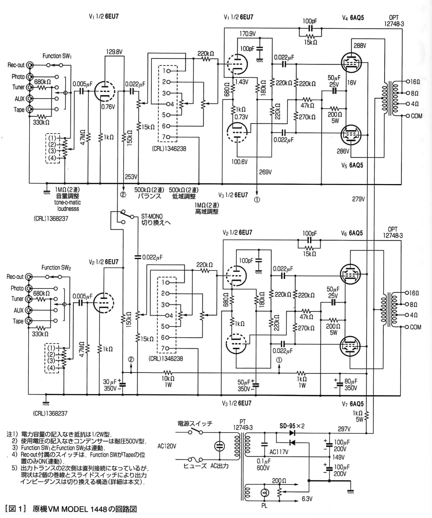

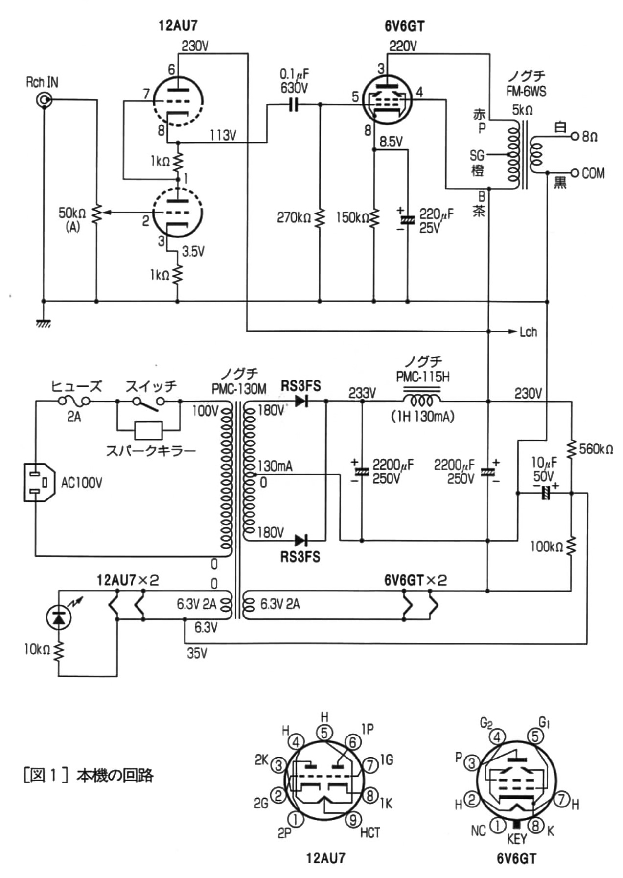

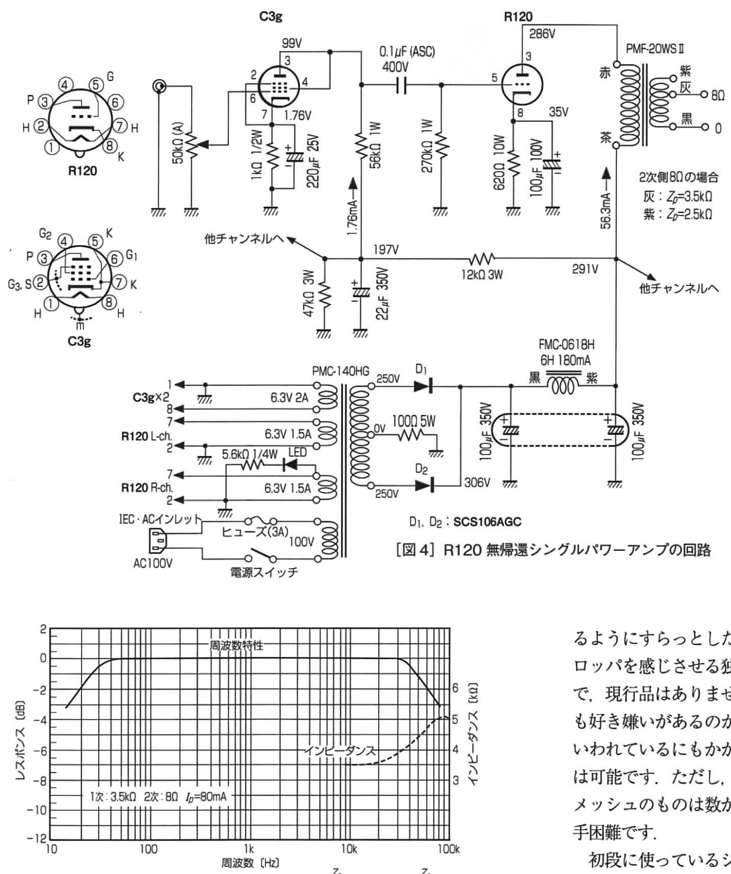

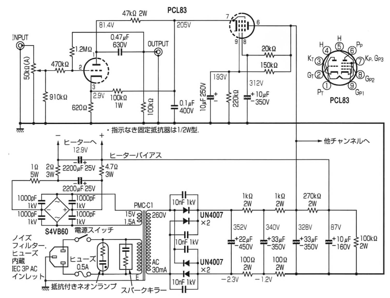

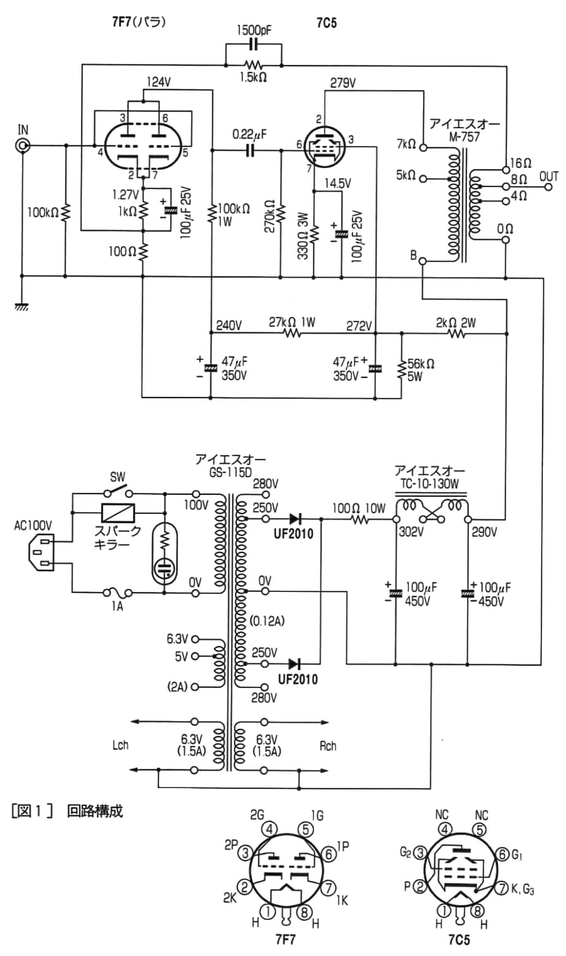

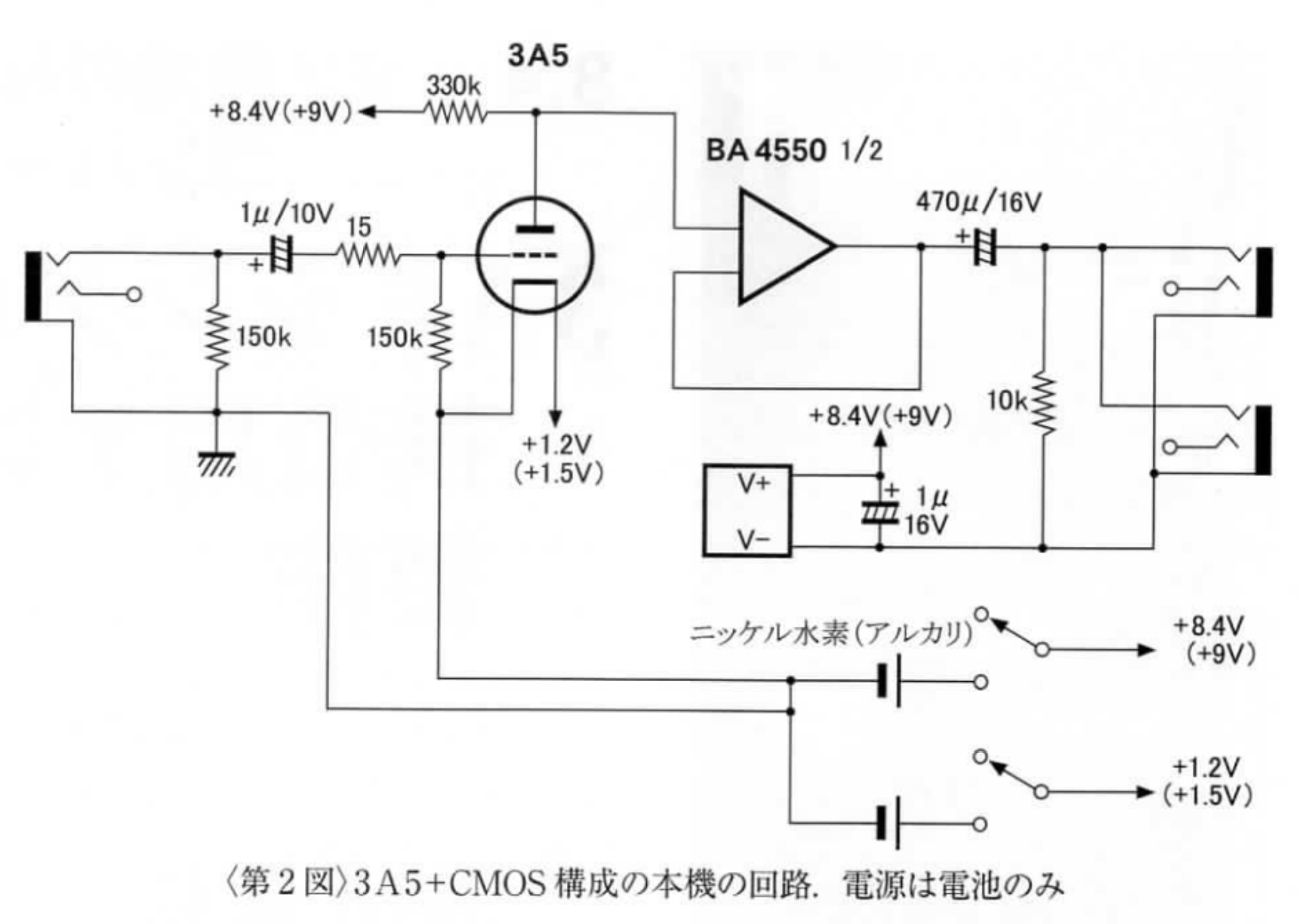

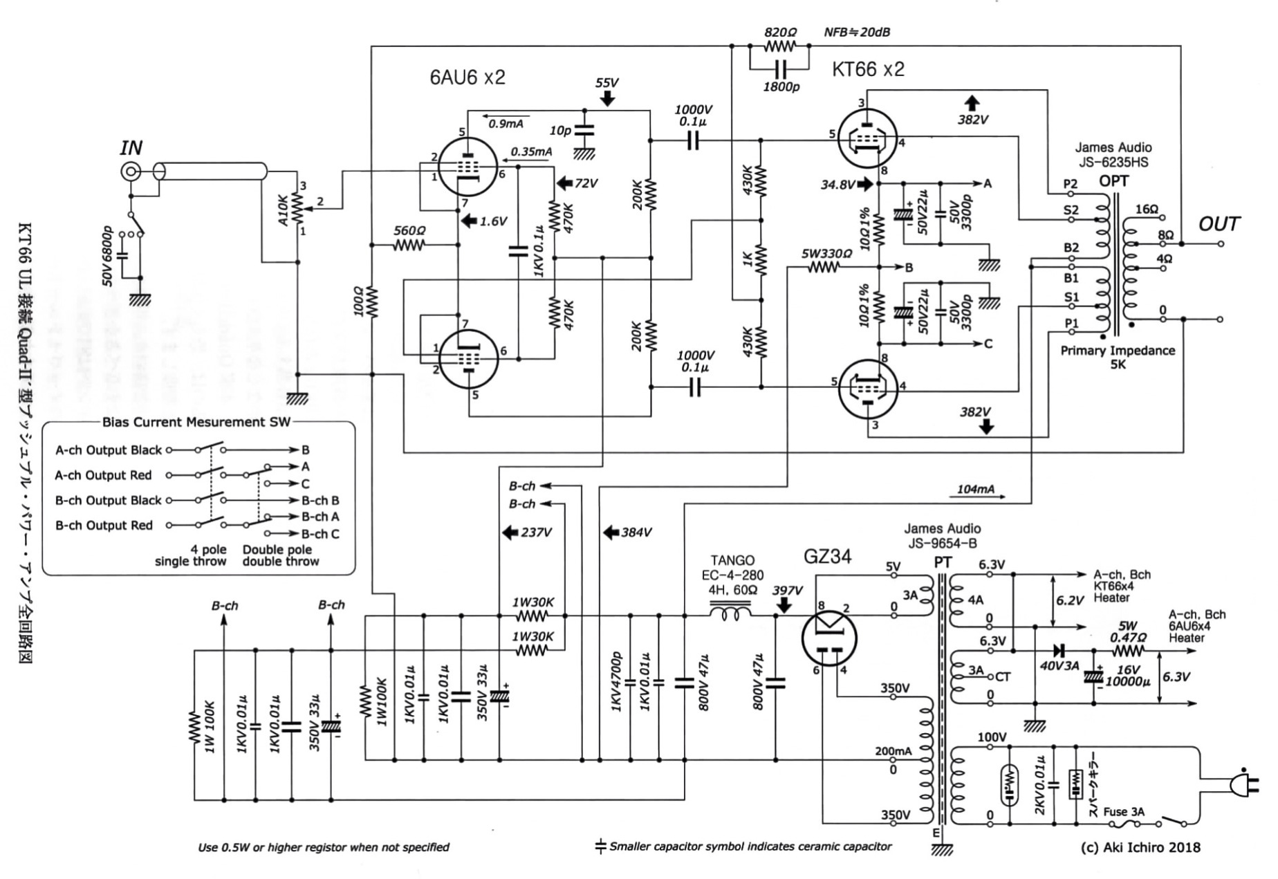

Gold mine of DI¥ audio tubes schematics from Japan

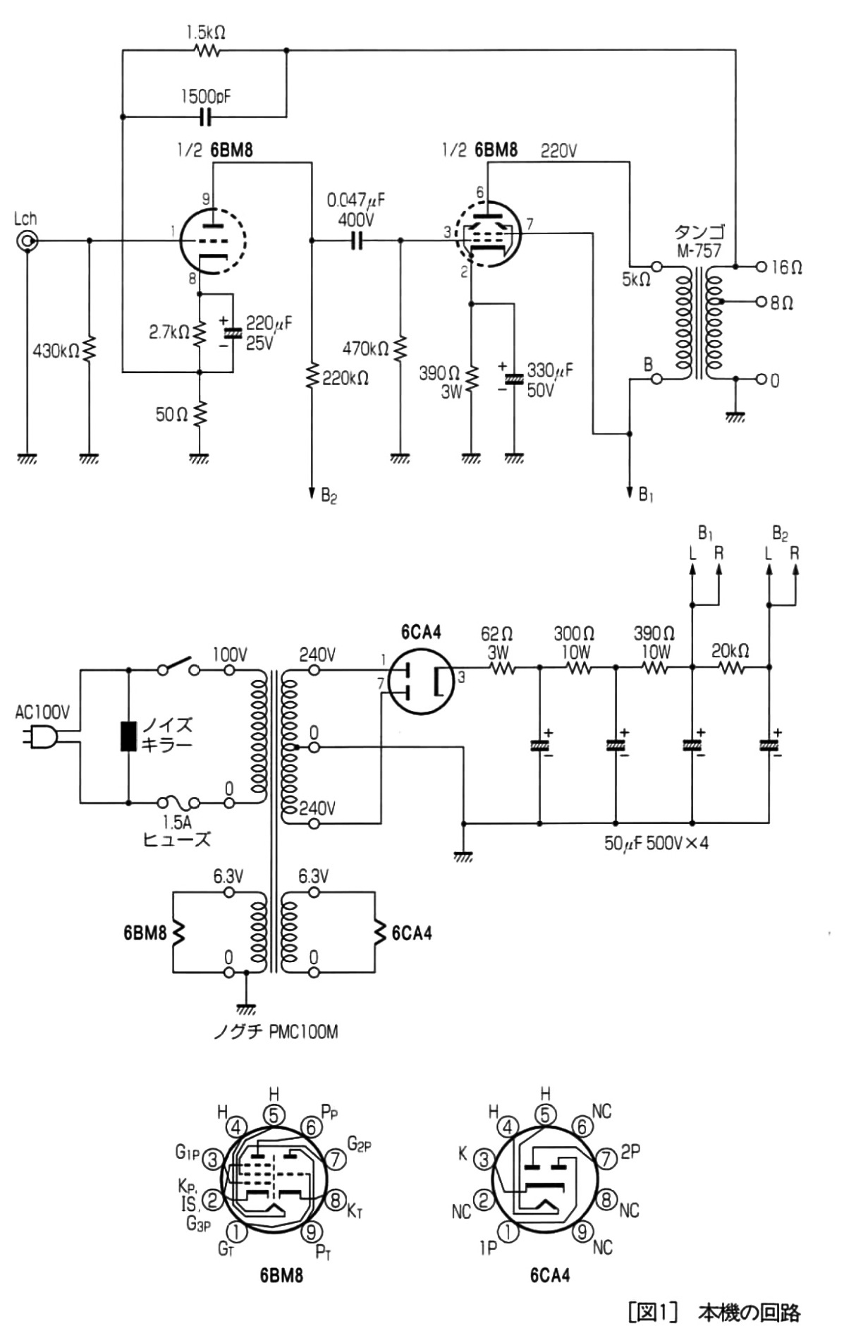

Exactly :cheers:!

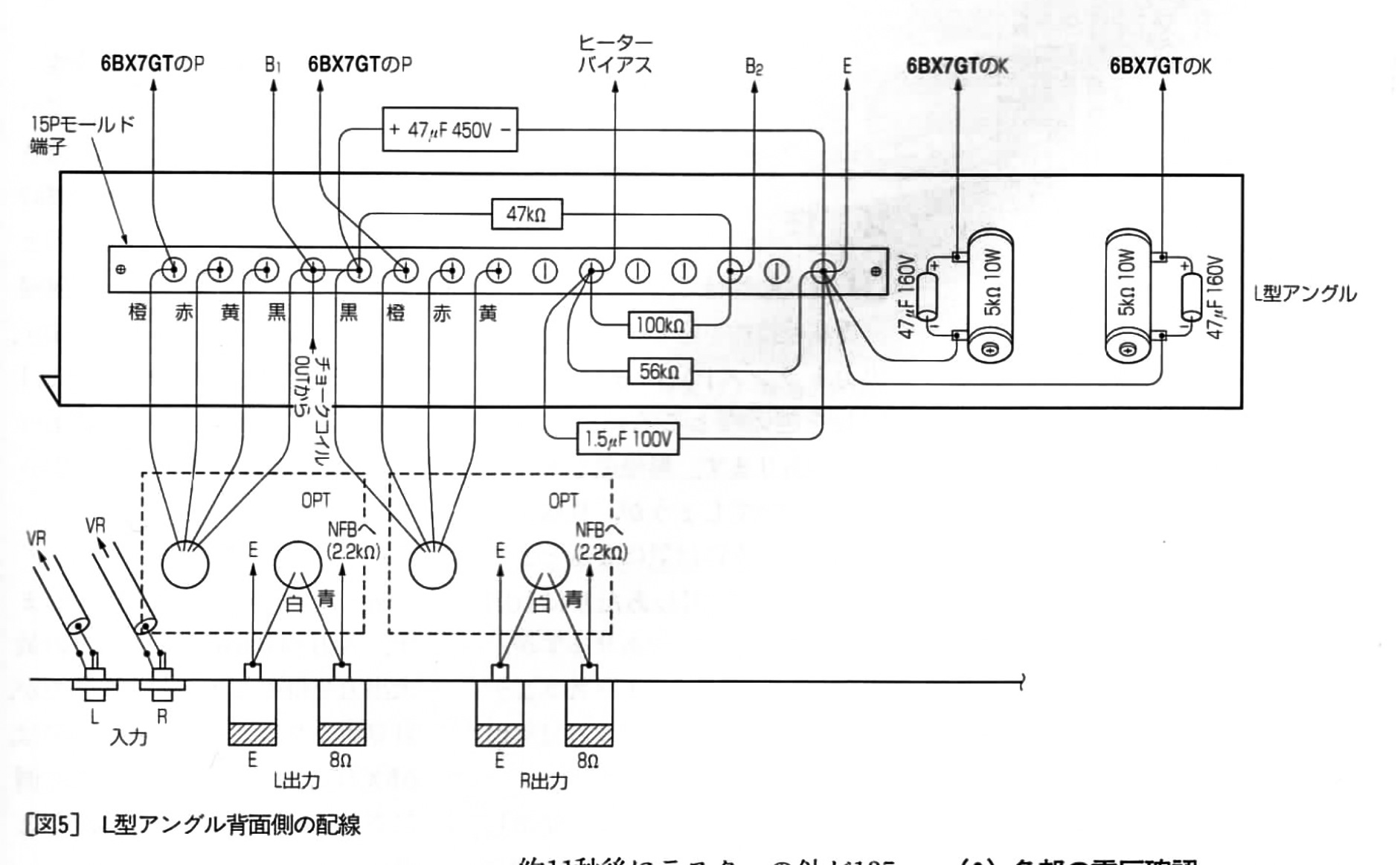

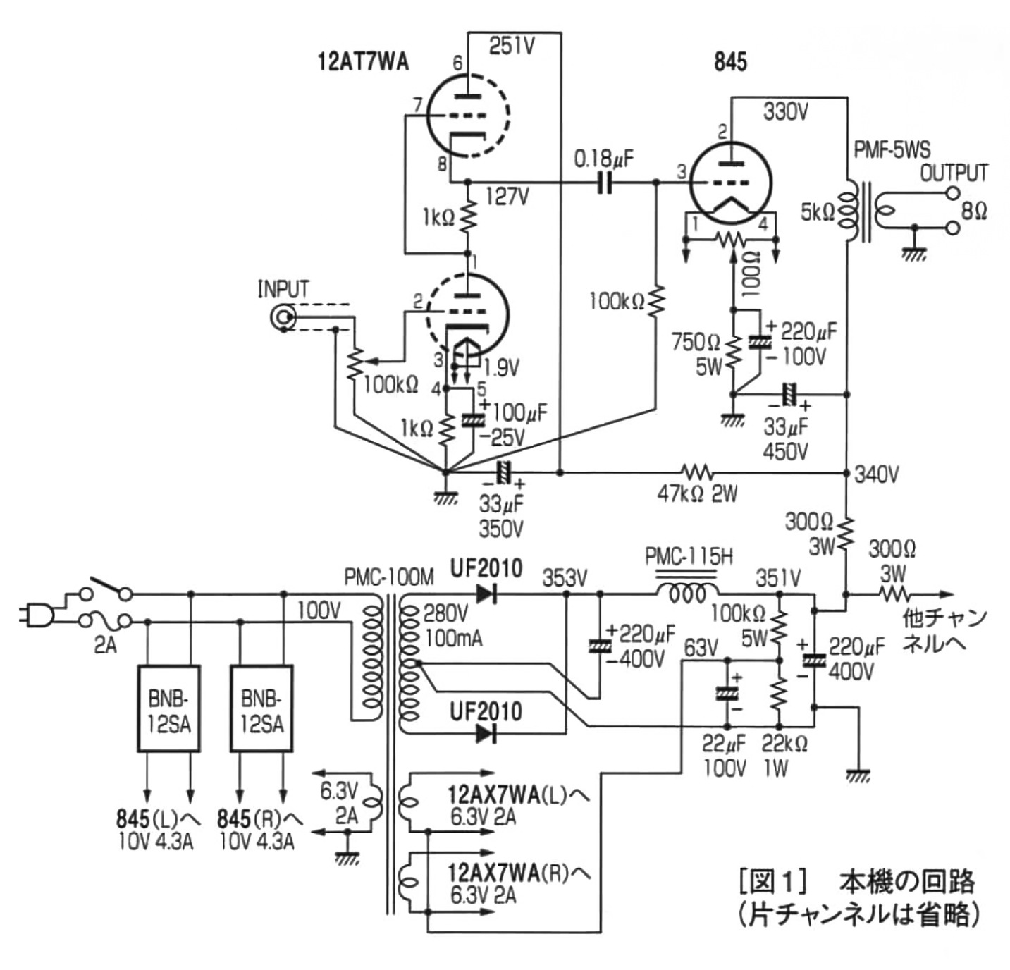

I have to notice a small difference between your schem and the one that I've built, though: The 12AX7's cathode resistors are bypassed capacitively, mine weren't. Hence, it's insufficient bandwith might have had it's cause in the increased output impedance.
Best regards!
