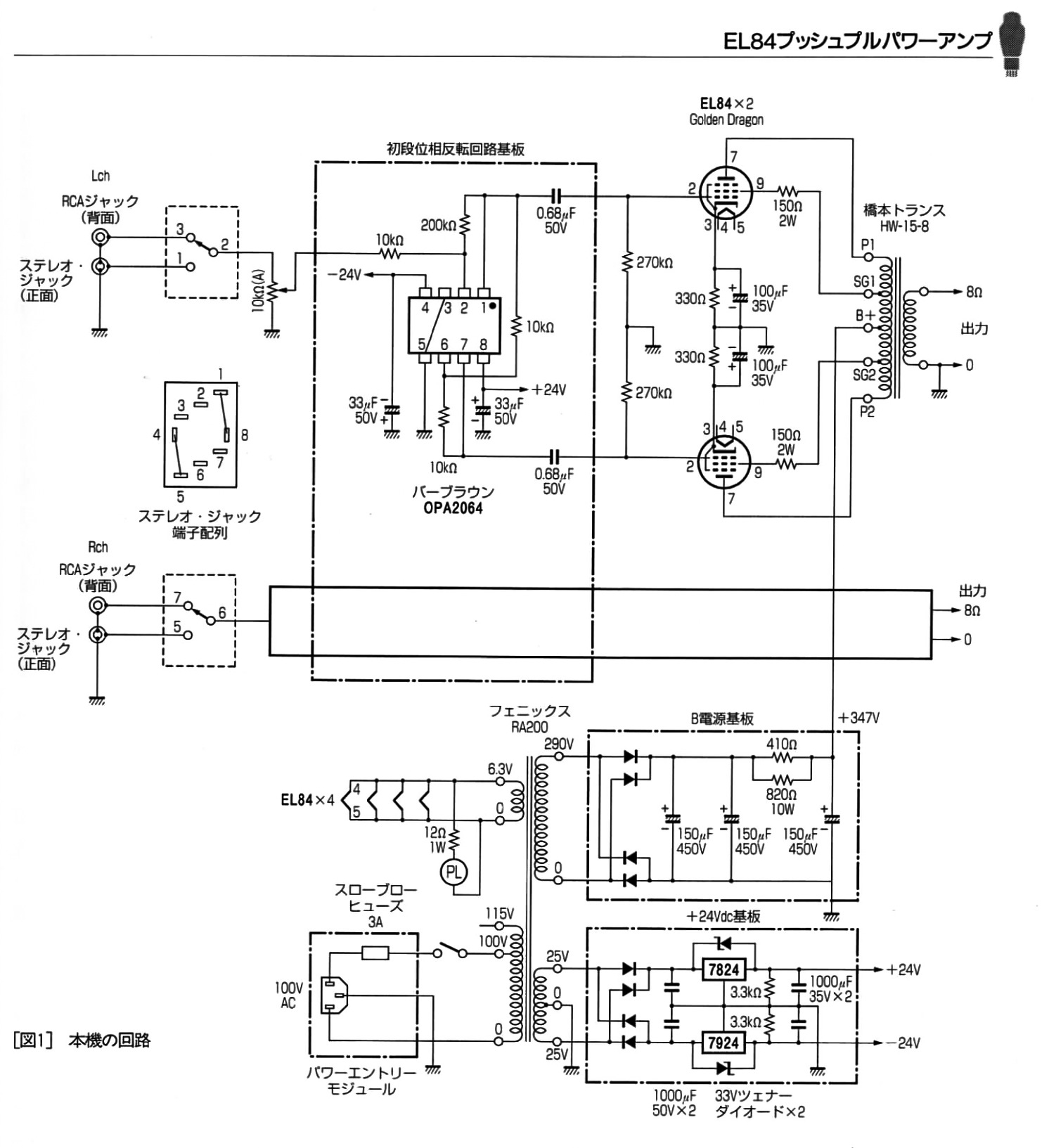

If you are interested in tube amplification that has been tested, well documented, and with parts easily available, then maybe head away from here and go over to the Baby Huey PCB in the Group Buy. There are two versions, one with original in mind using the EL84 in a PP configuration and one that has more power to it using a pair of the EL34 with all appropriate adjustments and components to match the power. I do believe that with the EL84 Baby Huey variant, you might be able to scrape in under $500 and have a powerful amplifier in a neat and clean package.
The advantage of the EL84 Baby Huey is that you can bypass the PCBs on the Group Buy and build it like the others have done so in the EL84 Baby Huey thread in the the tube section here.

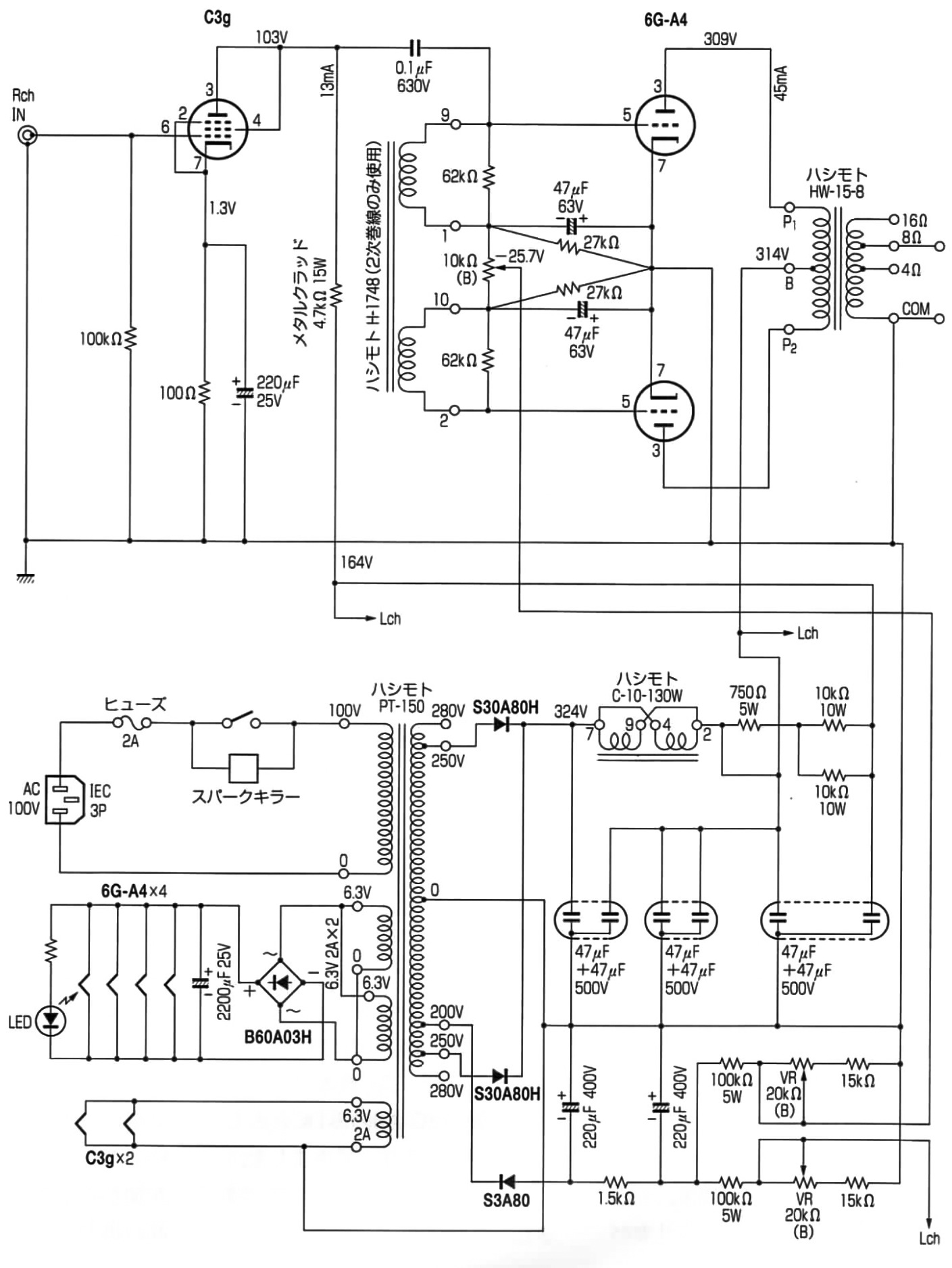

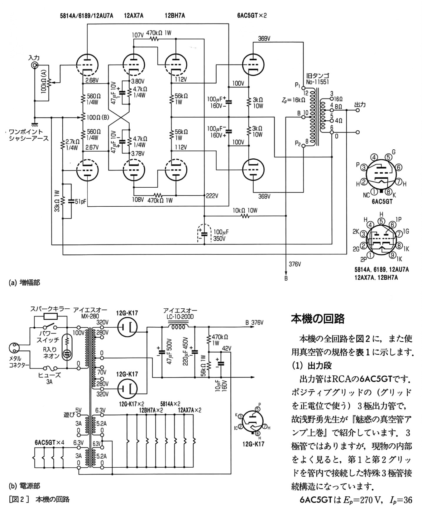

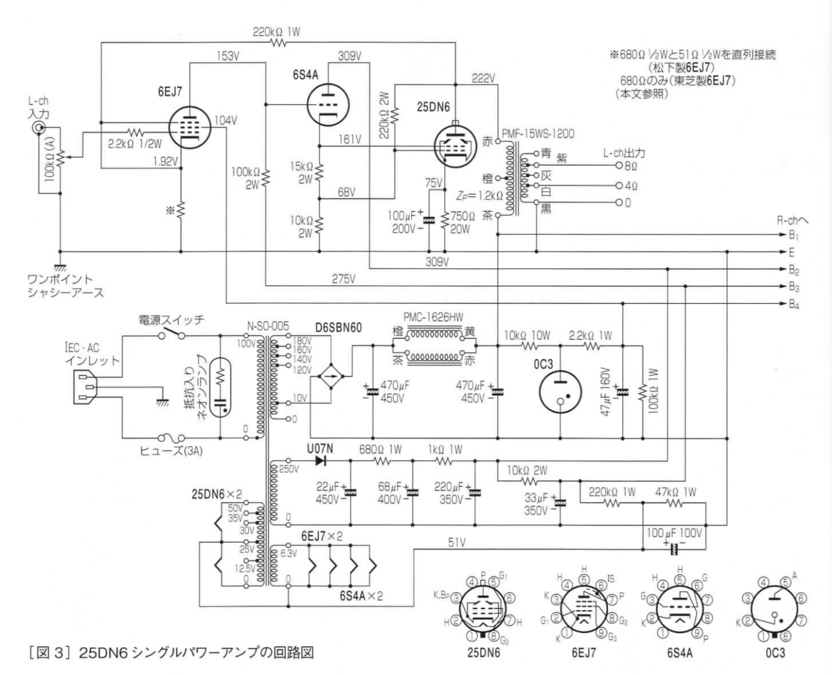

I'm taking a different route... I stumbled upon a Soya Susumu's design but no way to build it as is. I'll try to convert it to put in use some tubes that are lying on my shelf. Still only on paper and no idea if it will work.

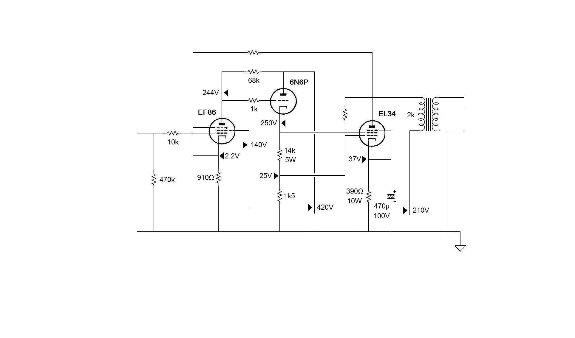

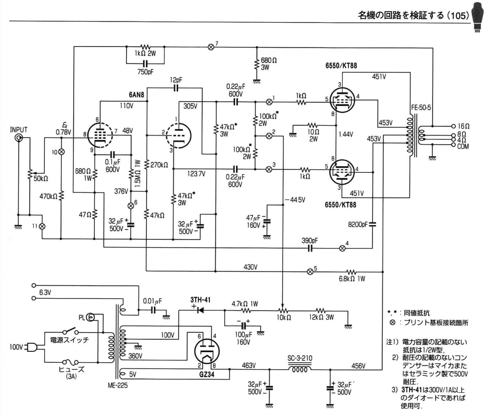

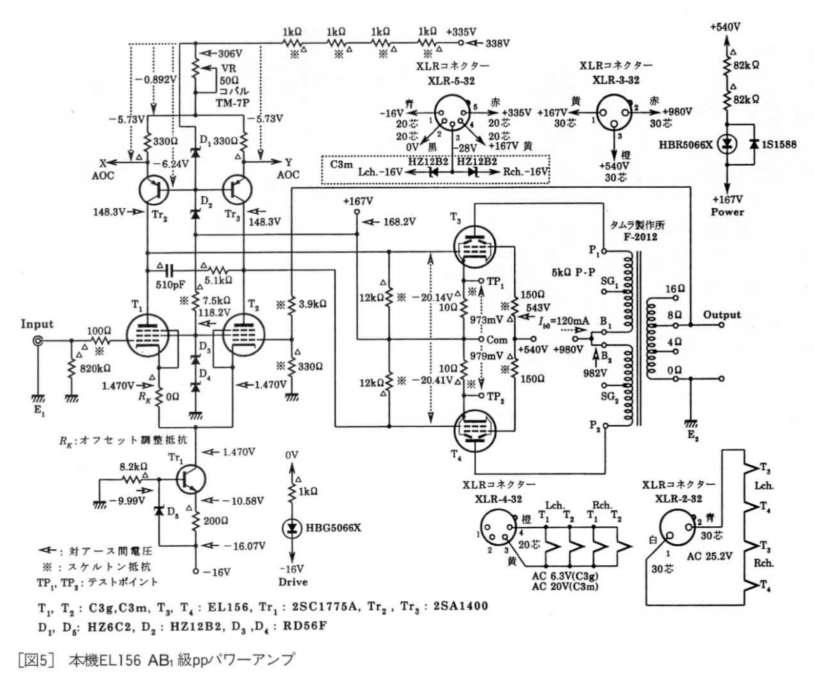

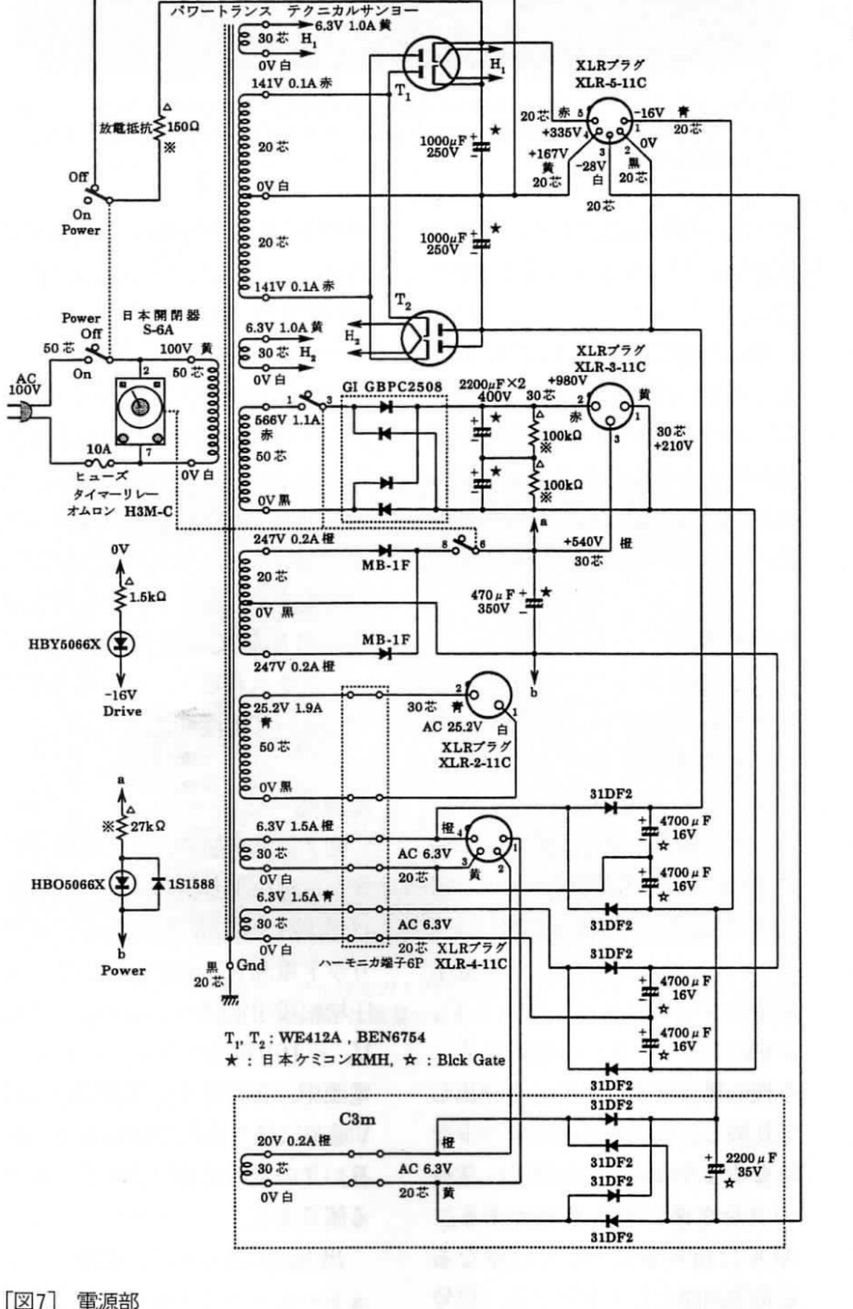

This amplifier have much better frequency response with global feedback and this is show on the schematic and article 🙂

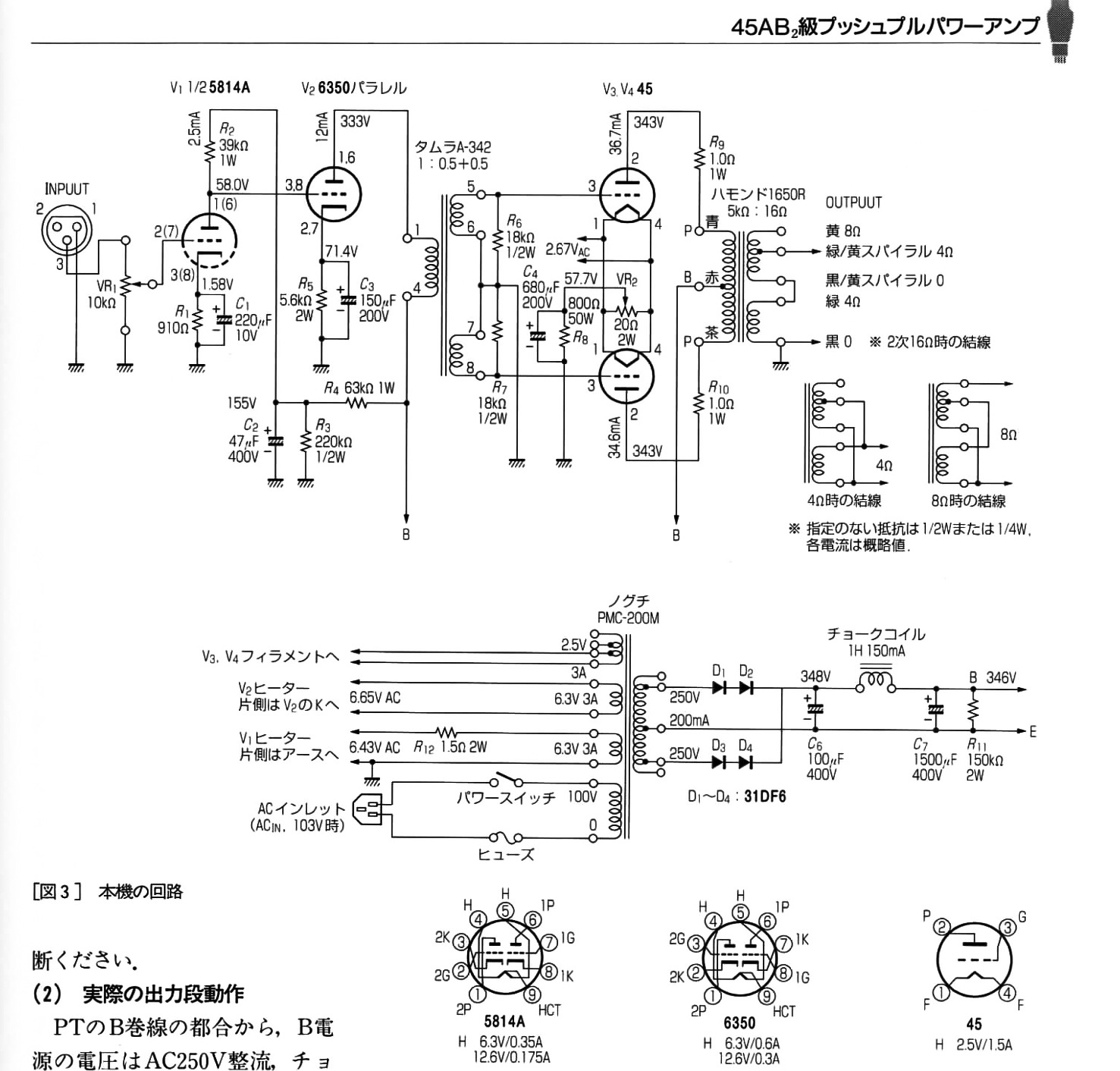

The 2nd schematic above shows the van Scoyoc phase inverter which I didn't have any good experience with (extemely limited bandwith due a too low HF roll-off). Does anyone have better luck with it?
Best regards!
Well, which schematic do you mean? From the 255 response? If this is correct then I have to confess that I need a closer look at this schematic because I do not recognize a "Scoyoc phase inverter" because what is a "Scoyoc phase inverter"?
