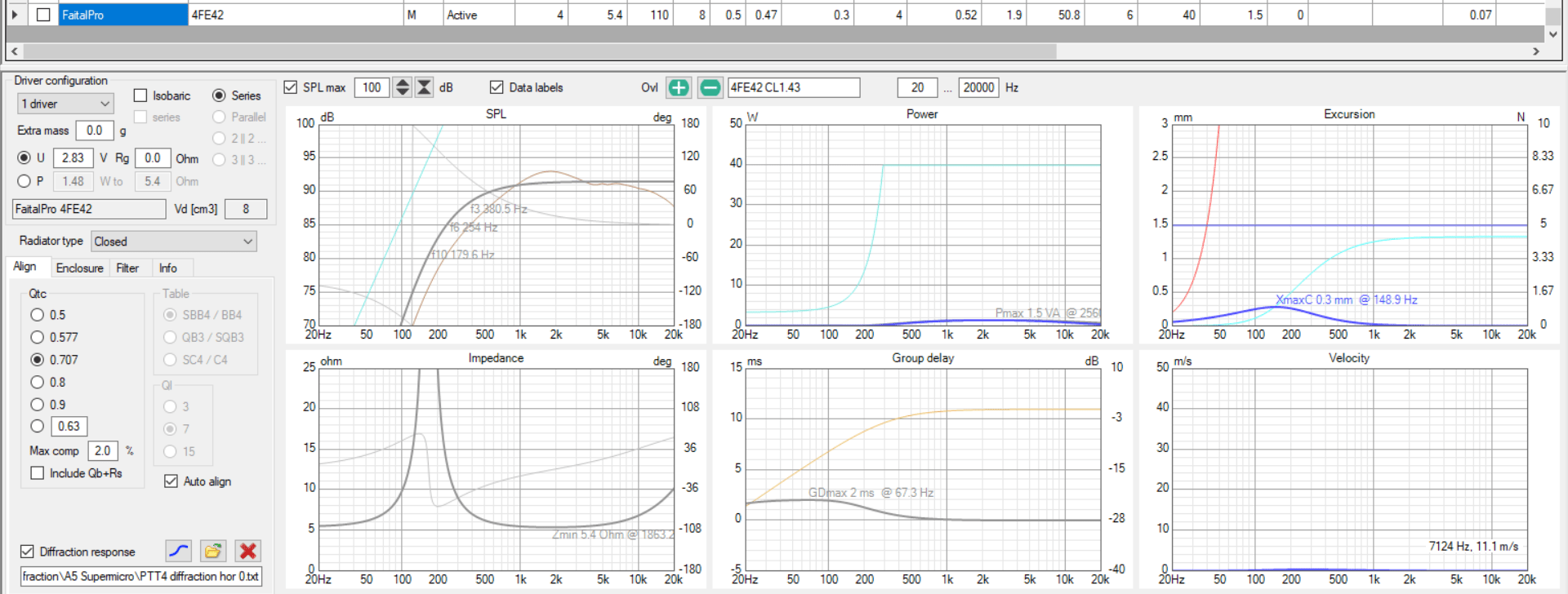

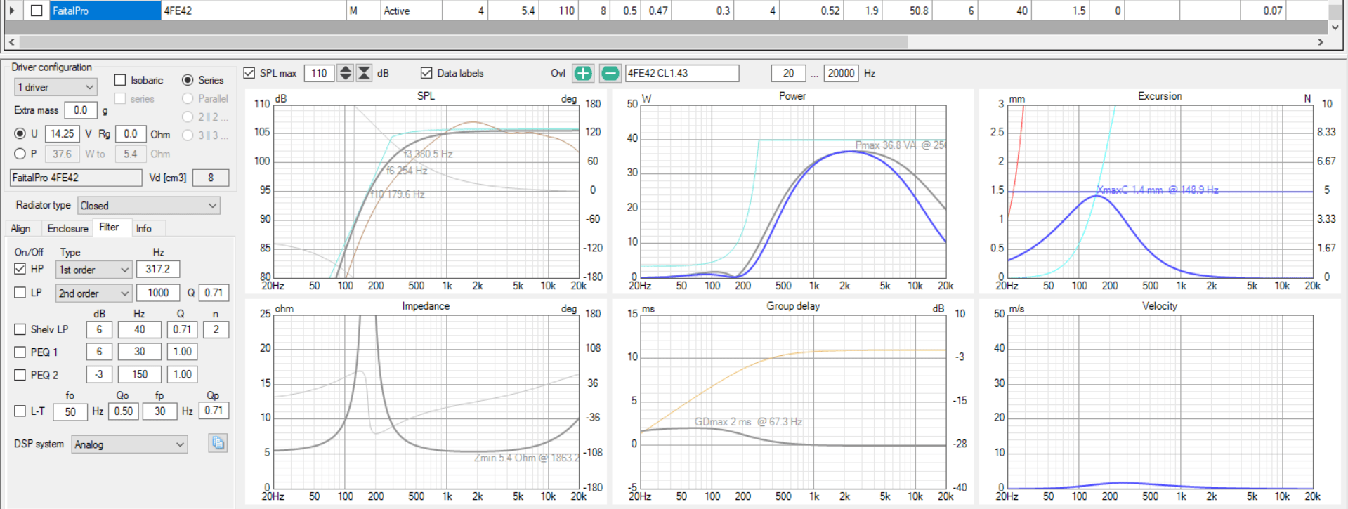

From Faital’s datasheet:
Looks like good inductance control, and first break up at 3Khz.
Basic system sensitivity in 2pi in black trace. Brown trace is with a 1st order high pass, on a micro sized cabinet with baffle the size of A5 paper (sorry my North American friends- that’s 5 3/4” W x 8 1/4” tall; or about half size of US “Letter”)
Enough X-max and power handling to hit Maximum SPL in 1.4L (0.05cu ft) cabinet
So it’s a true 4” Mid-range, with good sensitivity, good from 250Hz to 2.5KHz, a copper cap for inductance control and low HD, and a reasonable price.

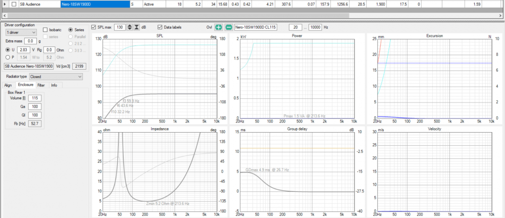

an 18” subwoofer with a 4.5" VC, ferrite motor, double roll surround, aluminum demodulation ring, 12.75mm xmax (39.5mm VC height, 14mm gap) Fs if 34Hz, Vas 159.9L, & EBP 79.
http://www.sbaudience.com/index.php/products/subwoofers/nero-18sw1900d/
Sealed box in www.data-bass.com style "standard 4 cu ft box for 18" subwoofers" showing basic system sensitivity:

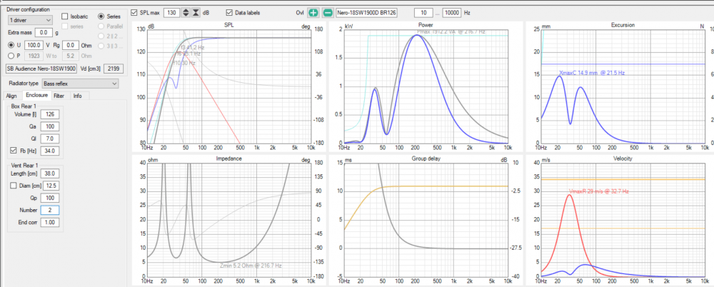

BR 4.5 cu ft PA style music "subwoofer" (-3dB 40Hz, -10dB 30Hz), with subsonic filter:

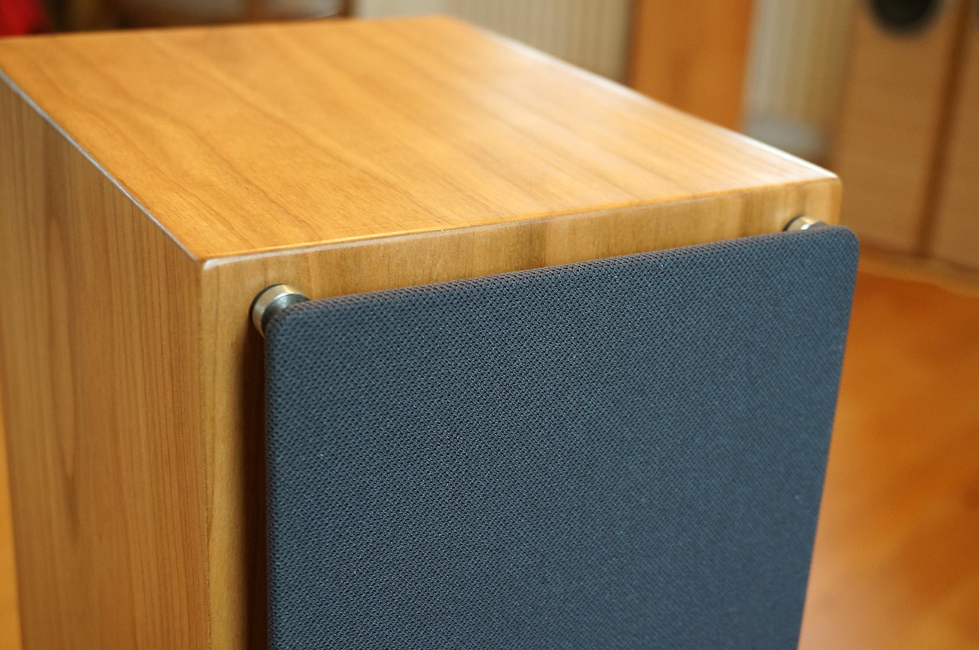

I also need advice on the grill. I'm going to get some vintage grill cloth, but will not be doing a typical grill frame because I don't want to use an inset baffle. I plan to do some sort of thin frame mounted 3/4" or so away from the baffle on standoffs. i may use magnets on the standoffs and baffle to attach it. Any ideas hos I might construct something like this?

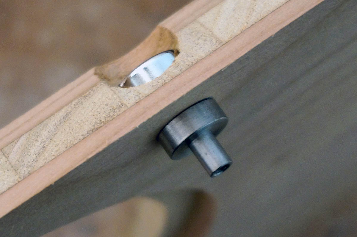

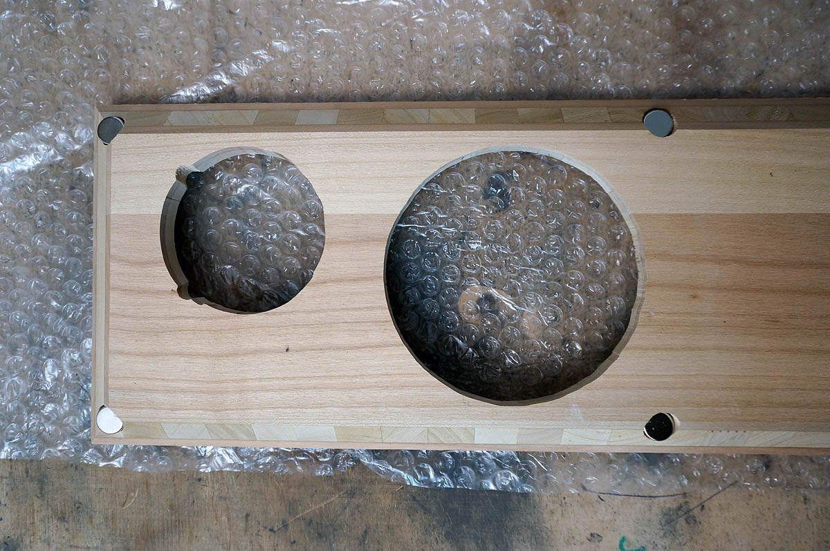

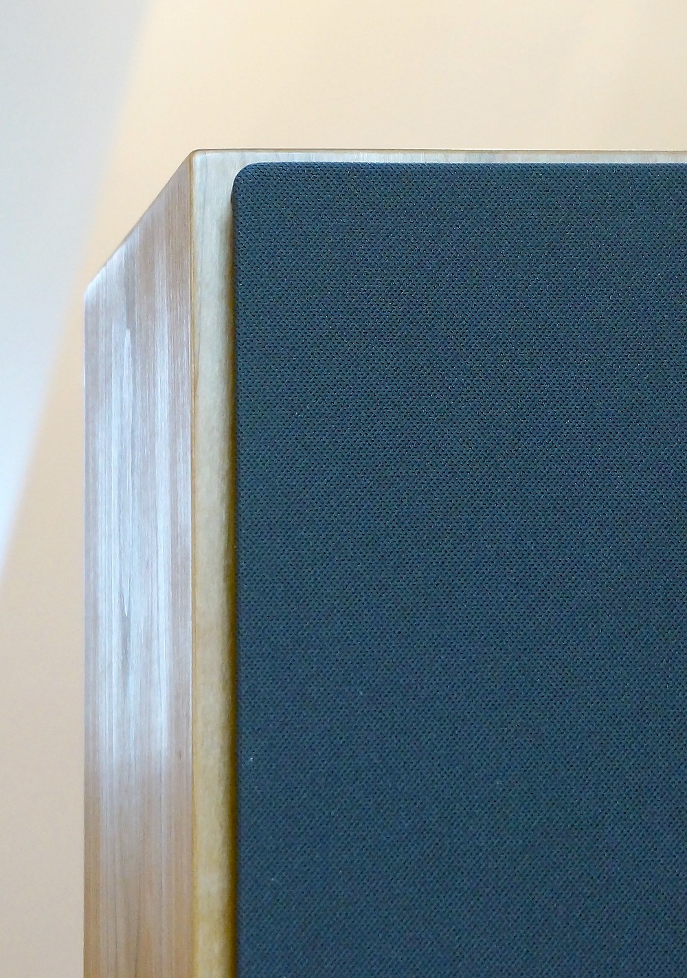

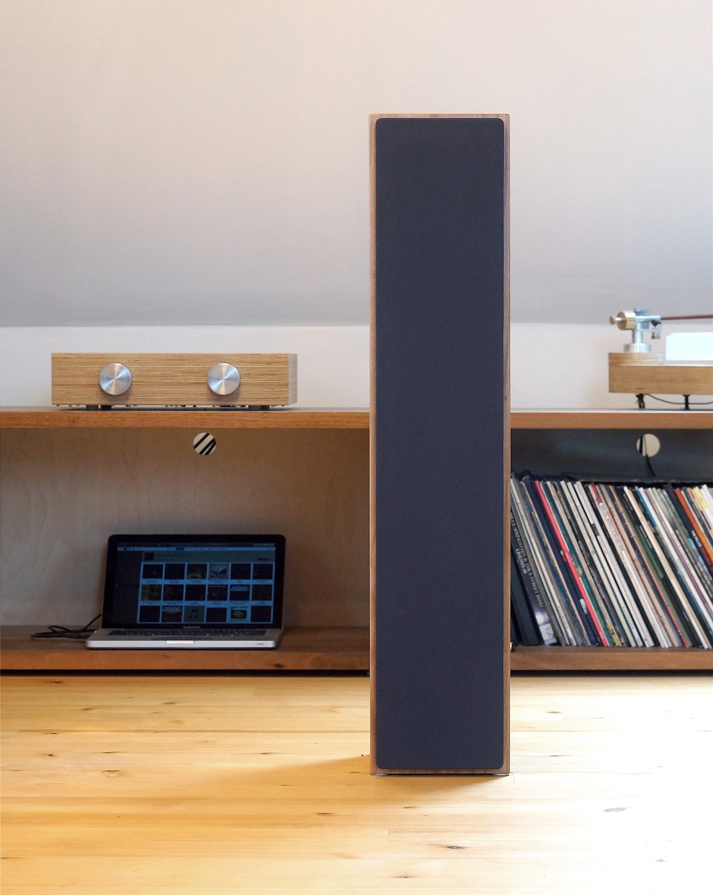

I did exactly that a while ago. I used a thin sheet of birch multiplex and cut the frame of this. The standoffs where made with a combination of magnetic screws with a flat head so the front of the frame remained flat. I also added some magnetic nuts on the screw ends to give the magnets a bit more to hold on. The cloth was wrapped around the frame and glued on the back of the frame. Don't glue on the front, as it will may through the cloth and look ugly. The magnets were glued into blind holes applied from the inside of the baffle, so they are invisible from the exterior.

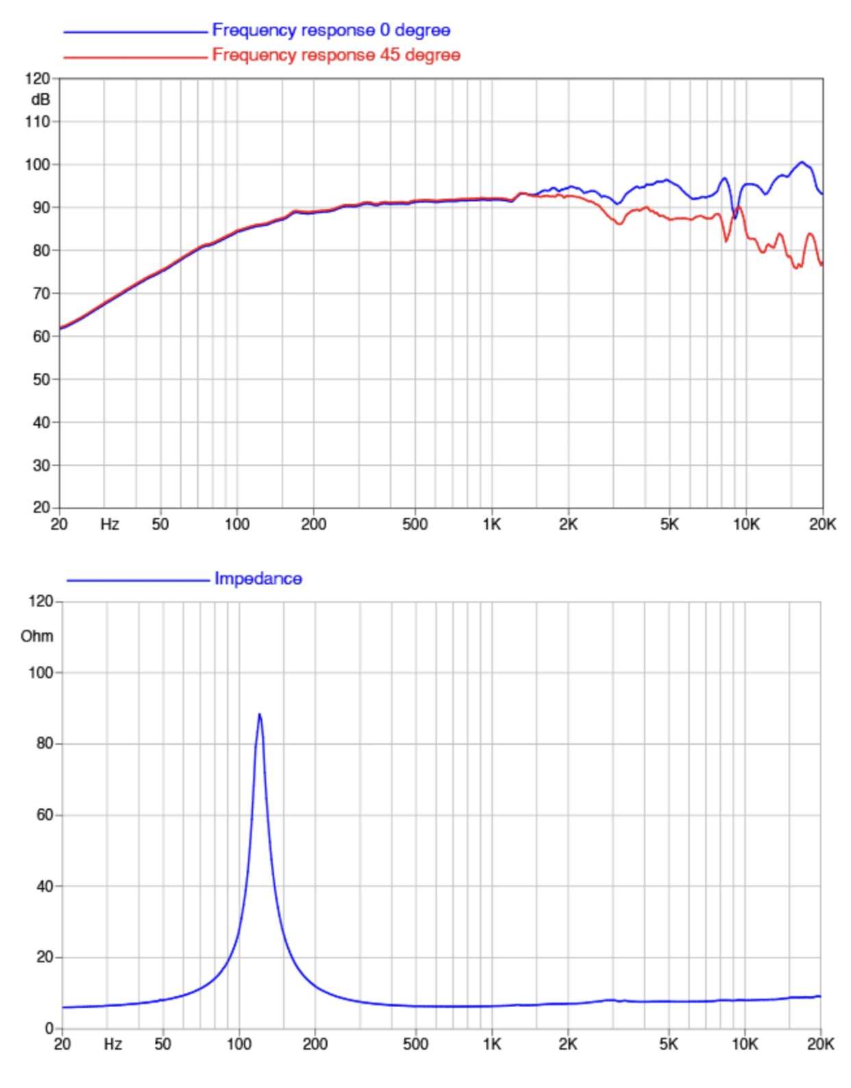

In reality I have plan and already drivers on stock for something similar but cheap trickish. Two greencone SB20FRPC30-8 fullrangers as bass units, small yellow Fostex FE126 for mid and don't know yet which tweet...that golden Audax would be maybe nice looking complement and we could even out everything to real 92 dBWm per speaker. Two of these would be thunderous in room...
Thinking about this a bit more... if the midrange is at 92.5 dB, the woofer will need to be up to 6 dB higher (98.5 dB/2.83V) to make up for the baffle step loss. Either you go (a lot) bigger than 8", use a very large box, or don't go low.
But it greatly depends where you cross over. Both the mid and bass units can share their part of baffle step loss.
