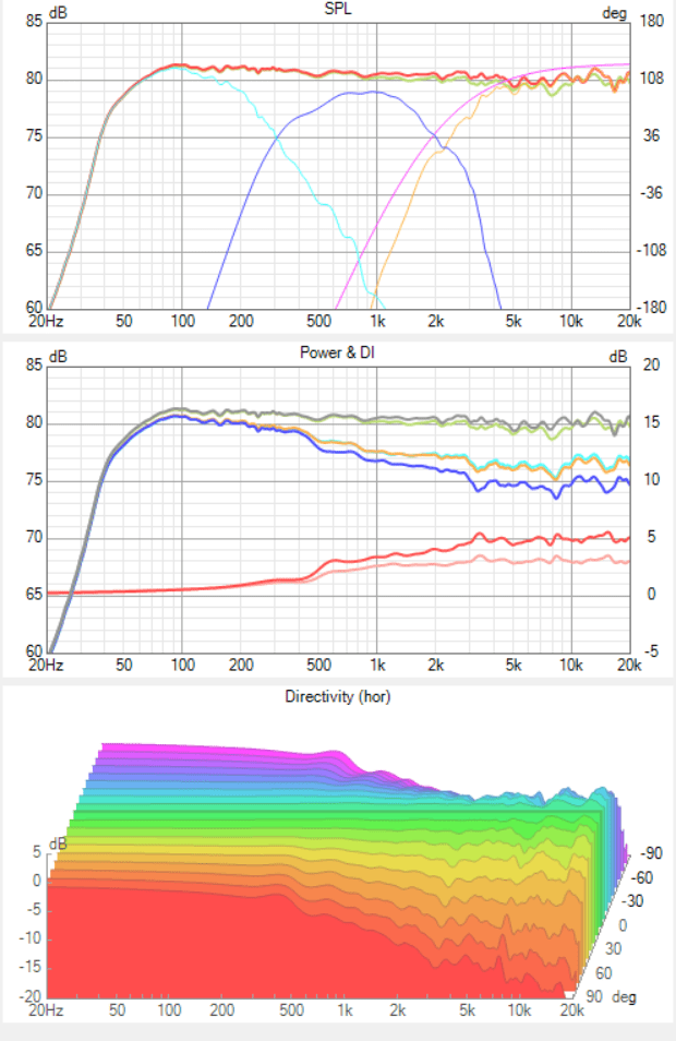

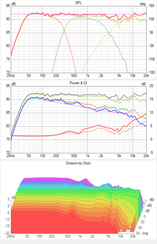

Thinking about this a bit more... if the midrange is at 92.5 dB, the woofer will need to be up to 6 dB higher (98.5 dB/2.83V) to make up for the baffle step loss. Either you go (a lot) bigger than 8", use a very large box, or don't go low.1960s/1970s type of speaker. Big baffle. I need some advice on the woofer. I'm pretty sure the midrange I'll be using is 92.5dB/2.83v, so I'm looking for a highish efficiency woofer. I'd like 8", but...
With a 10" on both channels, we didn't need any baffle step adjustment, but I think a lot of it depends on room size (smallish-average living room) and how well it's coupled to the floor boundary. A squat box sitting on the floor may have a warmer mid-bass than a stand-mount or skinny column.
I've found that in most cases a 3dB higher sensitivity woofer will keep up with the midrange, given it sits closer to the floor for a bit of boundary reinforcement. Of course its better to have a more sensitive LF driver, which can be tamed easier with more BSC within reason.Thinking about this a bit more... if the midrange is at 92.5 dB, the woofer will need to be up to 6 dB higher (98.5 dB/2.83V) to make up for the baffle step loss. Either you go (a lot) bigger than 8", use a very large box, or don't go low.
In the past, I've used the WWMT configuration, so I have 2 x LF drivers of equal efficiency of one midrange, which gave me plenty of leeway for BSC thanks to extra gain of 2 drivers. You also have the option of running the upper LF driver a little further up to compensate for extra gain in the lower mids, sort of like a 2.5 way setup would have.

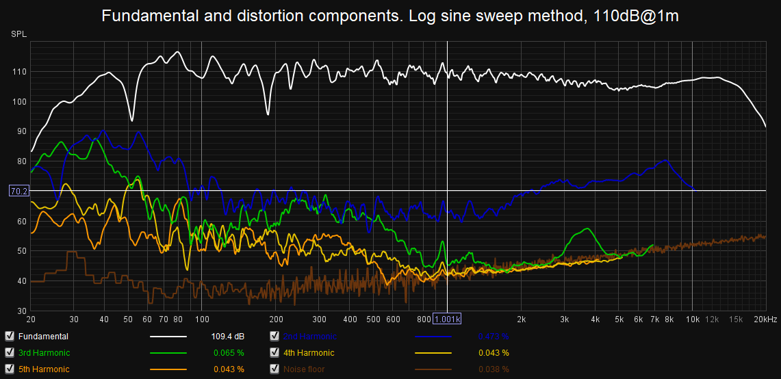

I built a large 4 way W-W-MB-M-T-MB for a friend with 2 x NE315W-08, 2x NE180W-08, 1x ScanSpeak D7608-9200 and 1x Morel CAT378. Woofers were each in 80 ltrs sealed sections and mids in 10 ltrs. Roughly recall running one LF section to 120 Hz 1st order branched off the other 300 Hz 2nd order to the upper LF. Midbass was cut at 850 Hz 2nd order on LP and HP. The Morel tweeter was crossed at 3400 Hz 2nd order elliptical, the same as the large SS dome to create a subtle BBC dip, which I prefer in most of my hifi purpose designs. I used a slight low shelf EQ on the LF to get bass extension down to 20 Hz -3dB. The enclosure was built in 2 sections to separate LF from the other section for the sake of easier handling, since this was a massive and heavy speaker. I built the crossover to be modular and capable of running from one channel or bi-amped.
This speaker had insane dynamic capability, specifically in the LF and midbass, yet sounded delicate and revealing all around. It would easily do 110+ dB peak and had 92 dB/W sensitivity. Specifically piano, vocals and acoustic music had a sense of realism, sounding like you were at the concert in the front row. Percusion had proper weight and size, which is hard to achieve on smaller designs. The texture, detail and authority in the LF and lower mids was better than anything I've heard with only exception to some horn loaded designs. The drivers blended so well together.
I unfortunately didn't find my notes on the crossover design, but I'll keep digging in hopes of wanting to build this design again for myself - it was that good. The crossover was huge, so it wasn't a simple design, but the outcome was well worth the effort. I really like large 4 way designs for the fact they can play every kind of music effortlessly. Sealed enclosure bass sounds so good. Once you hear it, you won't go back to sloppy ported box bass. Its also easier to integrate with the room. The best part is no sub needed.

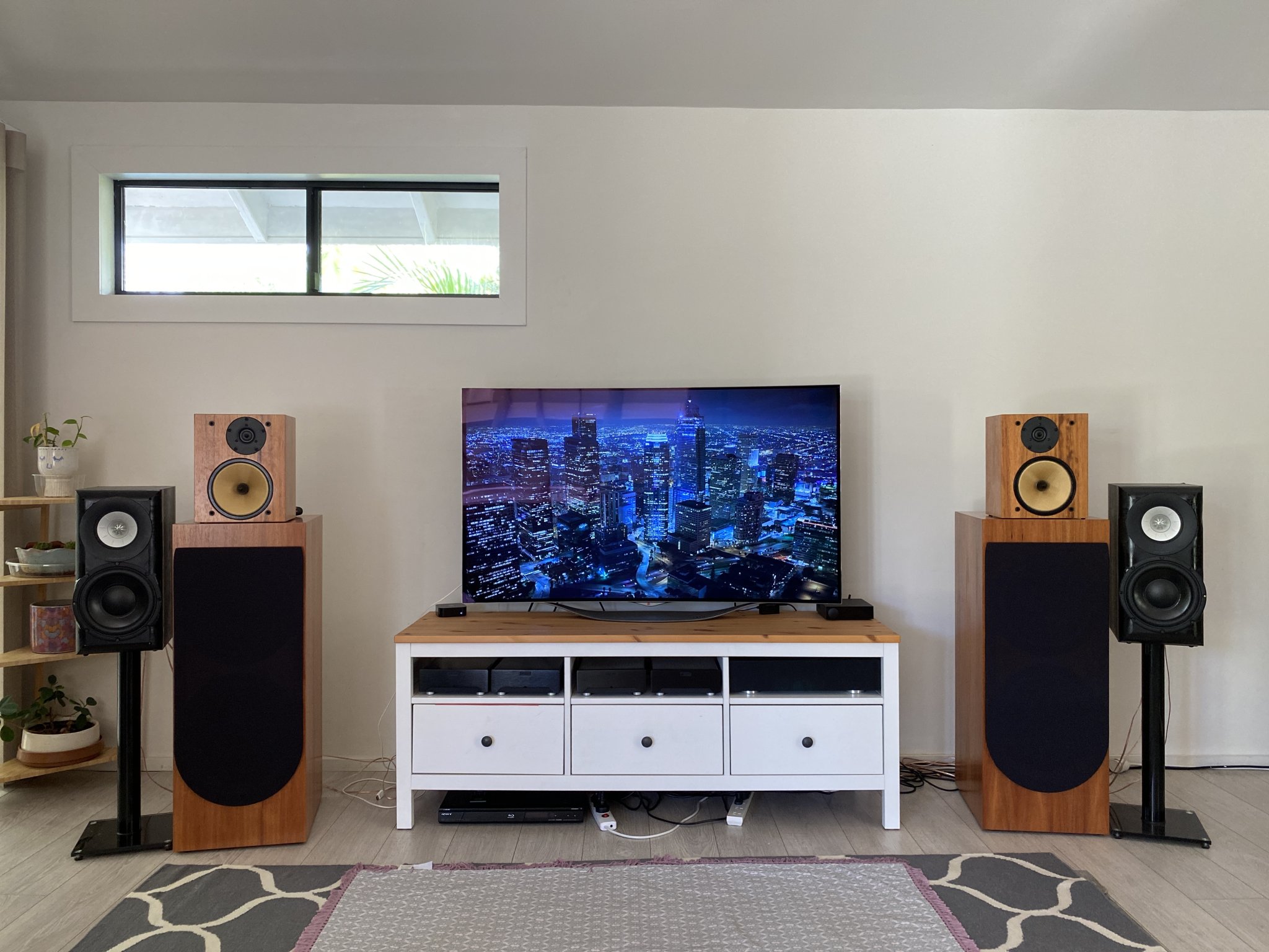

830845x2 in 100L; Gen2 Kevlar FST in 8L, XTBG60
Slightly less old school:
SLS8”, SP1753 -
The difference in dynamic range is clear.

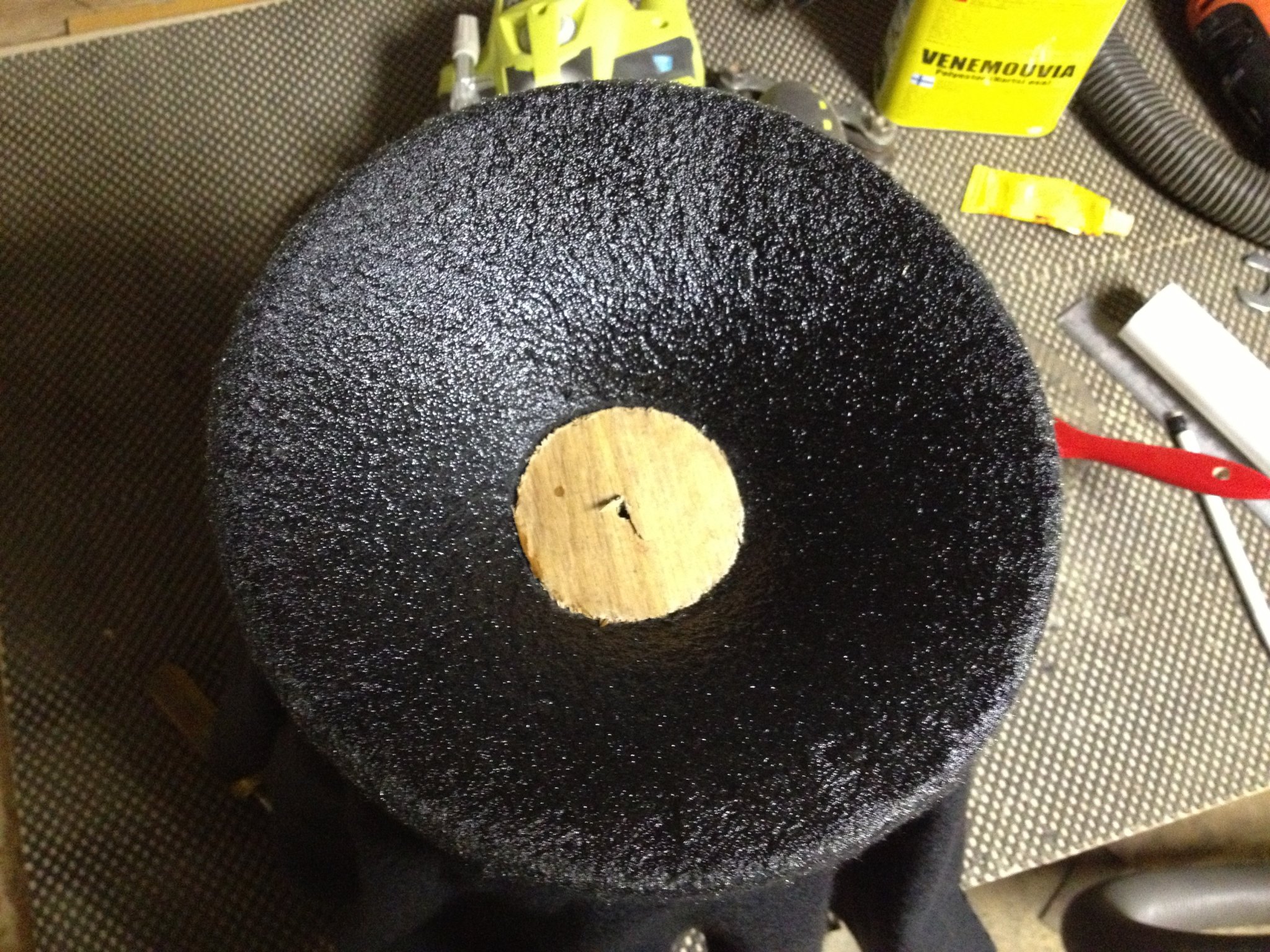

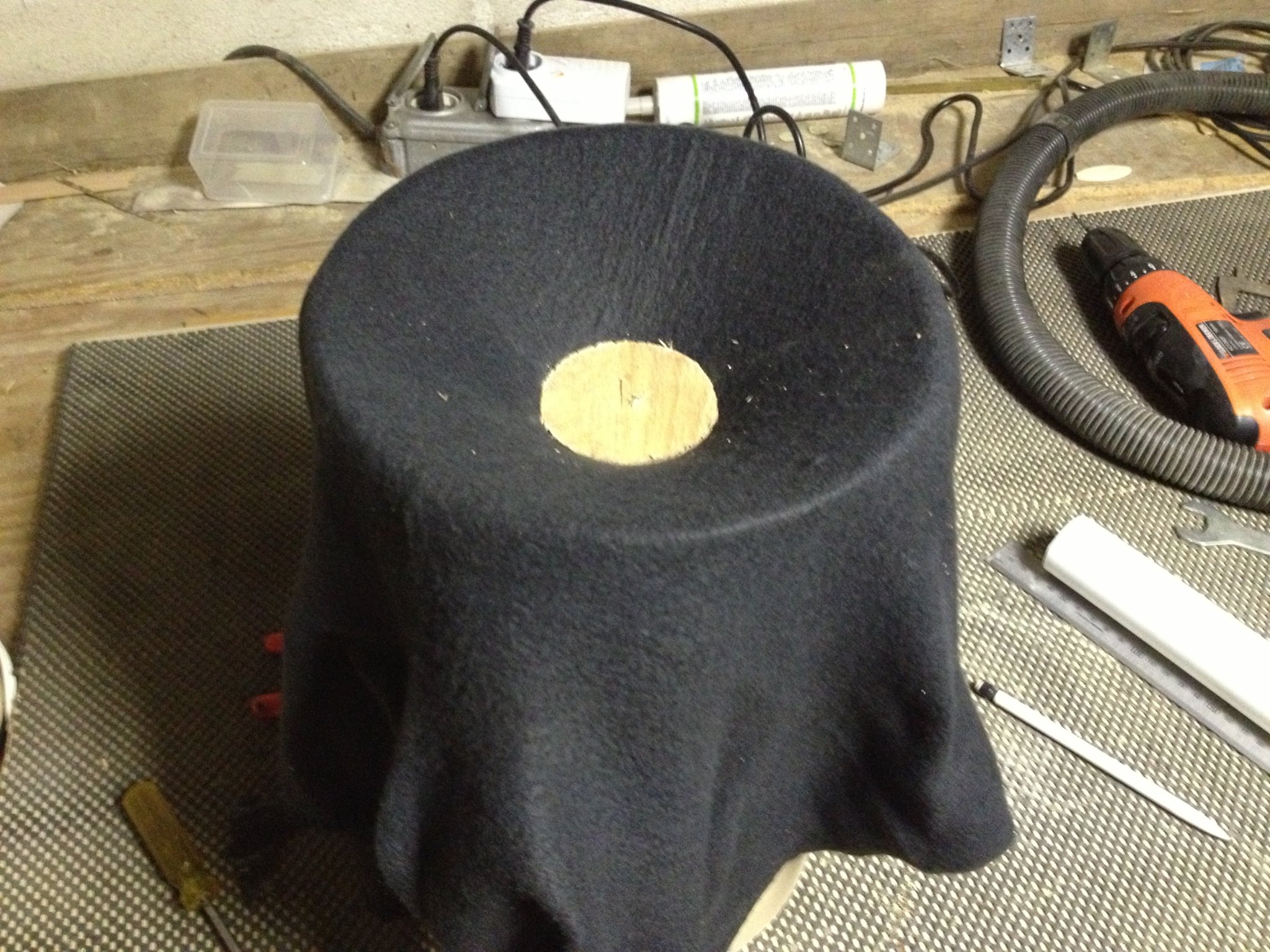

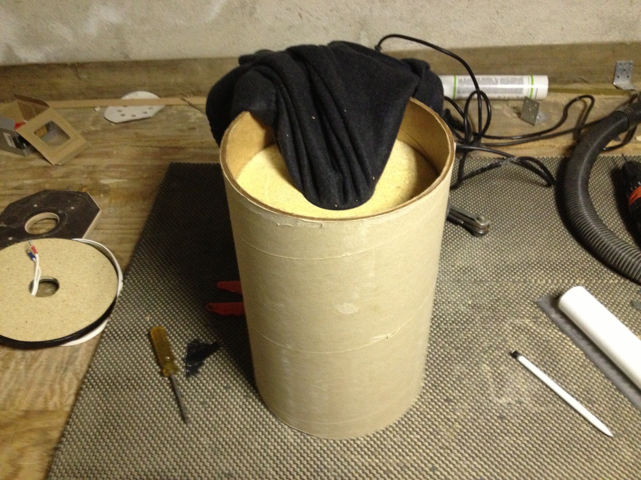

A quick little test I did for a 3fe25 many years ago was to use stretched fabric (fleece) and impregnate it with polyester. As soon as the plastic of your choice (polyester, epoxy, polyurethane) hardens you have a semi rigid horn/waveguide that holds the shape well and can be reinforced from the inside.
And it could quite easily be scaled up. To get your desired shape you simply need to make a frame and insert shelves or “guidelines” that the fabric touches as it being stretched down towards the throat. Between the places the fabric touches a boundary it will form a straight section.
