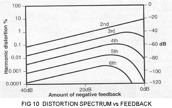

Actually, in some cases it does; Bob Cordell called it 'spectral growth'.
That is the reason that when you want to use NFB, use gobs of it. Doing 'just 6 dB' is about the worst you can do.
If you have Bob's book, the relevant figures are 24.3, 24.4 and 24.5.

NFB does increase higher order harmonics. Say you have a circuit that produces second order harmonic distortion, then by applying NFB you will eliminate* the second harmonic at the output, but now the circuit produces second harmonic distortion of 2nd order correction signal producing a 4th harmonic. Then you get a 2nd harmonic of the 4th harmonic correction signal producing an 8th harmonic and so forth and so forth.
*only if you have infinite open loop gain and therefore can apply infinite feedback. In practical circuits the open loop gain is finite so while you get a great reduction in the magnitude of distortion components, they will not be completely eliminated. Therefore a small amount of the original harmonic distortion will remain along with some small amounts of higher order components.
That said, with proper implementation NFB is better. A circuit with only local feedback producing a 2nd order harmonic at -30dB, 3rd order at -40dB and 5th order at -50dB is far more objectionable than a circuit with NFB which produces harmonics from 2nd to 30th at -120dB.
called it 'spectral growth'. That is the reason that when you want to use
NFB, use gobs of it. Doing 'just 6 dB' is about the worst you can do. If you
I don't quite agree. The Baxandall classic diagram, which Bob uses in 24.3
and is reproduced below starts out with the assumption that the distortion
without feedback is 10%, which I think we can agree is exaggerated. If the
distortion without feedback is reduced, then we see less of an effect,
certainly illustrated by figure 24.5 which is about 0.3% without feedback.
However it appears that 24.5 is a Class AB follower, in which case lots of
degenerative feedback is already in play.
Bob does go on to say about Baxandall's graphic, "...the audio community
read too much into it, wrongly generalizing the results..."
My view: The more linear the amplifier, the better feedback works, but
also the less need for it. Basically Bart Locanthi's point back in 1966.
