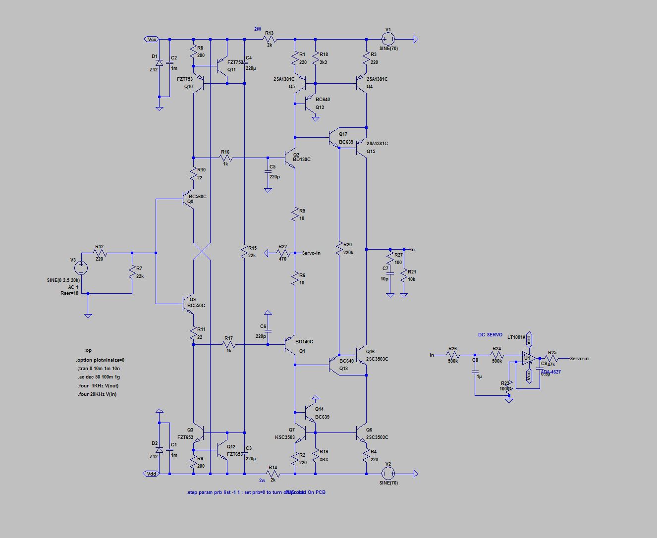

The YBA, is a leach light.. Nothing wrong with that concept.
I use my own adaption of that kind of design... If you look around the forum I have even posted a picture or two of my take on that circuit.
BUT I also made a stand alone OPS with a gain of one, this could work with some kind of NON feed back Voltage stage.
With this combination I think feedback is used where its really needed as a control interface to the speaker, but not used where it's not needed (to create voltage gain) in order to have good distortion performance
This IPS is almost a copy of the GainWire mk2 gain block.
