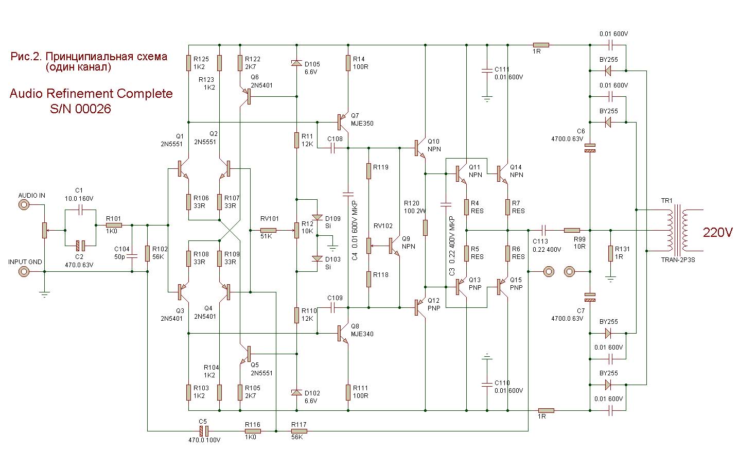

To add to your statement, here is the schematic of the YBA amp that got me into designing my amp. Just look at it and you'll be laughing. How can this amp sound good?!!! But that's the amp that change my point of view of the importance of the amp.
